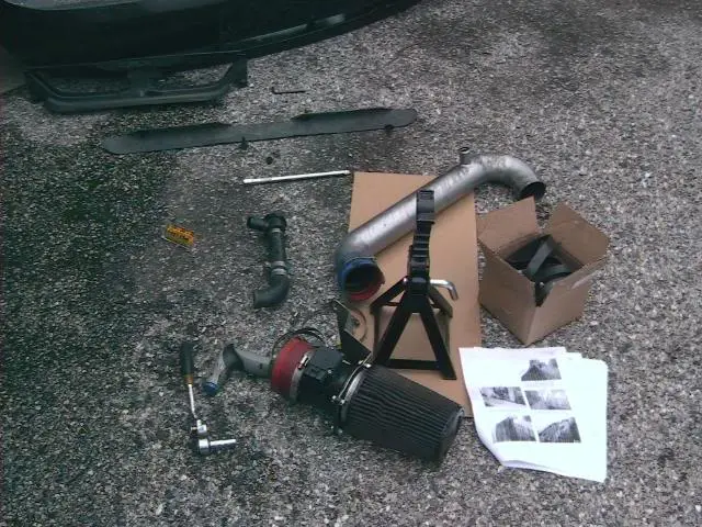

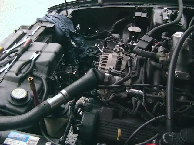

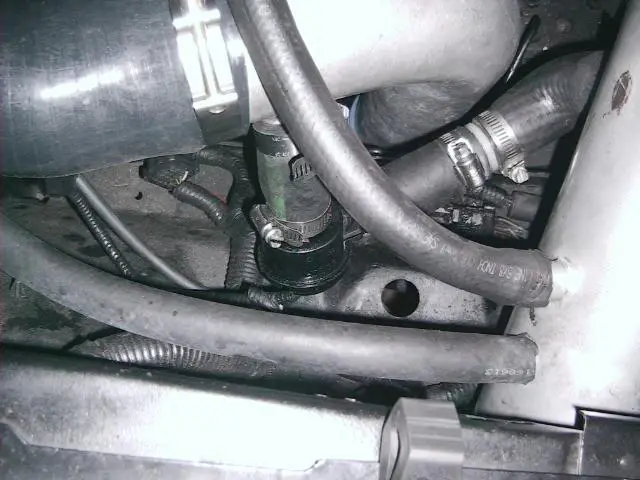

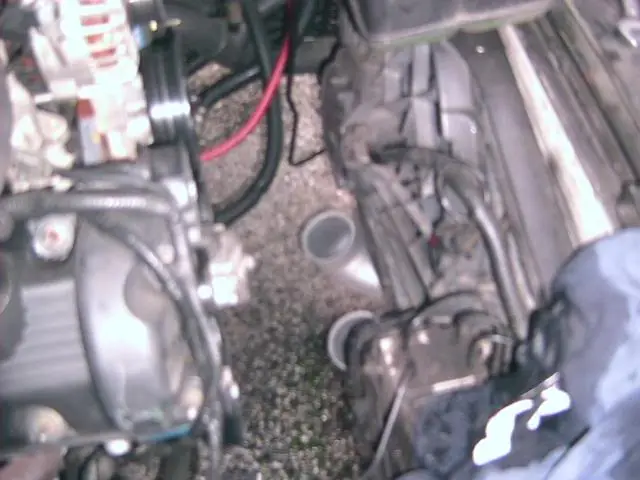

heres a few pictures

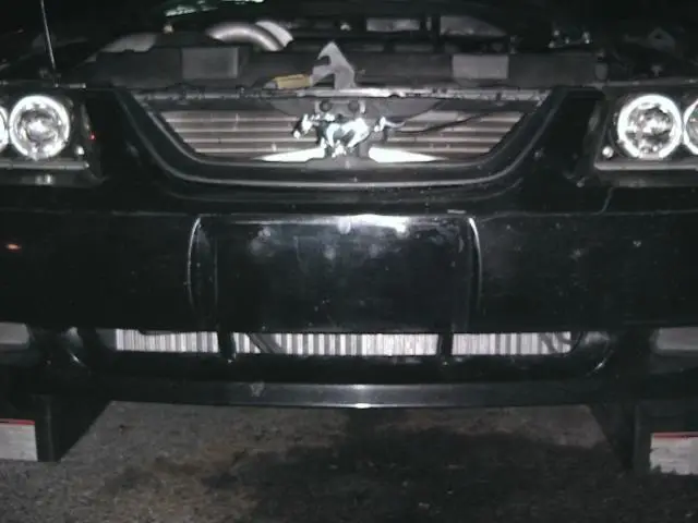

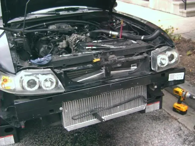

i removed the ebay intercooler and installed the paxton (mounted it anyways)
also my kit did not come with the 2 metal bracers need to connect the upper part of the intercooler so i will have to go to home depo and see of i can fine some brackets or i will just rig something up

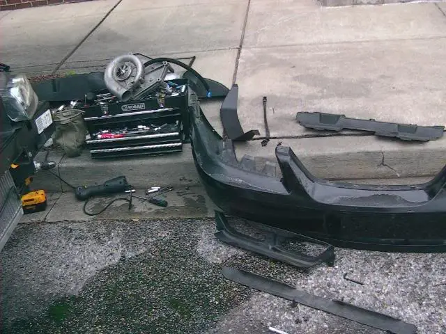

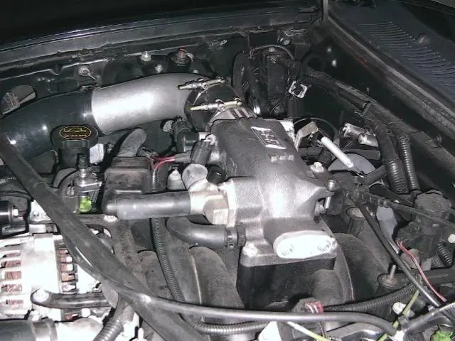

a few more pictures
then my luck shows my why i dont like going under the hood anymore Fck! View attachment 245373
i used pulley puller and the fcking crank pulley broke on me..now i have to find a way to get the remaining part off the crank without doing damage to the crankshaft

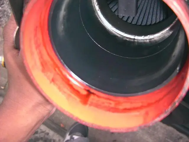

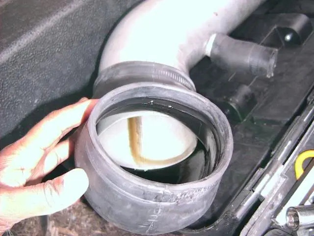

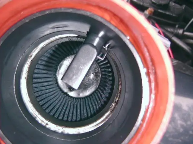

also i got oil in my intake the air filter is full of oil and dirt...i will install some kind of oil bypass its more then likely coming from one of the hoses that connects to the intake and not the charger..

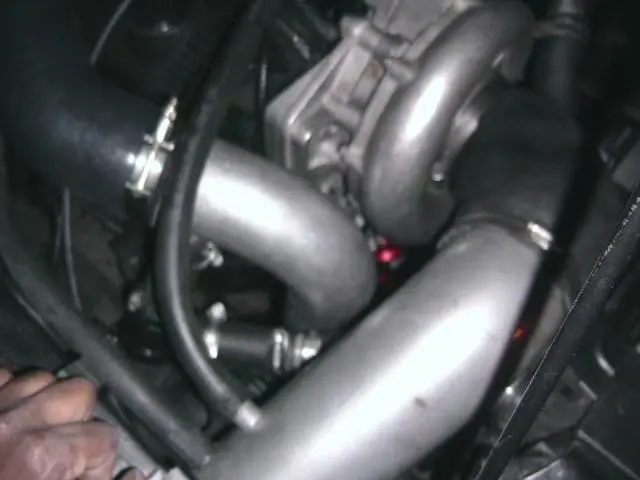

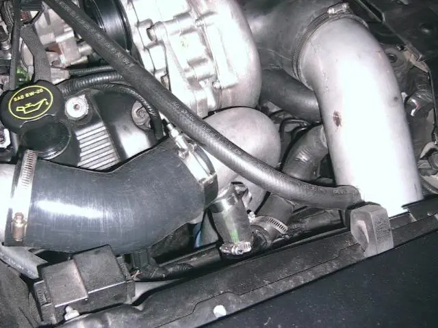

i ran the pipping best i could i will take a few pictures after work and post them let me know what you guys think..
i also need to get a large hose for the vortech mini-racer bpv

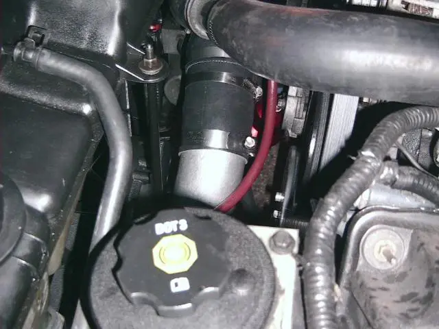

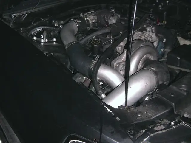

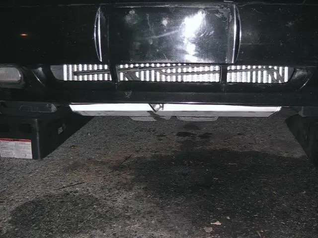

ok sorry got off work late anyway here are a few pictures
i am still using the stock bpv atm but i also installed the mini-race no vacuum line to it so it stays closed
the car is going to need a tune i gave it some gas just to see how it sounds i am getting a fluttering sound comming from the stock bpv sounds sweet but i think that just means i need to us the larger bpv ..
i am not to happy with the 3 x 90 deg bens i have in the pipping but it will have to do for now i did not want to open that hole were the intake is going rigth now so i will wait till i install the pro-m meter and get a tune to see how the boost looks i may just redo the tb to intercooler pipping less 90deg beens the better..
