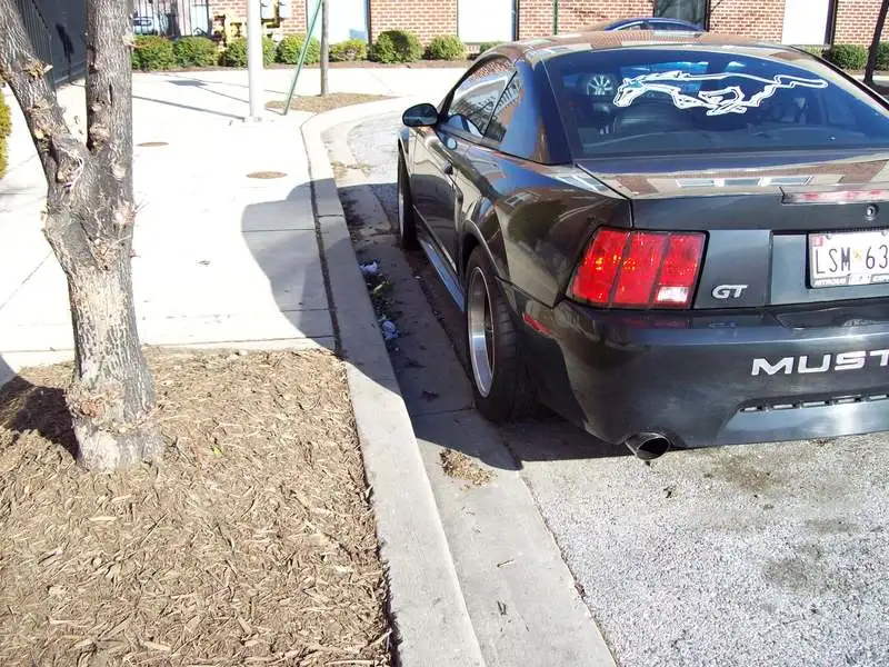

the car

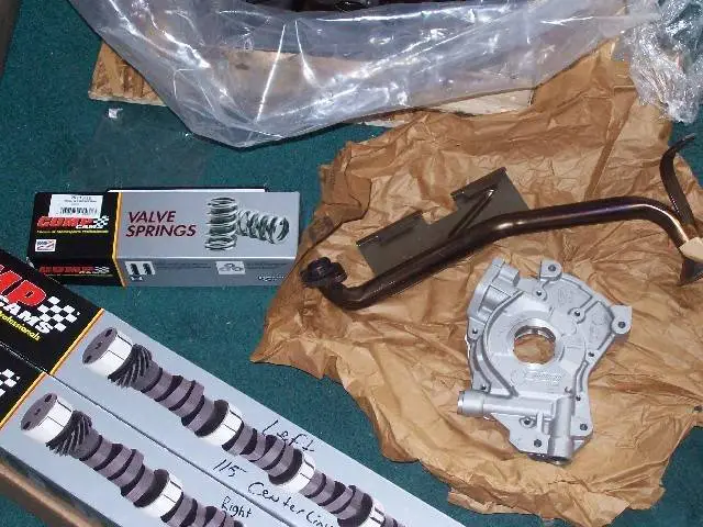

mmr oil pump

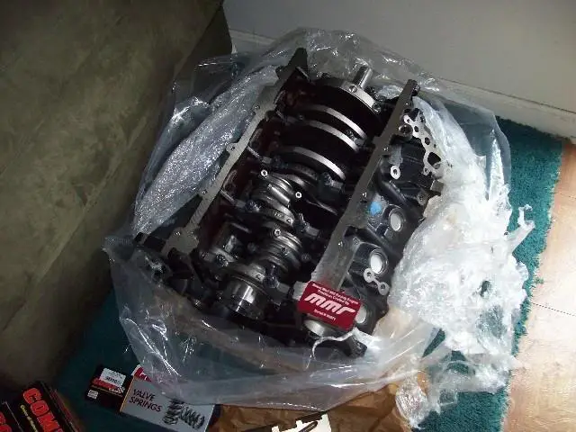

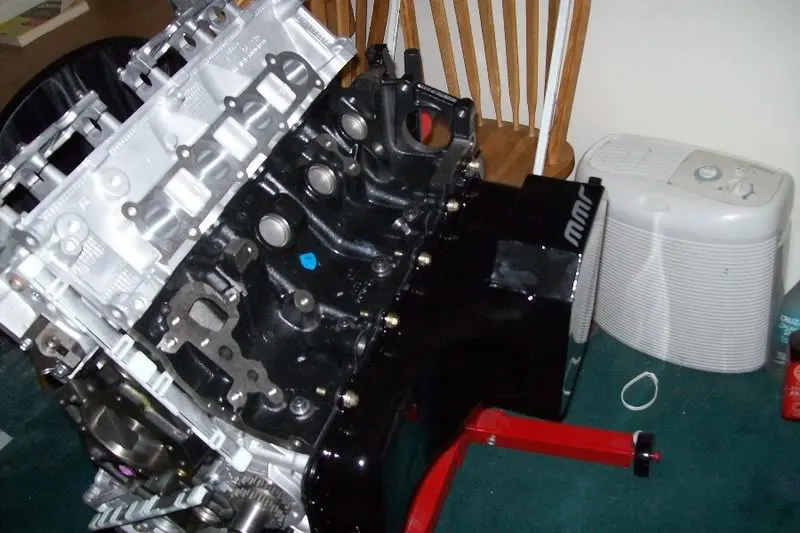

mmr900 shortblock with like every option but alum.

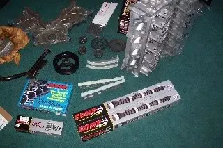

more parts like heads,cams,timing parts :

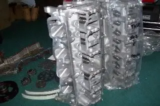

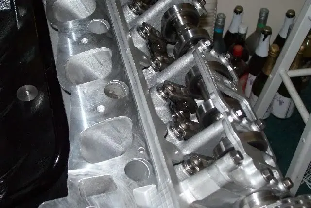

heads patriot stage 2 they dont look bad :

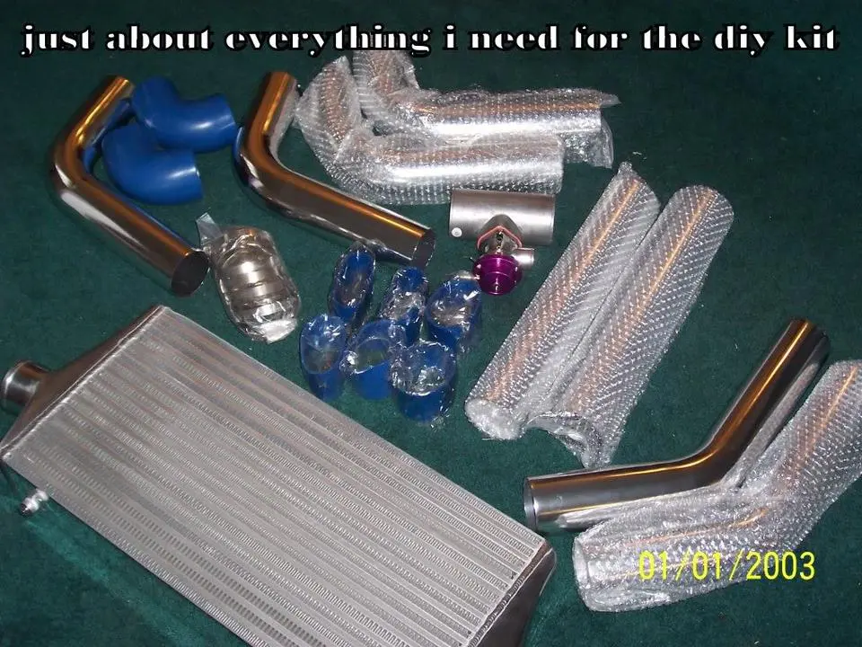

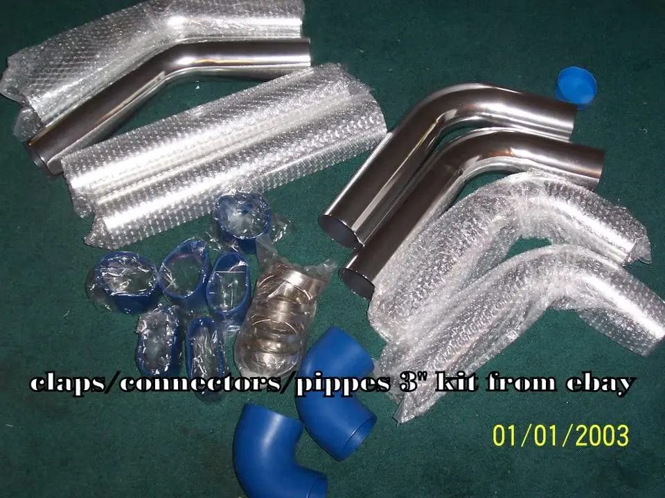

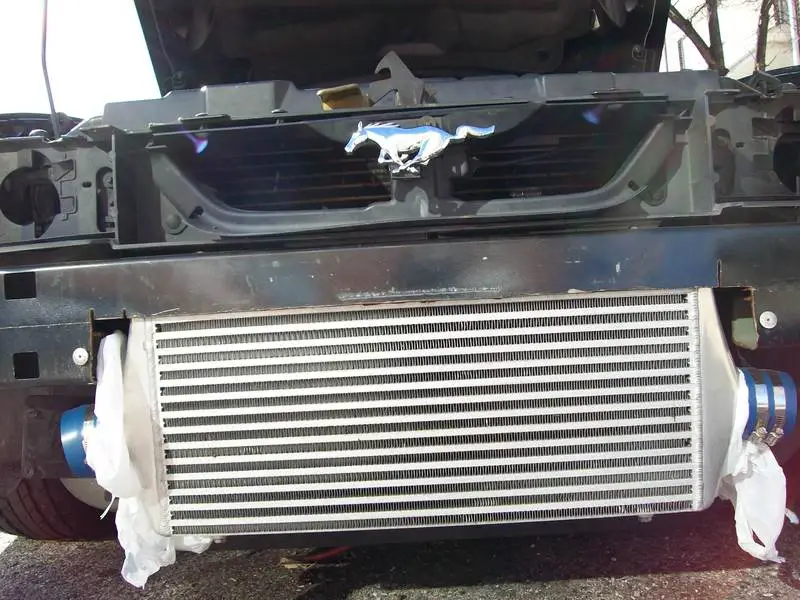

my diy ebay intercooler stuff :
not all of that is being used like the rubber things they suck :

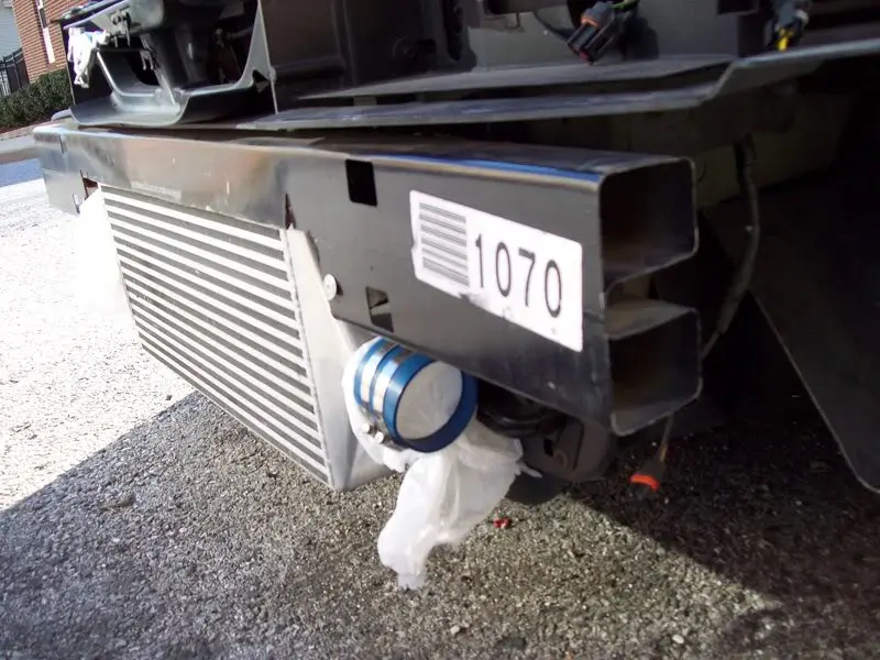

intercooler mounted fits good under the stock bumper :

mmr900 shortblock with all options but alum.
mmr900 oil pump

mph centrifugal blower camms (thxs tim.)
patriot stage2 heads using a (115lb seat and 238lb open valve spring spring max lift .600)
arp headblots,fel-pro gaskets
f1 alum. 12lb 8-bolt flywheel (needed this as i was using the 6-bolt alum. flywheel on the old motor)

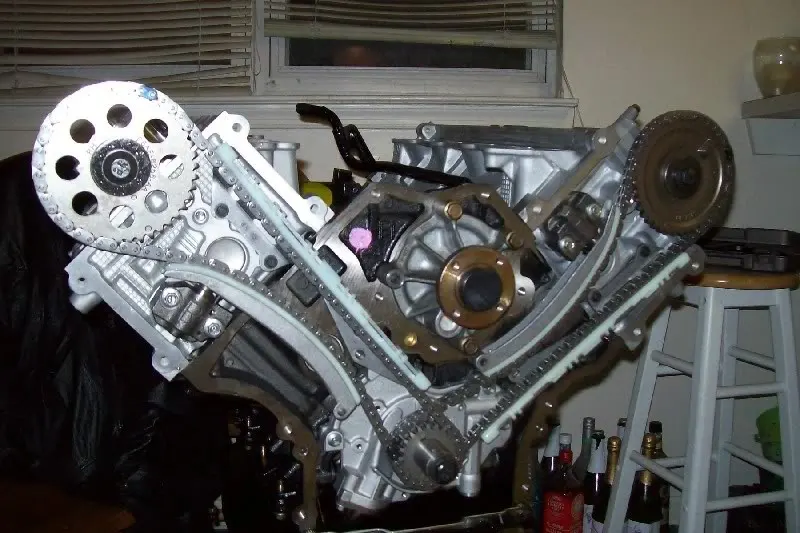

things extra i got are 4.6l sohc timing set (not needed just did not want to yous stuff off my old motor)
front timing cover and harmonic balancer i needed
i also got the 4.6l sohc timing kit ( this is used to set the timing on the 4.6l motor my not be need but cant hurt)

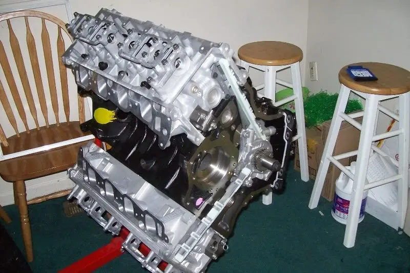

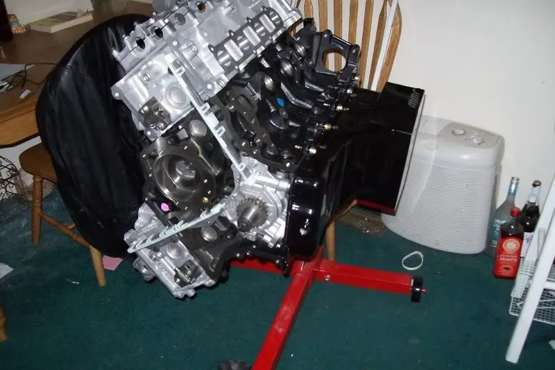

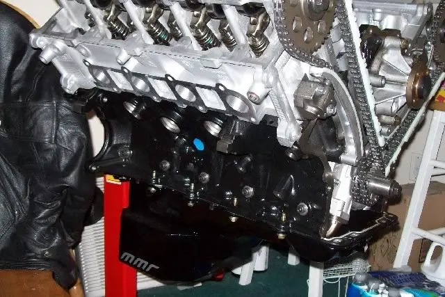

here are a few more pictures the build is coming along fine

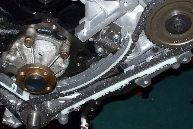

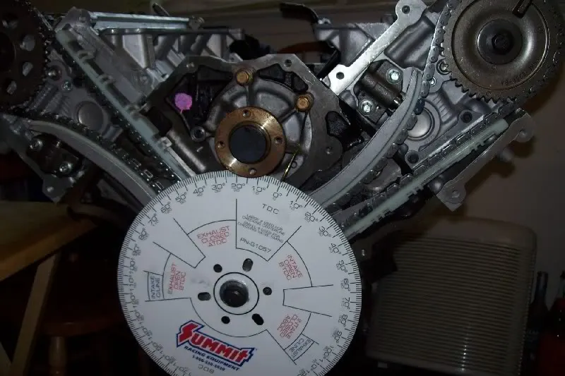

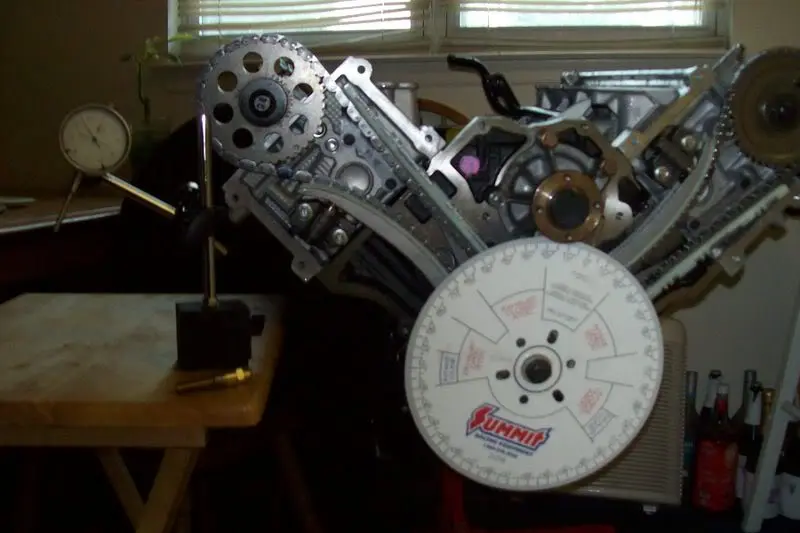

i just set the timing was not all that hard once i get every thing to line up then i did a 360 turn on the crank to check for valve to piston problems it turn with out incident so i am happy ....so far so good
i over torqued the water pump bolt and broke it off :(
never mind got it large wrench works for turning the crank counterclock wise

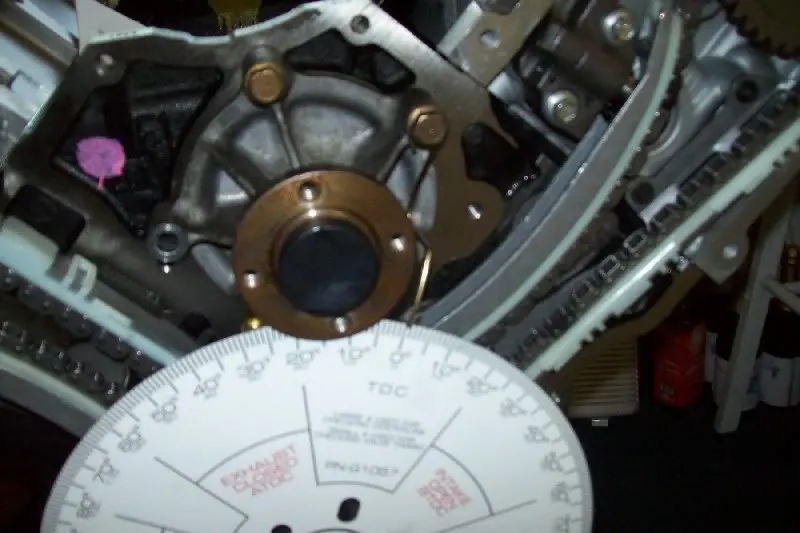

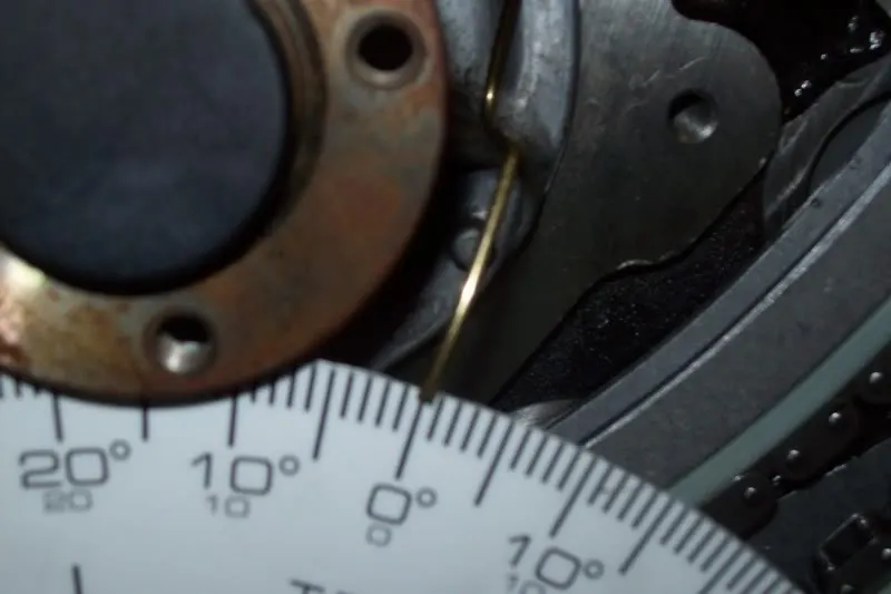

i think i got the cams degreed correct
got 151 degrees on one side and 74 degrees on the other side of the intake valve so thats (151+74)/2= 113 centerline and thats what the cams are set for

anyways the car is up and running theres a little noise coming from the timing cover maybe some poor oil flow to the timing tensioners ......

2000 mustang gt (73k on the car)

i am also removing the diy front mount intercooler i was going with and doing a vortech air to water intercooler
