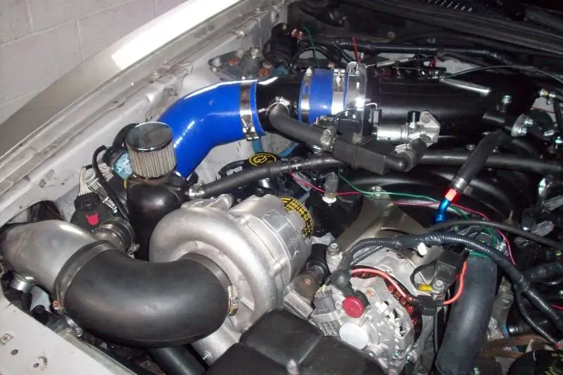

you got any pictures of the engine bay jives..
i will be honest i dont thing i degreed the cams rigth i tried and every thing seemed to like up... i used a degreeing kit from summit was not to hard but i was not sure it totally did it rigth

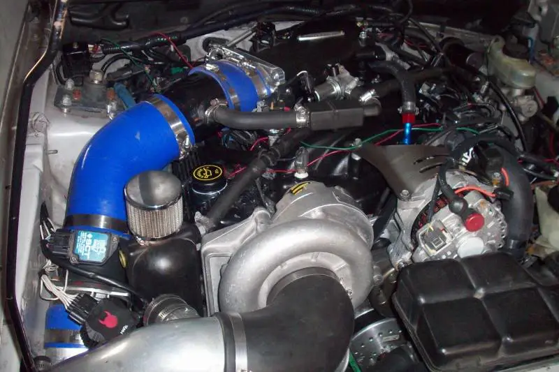

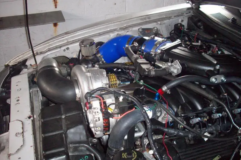

here's some pics. My cams only have a 531 lift.
