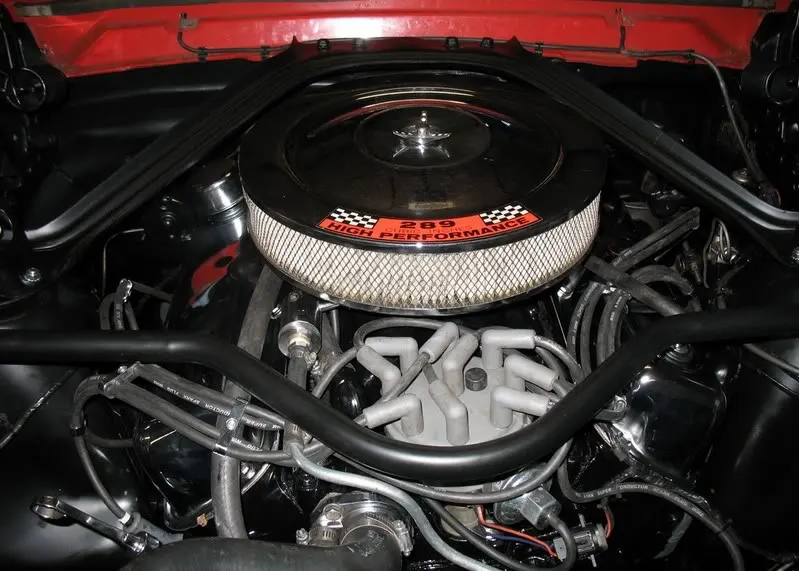

Use a front sump oil pan. It is your choice to go 302 or 351w. About the only main difficulty is that you need special swap headers. There are a few different suppliers of these, although none of them fit great in a 65/66 engine bay so some tinkering needs to be done. You will also need to screw with brackets which are different than the 289/302 and update the radiator.
Here is a pic of the 351 stroker in my 65:
