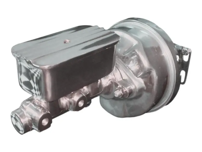

Hi mdjay. I would like to buy this booster if you're not going to use it:
I am having a problem with a '65 fb. I am installing a hydraulic throwout bearing from Dark Horse that was represented to be using a JMC master cylinder. I presently have a Trans Am Racing power disc brake conversion kit, and its booster interferes with the clutch master cylinder.
The Trans Am Racing kit uses a CNC carved billet aluminum spacer that mounts the four studs of a 7" booster, brand unknown. Four studs come out the back of the spacer and go through the pedal support bolt holes, to be secured with nuts from the interior. This setup lacks the bell crank assembly of your booster, so its centerline has to line up with the brake pedal's attachment point. This leaves the booster hanging down about a half inch too low, causing the interference with the clutch master cylinder.
If you think your bell crank bracket and booster will clear, and also be compatible with the Maier Racing one-piece underhood brace, then I want one.

I too run a Trans Am Racing booster. When I did my hyd TO bearing setup I was able to move the mounting location over by incorporating my pedal stop into my clutch pedal assembly.
http://www.2mfffabshop.com/rod.htm
gp001, thanks for the reply and the link. You've come up with a great solution. I'll be adding a pedal stop to my setup; I think I'll use a rubber axle snubber I have laying around.
