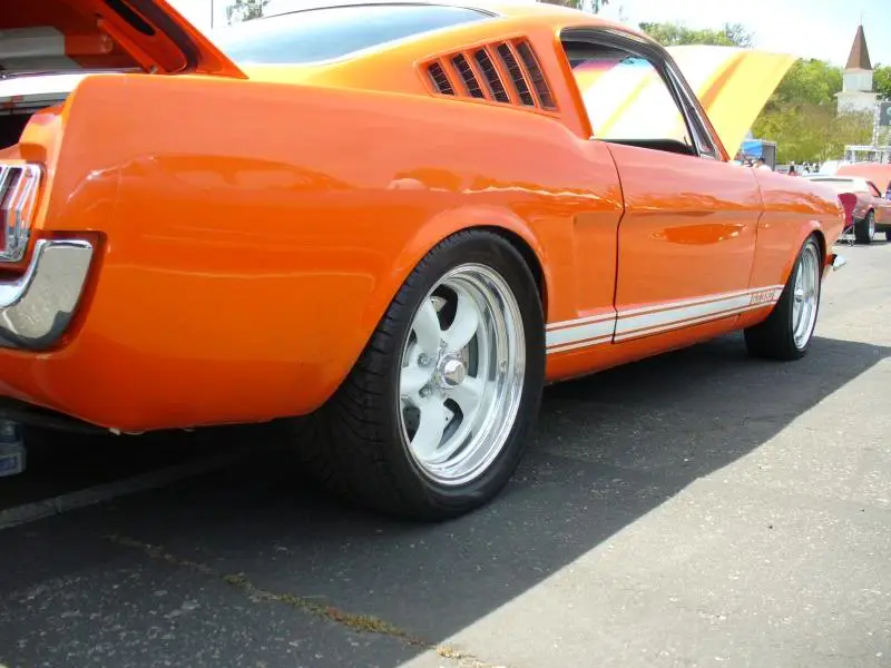

  • #16
horse sence said:
i think you would have a problem even with a 4 3/4 back space wheel
no it wouldnt be a problem. With a 4 3/4 BS, you can run up to a 275 tire. Anything less shouldnt touch at all.
this is how low my car sits and it RARELY rubs
