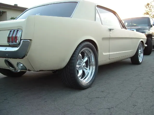

this is a coupe with a 1"lowered" leaf and KYB shocks. The wheel lip is not 2" above the tire. There is NO rubbing on this car. My car sits lower but my leafs are older. A majority of your rubbing is from the wrong offset/tire size if your leafs are new and stock height.
the problem is these cars were not designed for wide tires or tall tires ,so correct backspacing and tire width and modified wheel openings is about the only way to make them clear every thing. a rounded edged tire like the ones pictured above is a good start, they look like a great fit. iskwezm ,are the wheel lips roled ?
