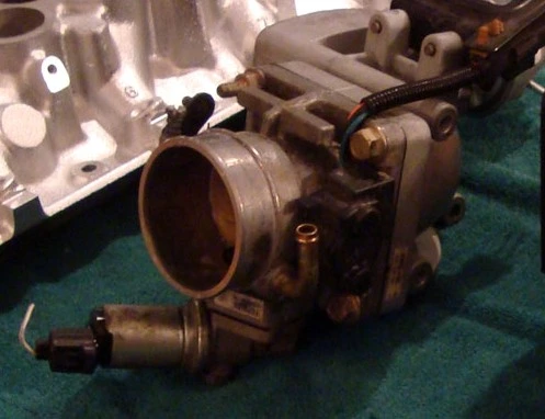

I recently acquired this TB and I have no idea how this will work on for my application. It looks totaly different in comparion to the 94-95 TB?
Am I missing something here, or will this throttle body work on Fox body stangs only?
Can someone give me some help??
If I can't use it, it will be going up for sale.......
Please help!

Wes... FWIW...
the Ex TB is different than a Fox..where the cable connects is reversed...you have to cut and relocate the ball to the other side to use it..Been there done that on my Fox swap.
this is a Ex TB...see where the ball is... needs to be on the other side to connect..it can be cut & rewelded...
