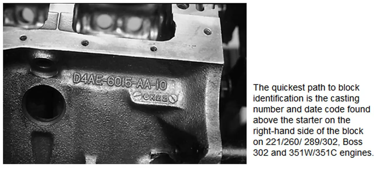

I would be curious to know what year the block is. There is a casting number behind (kinds sort of) the starter and can be found here:
First letter is code for which decade it was built so C=60's, D=70's, E=80's, F=90's and the number after it is for the the year in that decade. The two letters after that what type of vehicle it was to be installed. For example, F0AE would be F = 90's, 0 gives you the production year of 1990 and AE is full sized Ford so think Crown Vic, Continental, etc.

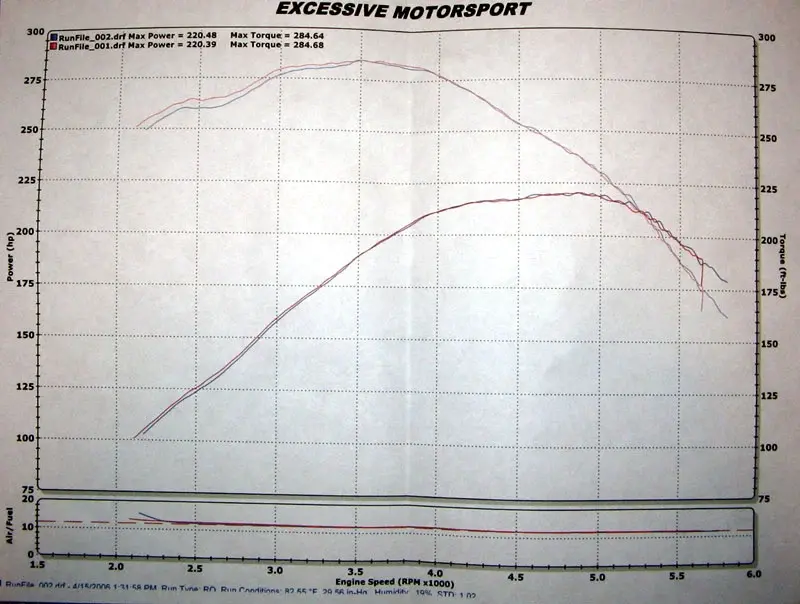

Just for reference, I stole this from the "Guess my HP" thread:
-Stock 302
-MAC O/R H Pipe
-Flowmaster 2 Chamber CatBack
-FRP Aluminum Driveshaft
-MSD Cap/Rotor
-Timing at 12*
-super dirty panel filter (not K&N)
-Stock 302
-MAC O/R H Pipe
-MSD Cap/Rotor
-Timing at 12*
That seems pretty strong, maybe even excessive (pun intended), for a stock 5.0 with just an H-pipe and catback.
It's not too out of line for a Dyno-Jet and I'm really most interested in the torque graph and less about the numbers. It was also the first one in the thread.
