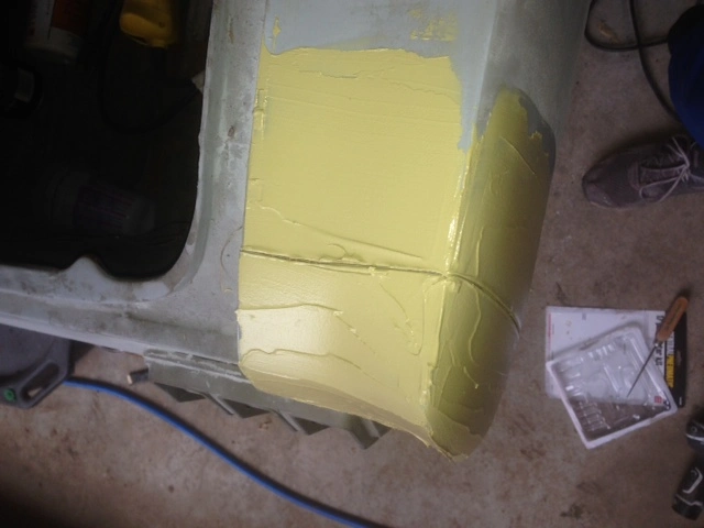

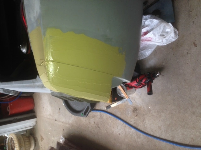

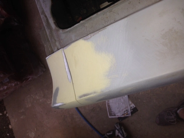

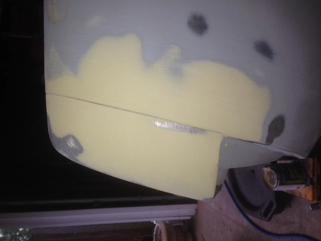

I used filler then block sanded the panel and extension. Carefully use a sharp knife to cut between the two. Once removed, lightly sand each side to radius the edges
I agree.. This is what i have done and is about the only thing you can do.

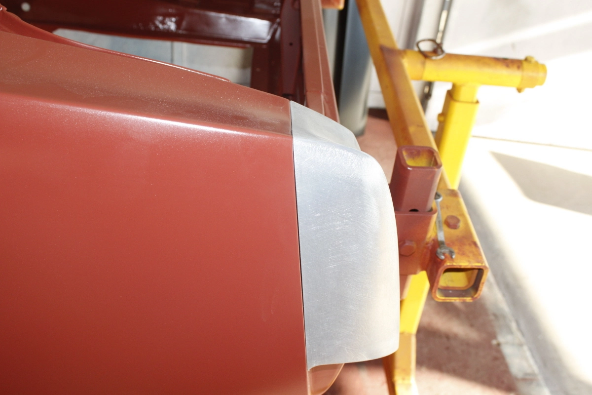

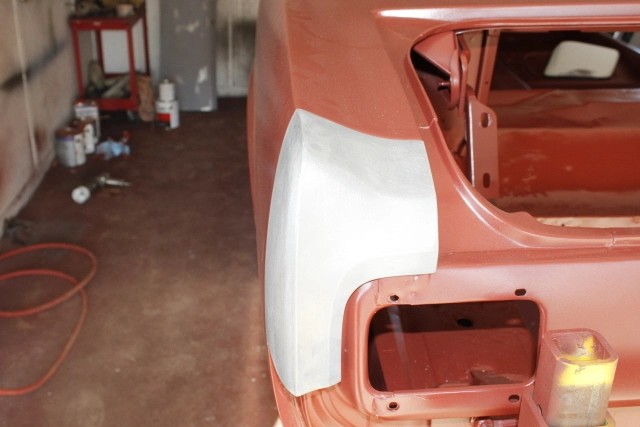

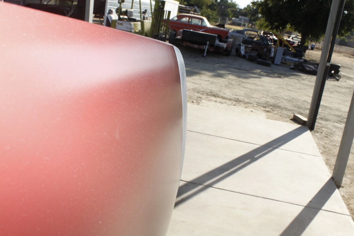

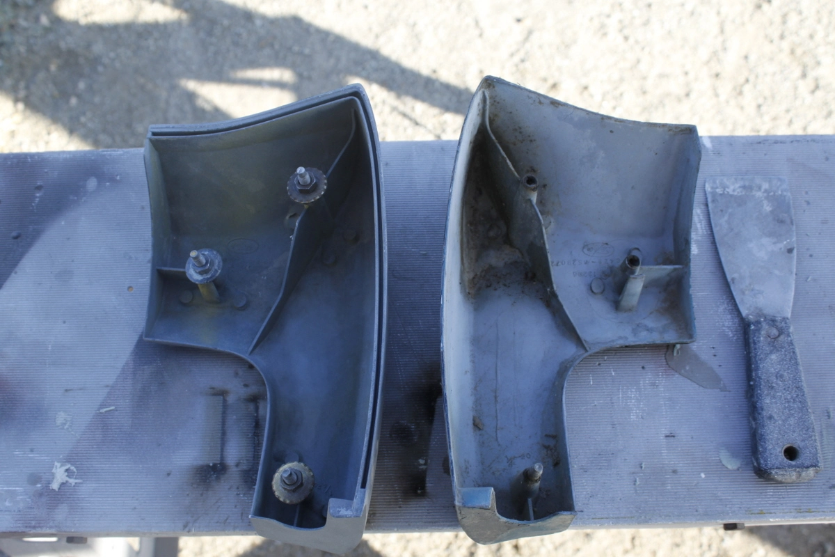

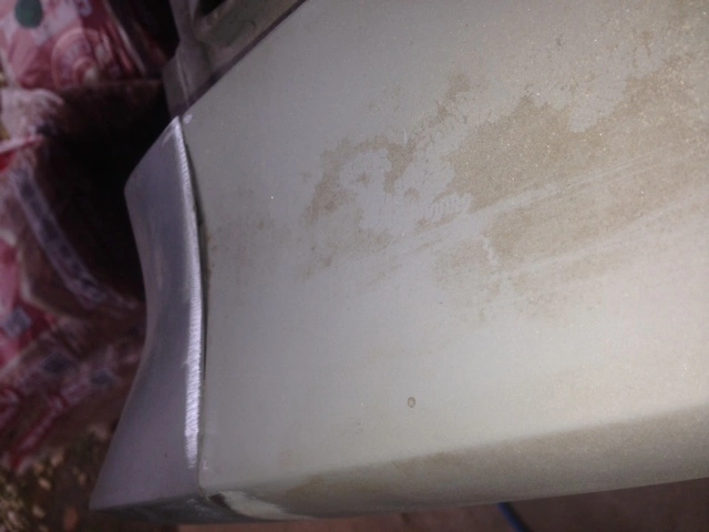

the 66 end caps are a little different than the 65 end caps .the outer edge is thicker on the 66 by quite a bit . the 64-65 is only a thin edge and twists and bows very easily. use the 66 when ever possible to find them. i have actually bent the 66 caps to make them fit better ,you can do it if you are careful. i have shaved the side of the 66 cap with a flapper sander wheel to fit them to the body if you do not have to remove to much material .this one is for my 66 FB. conversion.i sanded them to fit . there is no bondo on either the caps or the quarter just sanded to fit and you do not have to worry about them cracking later. 67 and up have the thicker edge so they can be sanded to fit ,make sure you fit the trunk lid at the same time
