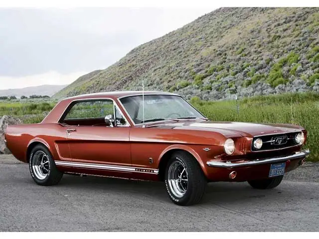

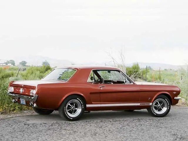

This is the look that I am trying to get....this is a perfect stance for me...I wish I knew who owned this car.

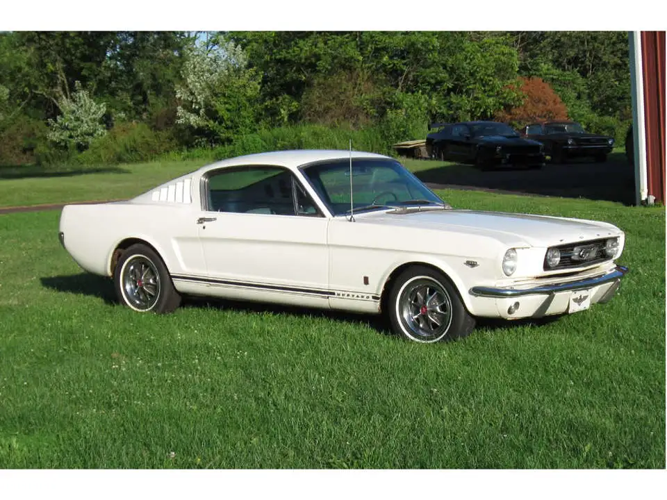

That G-N car is a little high in the back for me...I would want it perfectly level...i think that Emberglo car is either level or slightly lower in the back...what do you think?
That G-N does sit like 2+2GT's car...it sits just like a GT-350...it looks great on a 2+2...very sporty...but I would rather keep a coupe level.
