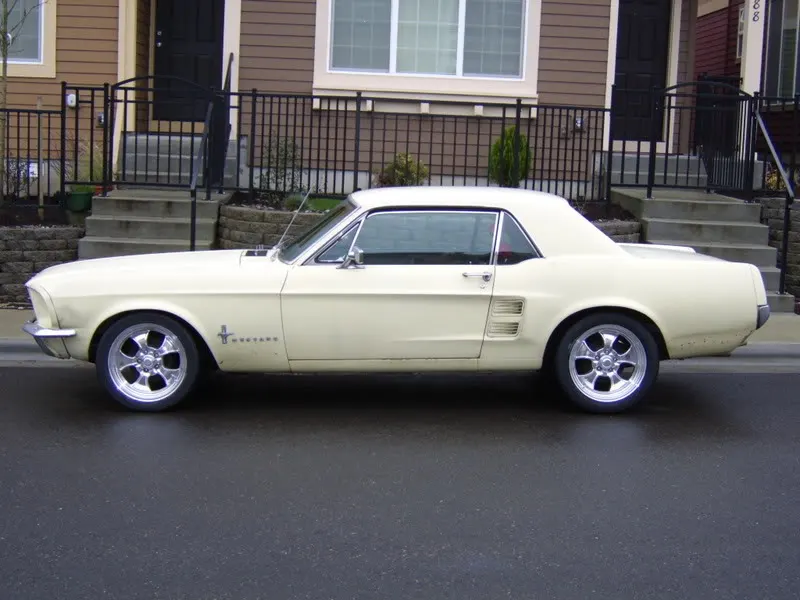

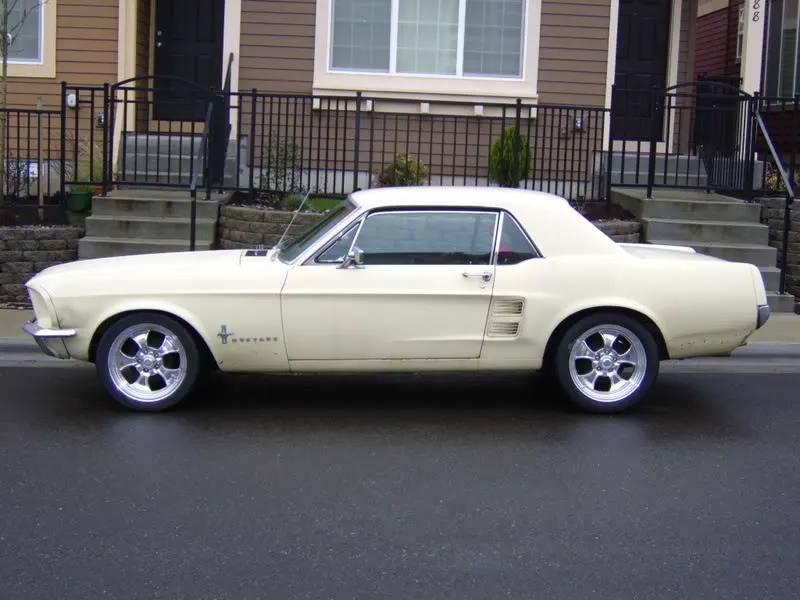

620lb lowering springs and shelby drop in front
5 leaf HD leafs in back, no lowering...
17" AR Hopsters

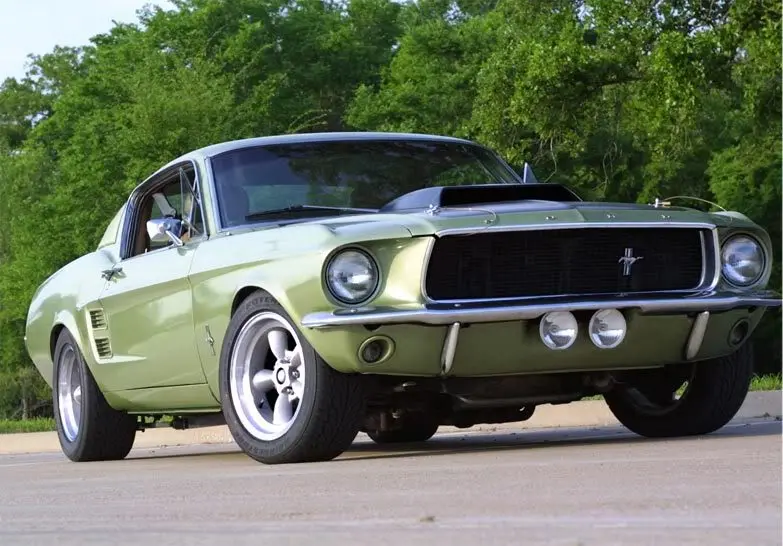

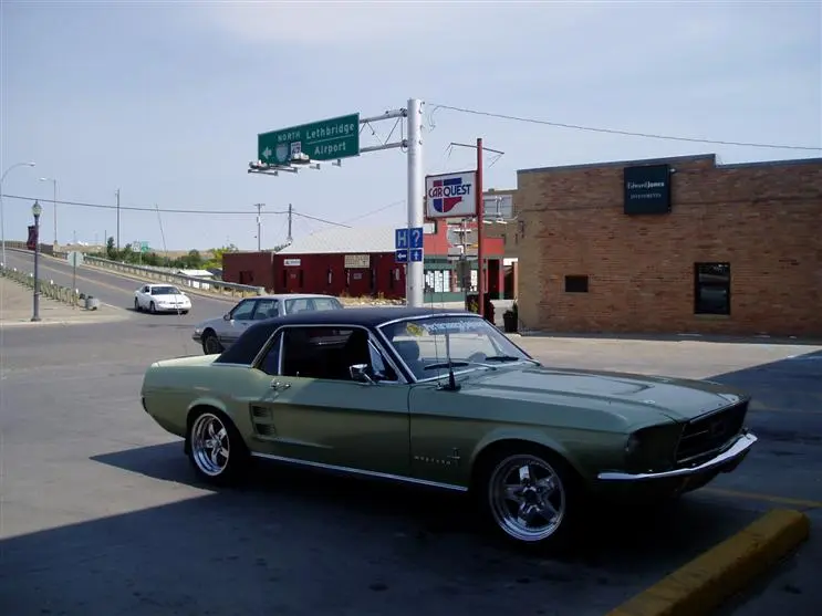

Vintage Wheel Works V45s, 16x8 w/ 245/50/16s (rear) and 225/50/16s front.
Rear - 4 1/2 leaf Magnas
Front - Shelby Drop w/ 620lb 1" drop spring.

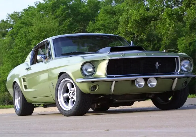

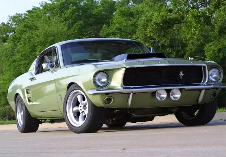

Not the thread subject...but what type of driving lights do you have and did you use the old license plate bolt holes to mount them? Thats the look I would like for my 65 coupe.

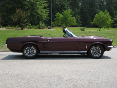

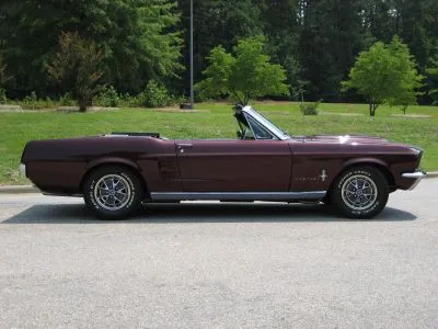

Mustang's plus kit. frt and rr. have had it for about 10+ years. 620 lb coils, Edel IAS shocks all around, 4 1/2 rear leafs w/ mid eye. Open tracks' roller perches. sub frame mounts.

I cut a piece of aluminum plate, painted it black and bolted it to the front license plate holes. As for the lights, they're JC Whitney generic 5" lights if I remember correctly, don't remember the size since I installed them like 7 yrs ago...
Decurion - fronts are 8s. They rub slightly on the fenders on big bumps if the steering wheel is turned (like turning into a steep driveway), but that's mostly been cured with rolling the fender lips slightly. Backspace is 4.5" on the wheels if you were wondering.

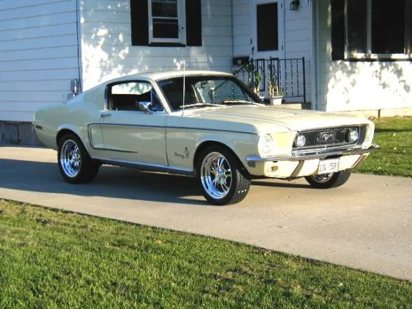

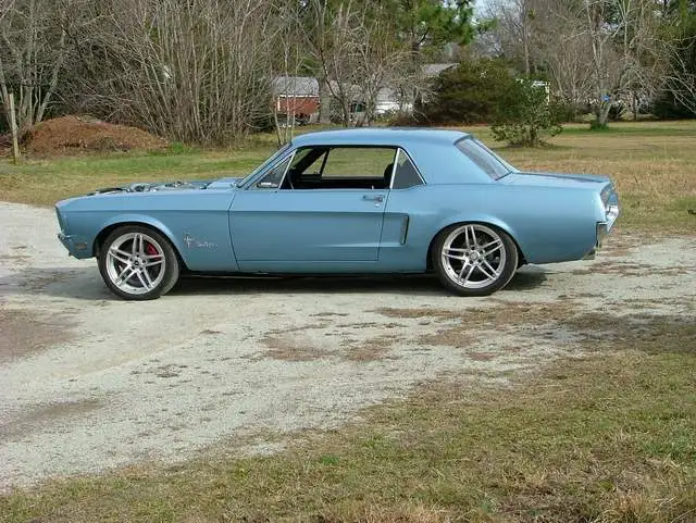

Here's mine. Grab-a-Track 1" lowering springs and shelby drop with 225-17's in front, and standard 4 leaf springs & 255-17's in back.

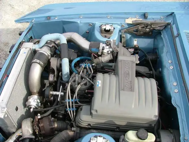

Nice work, similar to the project that i am currently working but with a single t7.
how thick are the spacers, and are the rims for a late model stang.
Oh ya ya how much did you pay for the spacsers.
thanx
Sorry trying not to steal the thread:nice: :SNSign:
