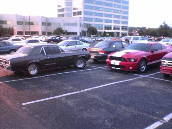

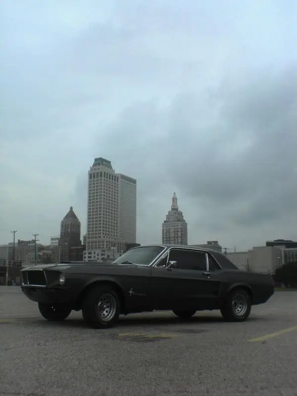

Yes he did do an alignment. Here are a few pics of the stang and its unusually high front ride height.

He did say that after he did the shelby mod and relocated the control arm mounting point that his springs seemed loose when on the jack with the wheels hanging. On another note you may notice in the pictrues is that the back wheels are tucked inside the quarter panel quite a bit. He said that the rear does not measure out to a v8 mustangs rear width. He said it measured 49 and something inches. He did not do the V8 conversion himself and he was thinking that they may have used the suspension out of a falcon or something. So if they did then maybe thats the reason nothing seems to look right.
From those photos I wonder if its actually the rear that low, and the front is closer to stock ride height.
Either way, if the rear end is where you want to I'd start cutting the coil spring.
I've taken a full coil out of my coil springs to get my desired stance.
