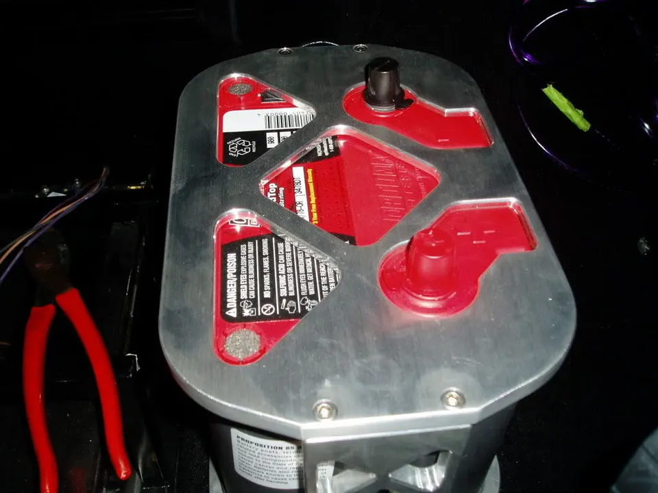

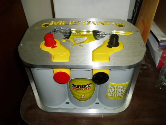

I bought the Optima Battery and put it in the brackets.
My dilemma is.. should I mount it with the side mount cables hidden (to the passenger side) or have them visible from the inside?
How about facing rear and closer to the back so they are not that visible?
Here is how I have seen one mounted, but it is not the Mustang Billet box!

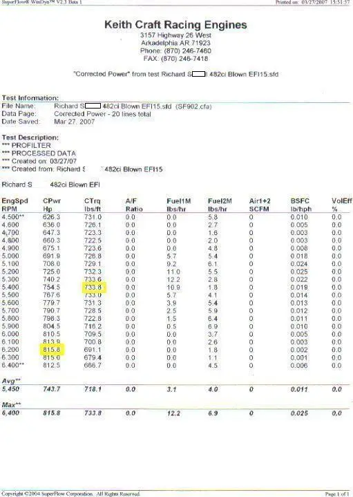

Engine Dyno Results
Here is the official dyno results. It is set at 10 lbs boost, and 38 degrees timing. The EFI is pulling out 1 degree of timing for every pound of boost. That will kill some horsepower, but I could add a switch and have a second tuning table for a higher octane gas. That is for when I REALLY need some get up and go!
You guys think I need NOS?

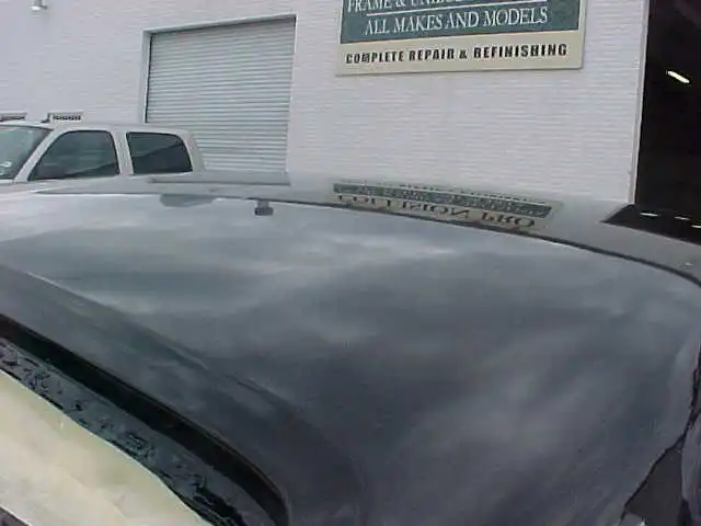

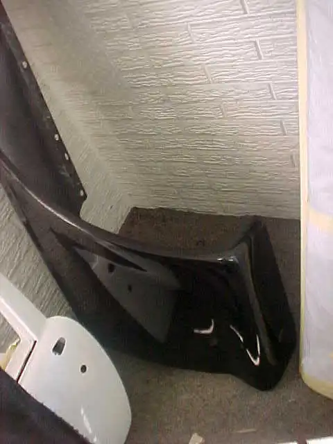

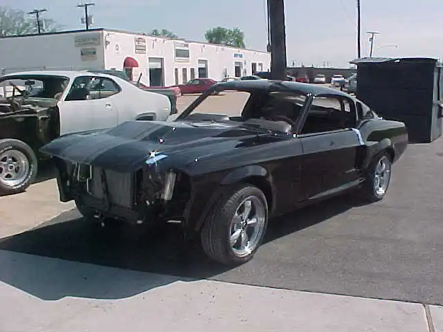

Paint

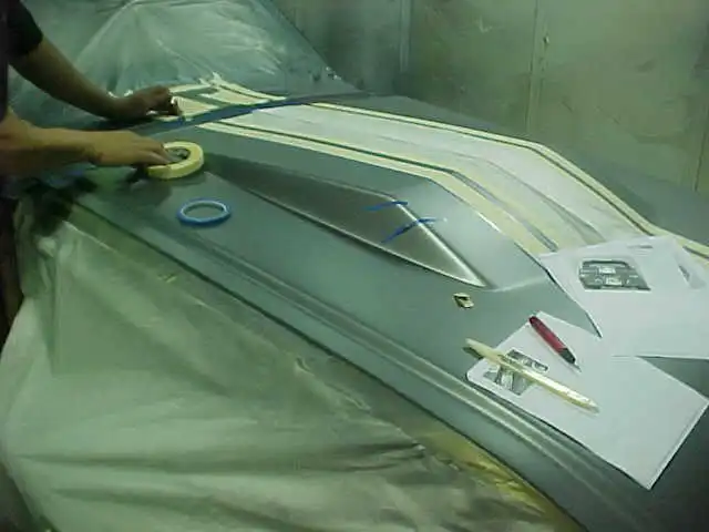

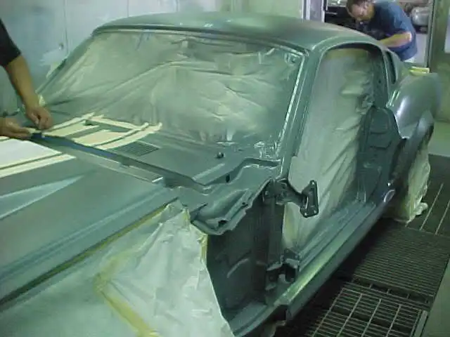

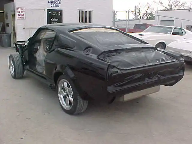

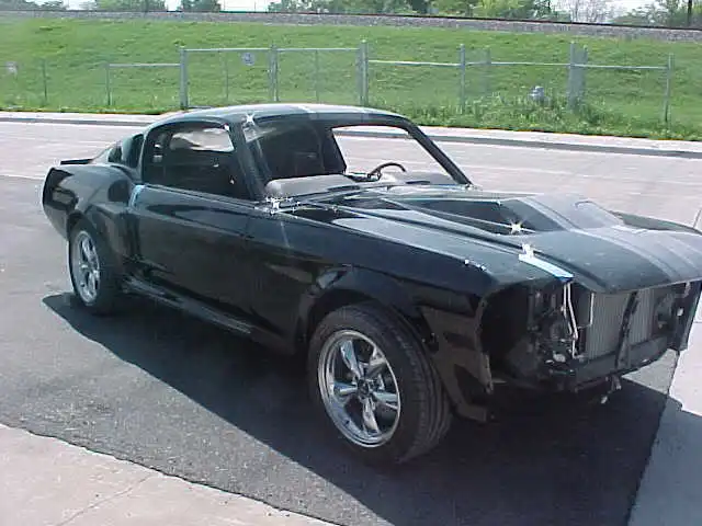

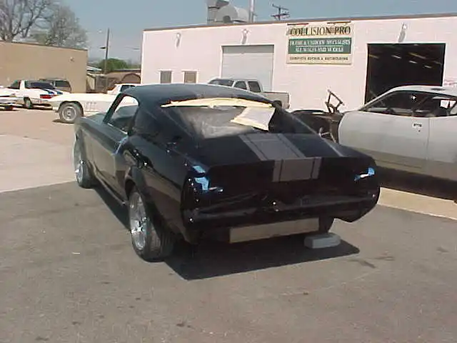

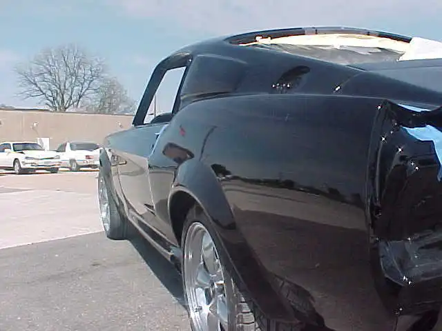

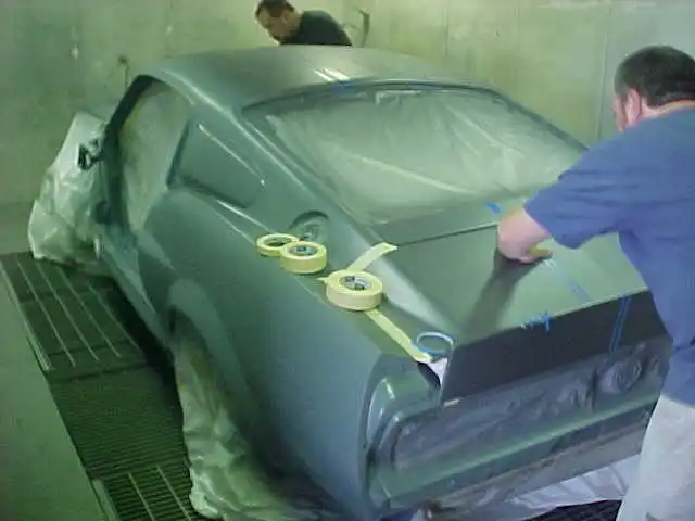

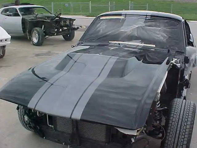

Paint is going on the car!
Doors & front fenders have been painted
And the stripes have all been laid out. Tungsten Silver (new Ford GT color) stripe on Black, with a gold 1/16" pinstripe.

Love that color combo. Nice of you to post photos. I was looking at the wiring on the row of circut breakers. Looks like 12 or 14 in series to each with the feed being the same. I would recommend maybe a 8 at least to feed these if its only a couple feet from the sorce and a flat copper bus with holes drilled for each stud to connect the breakers. If all circuits load, your feed wire may fail. Not trying to be a "Know it all" but I'd hate to see a beautiful car damaged. Just trying to help.
I have been thinking about that. I came across a 7 gang box that uses a flat strip. I might change this setup.
