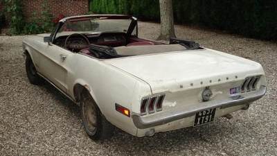

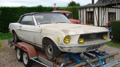

ok here is pics and his VIN
he is very please from your interest in his car , but he can't answer , he doesn't speak english very well ..... you can see that my english is from being perfect too

there's a lot of DSO 90 mustang here , mine is a 69 GT sportroof , those car have very interesting history.
for informations this 68 convertible , come right out of a barn , he didn't run since 30 years , of course he buy it from the original owner, interesting no?
i always love when car comes from barn from a long sleep , i dream to found such a car

Just curious, what does the round yellow sticker on the front quarter panel say?
bullitt77
Sep 15, 2003
43
france
Sep 11, 2007
#14
  • Sep 11, 2007
  • #14
i can't says , i ask him, wait
bullitt77
Sep 15, 2003
43
france
Sep 11, 2007
#15
  • Sep 11, 2007
  • #15
it's a soccer team sticker !!
