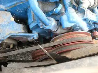

alright here are a few pics i took them before i checked the boards and am going to take some more and post those as well forgive me i have just started to dig into it so the engine area is a mess.
[/IMG]

the vin on the chasis is a given i was trying to find the one on the engine and I can't see it. It might be covered with dirt and paint. Anyone have some clue because I already looked where I thought it was.

here are the other pics i hope they will help!!!!
sorry this is the best i can do for the manifolds

That's the 385 Series 429/460 ThunderJet V8 engine, which had a long service life, 68-94. Don't bother looking for a VIN on the engine, if you find it at all it won't be for your car. Nice conversion, though. The only 385 Series ever used in the Mustang was the 71 429CJ and 429SCJ. Look through the windshield at the dash for the VIN. It would be interesting to know what the original engine was.
