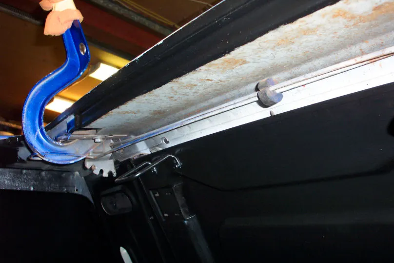

Putting both springs on the third notch on my 73 Trunk lid (with wing) works nicely. Getting them there was a bit tricky. It was a few years ago, but I recall tywrapping the long end of the spring to a metal rod such that it could be levered onto the trunklid bracket notch without the lever slipping off.
You should have one spring for each side.
Thanks man. I need to dig arround and find the other spring I guess. I have a coupe parts car and it only had one. I assumed the convertible had one, but guess I'm wrong. Dang that thing was a b**** to set.
There's also an odd rubber grommet that wedges between the 2 springs where they cross at the center of the trunk. I guess it's just there to keep the springs from rubbing together.
Edit: It's possible that coupes and verts without wings only have one since the trunk lids are smaller. (I can check later). You may be able to get away with one spring each side located on the second notch, but that didn't work for my Mach trunk lid.
Here's a Pic:

Thanks. I guess I must have that grommet too somewhere. The body shop did a great job disassembling, but not so great assembling. After 6 months, I just wanted the car back and didn't want to wait for assembly.
