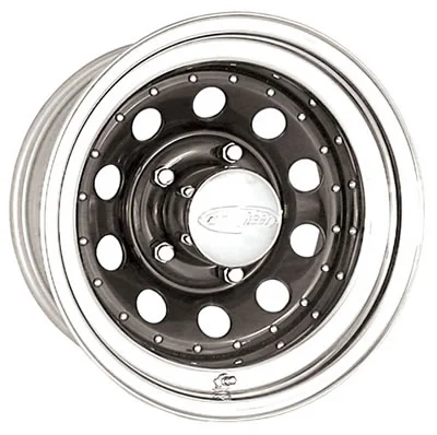

Lets keep this simple then, shall we. I like this wheel, beause its pretty and cheap, as far as wheels go.
Will a 16 inch by 7 inch, with 4 inch backspacing, fit? Is 4 inch backsapcing goin gto look "normal" Will a 245/50/16 tire fit in the rear wheelwell too?
