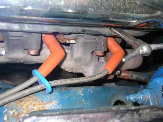

Passenger side

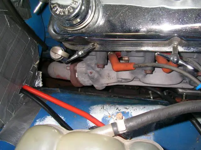

Driver side
Just to show you peeps that the clearance on the passenger side is almost exactly the same as on the drivers side.
Laslo said:
Just to show you peeps ......
Peeps?
Geez, fella, I hope the word 'peeps' is Sweed for People.
Over here it means Child or Baby after the sound baby chickens make. Just figured I should let you know because not everyone is as friendly as me.
Anyhow, factory location of the 302 in a II is between 1 and 1 1/4 inches (25 to 32cm) offset to the right as measured from the frame to the crank centerline. I believe mine measured 1 1/8 inches. This would explane why the exhaust is on the steering shaft.
And if the tail housing is in the factory position. ....
