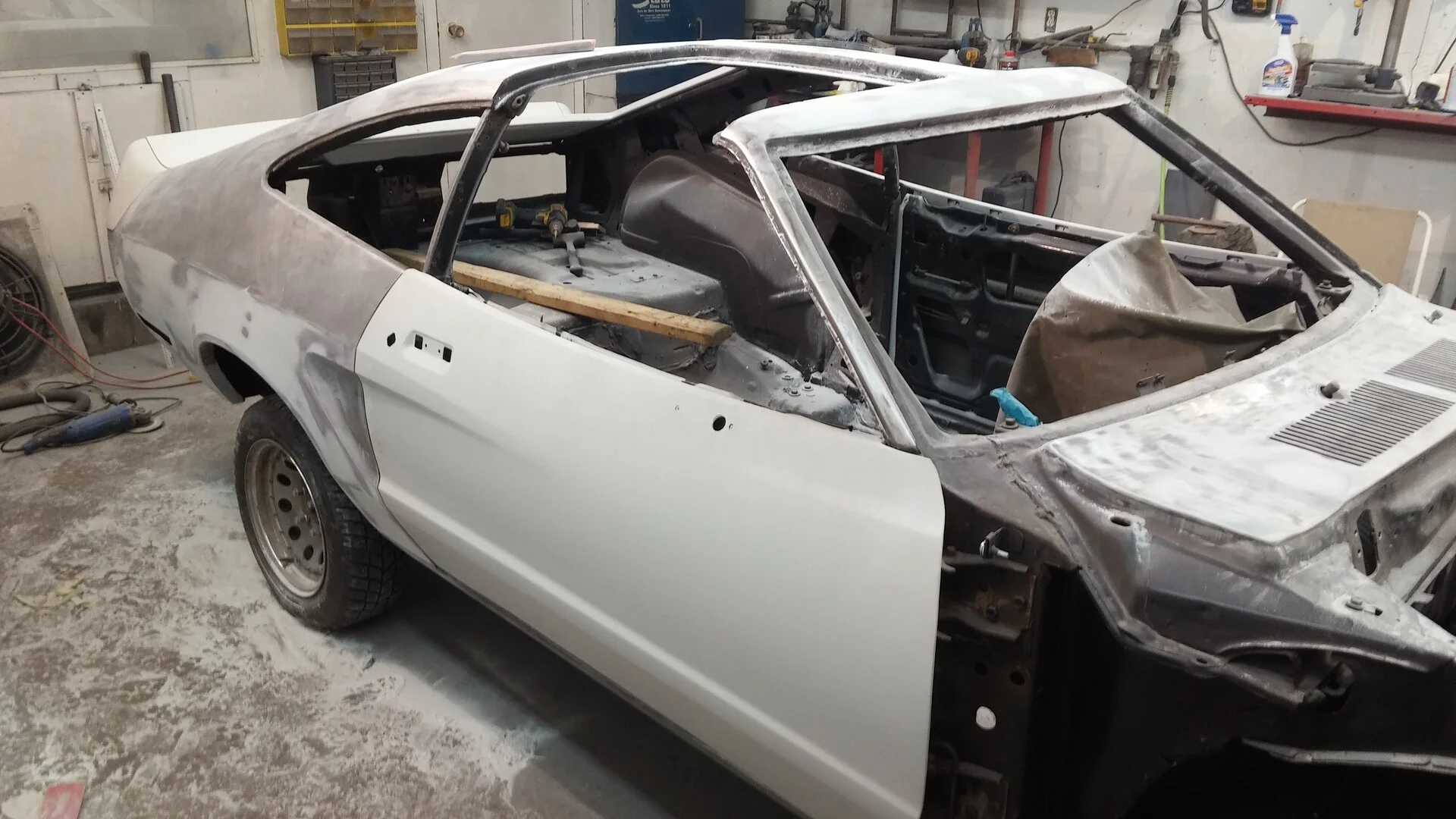

It looks like you have come a VERY long way on this project!
Fun to see some corners really looking fresh and new.

Did ya get Stumpy's sub frame connectors on it yet?
Tell us about that torque box. Its factory for T tops right? Looks like new.

this had been an ongoing 9 year project. my aim right now is to have it running by spring.

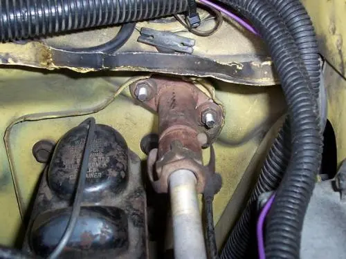

the torque is i believe for the T-top.I didnt put stumpies sub frame connectors,but i did weld in sq tubing into the body and frame.to give it support so it doesnt flex where it is a T-top.ill try to find some pics of that. Can someone here tell me how to adjust the clutch cable.i have Haynes that i have been using,but it doesnt have much info,if any about the 5 liter.Where is the adjustment.it looked in good shape.so its never been off the car.Also if someone could post a pick of where it conects to the release lever assy.that would be great.The car is Cobra two.thanks

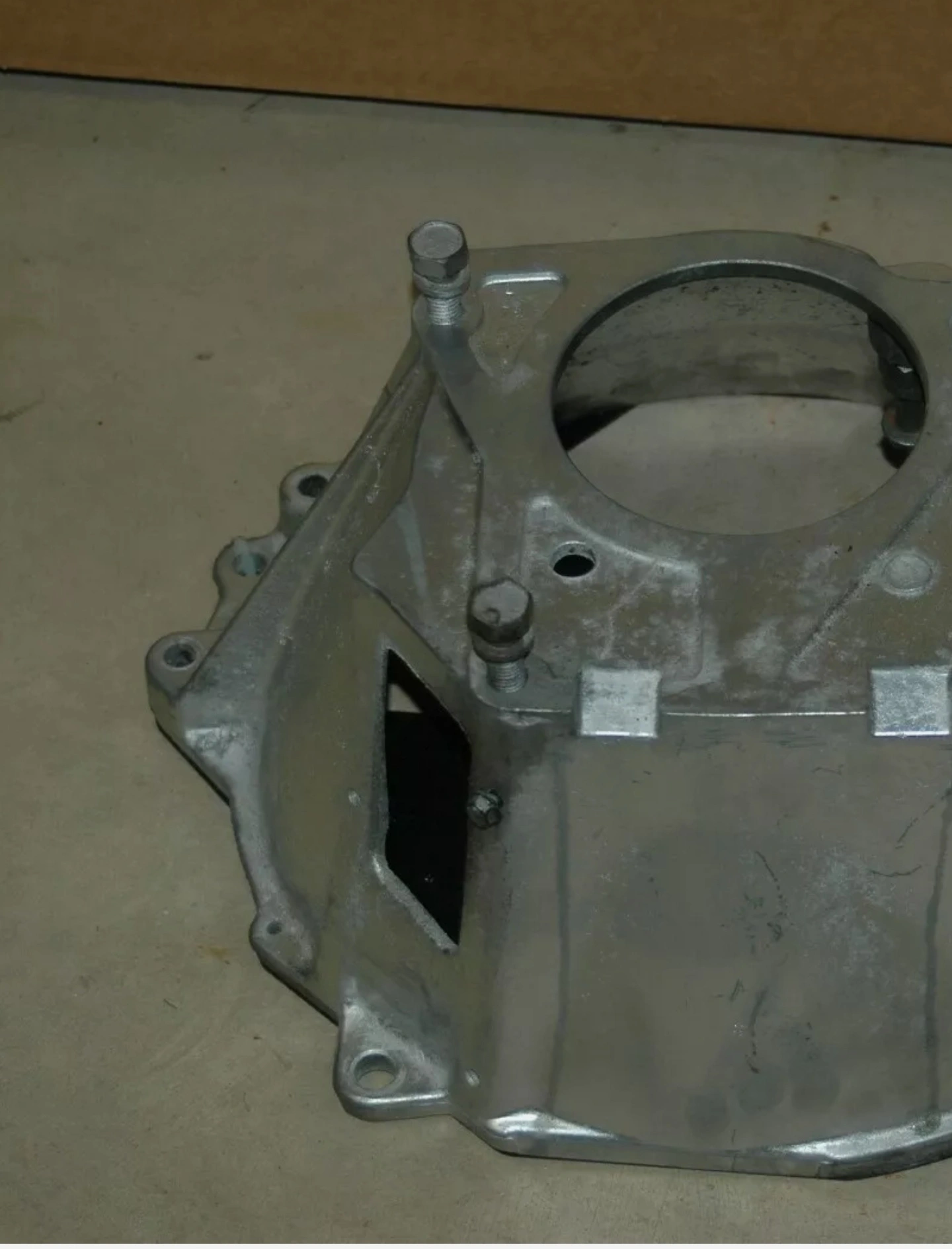

There is an adjusting nut on the cable housing at a sleeve on the firewall. As far as the lever, there is a ball end on the cable that fits into a slot in the lever. The cable housing should also have an adjustment nut on that end and it should slip through a hole in the bell housing.
Here is the firewall adjustment as taken from a thread here on Stangnet.
Here is a pic of a bell housing I snatched from eBay showing the hole in the bell housing that I'm referring to.

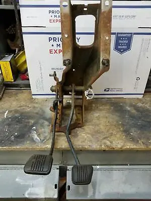

Now if you're talking about the pedal, there is a stud on the top end of the pedal that the eyelet of the cable fits onto and held by a cotter pin. You can see that area in this pic:
Hope this helps! :)

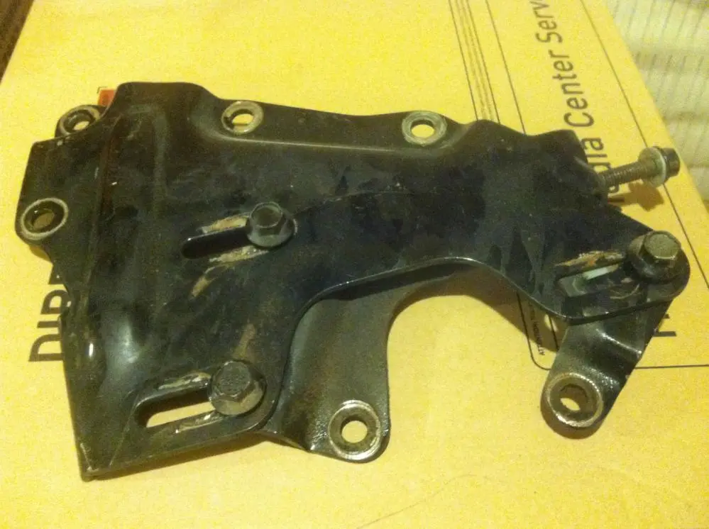

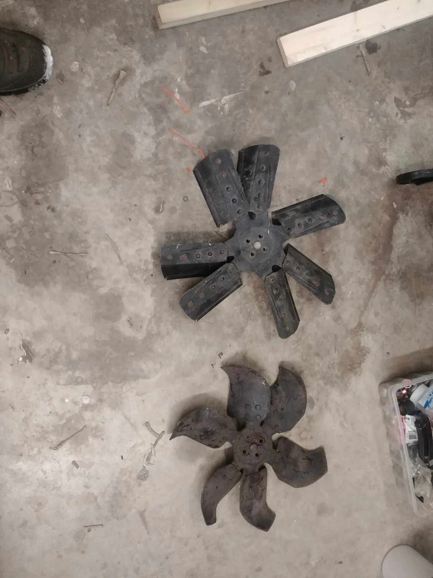

ok.thank you how much play should there be in the clutch pedal,half way to the floor for it to Engauge? The car was originally black.i figured the clutch cable was something like that,its good to have that confirmed. The car was all apart when i bought it,so trying to figure out what goes where.can some one post a pic that has the same car as me of the bracket for the power steering pump.That old rusty bracket is what someone put on the car.ill post a pic of what i think it should be.i have like for different types .this is the only one that seems to fit.And could someone tell me which one of these is the right fan blade.Thanks for your help.

Going from memory on the power steering pump bracket since I got rid of mine, but it's not what you have there. It's a stamped steel bracket. I think @2Blue2 can probably help you out better with a pic. The stock fan is the one with rivets. My suggestion would be to replace it with something newer. I've had one of those decide to let a fan blade go and it come through my hood while driving years ago. So not only did I have to replace the fan I also had to replace my hood. I can only imagine what would happen if someone were unlucky enough to be in it's unobstructed line of fire.....
Now, the clutch adjustment..... The way I've done it is get it as close as I think it should be, test drive, adjust, test drive, adjust until I feel it's about right for me. I'm not sure there's a specific write up for it anywhere. :shrug:
'78 has a different pump than the '75-77 V8 cars.
My car is a 78, I just say it's a 77 because I like the earlier Cobra stripes better than the billboard stripes and, for those in the know, know that 78s had billboard stripes and not what I have. :) And I've had a couple other cars in the past and remember a large stamped steel bracket, larger than the smaller bracket he has attached. But I haven't had a power steering bracket for my car since probably the late 90s, so I'm going from almost 30 year old memory. Googling for a pic of power steering brackets give me this that I think is what I had.
Reactions: 2Blue2
That looks like what I took off my '75.

thats good to know about the rivets on the fan blade letting go. i wonder if i can even buy a new one.ill check it out.i have the big outer bracket in that pic.it does bolt up to motor but iam missing the small bracket that bolts to the pump then to that plate.is there a part number stamped on it.so if i cant find one might be able to get one on e bay.

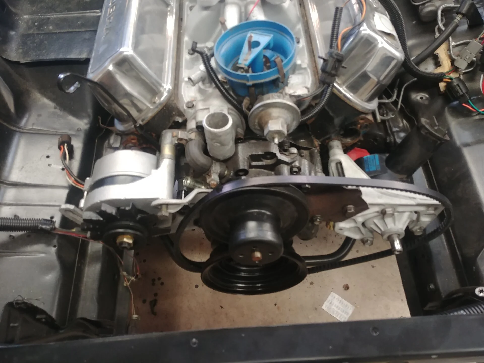

I'm not sure if there's a pic of my engine bay, but I'd be surprised if there's not. All I have running as an accessory is the alternator, and that has since been upgraded to a 3G alternator.

Look at post #683 of @2Blue2 thread. He's got pictures and may have the part numbers.
