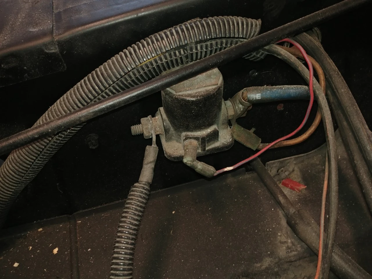

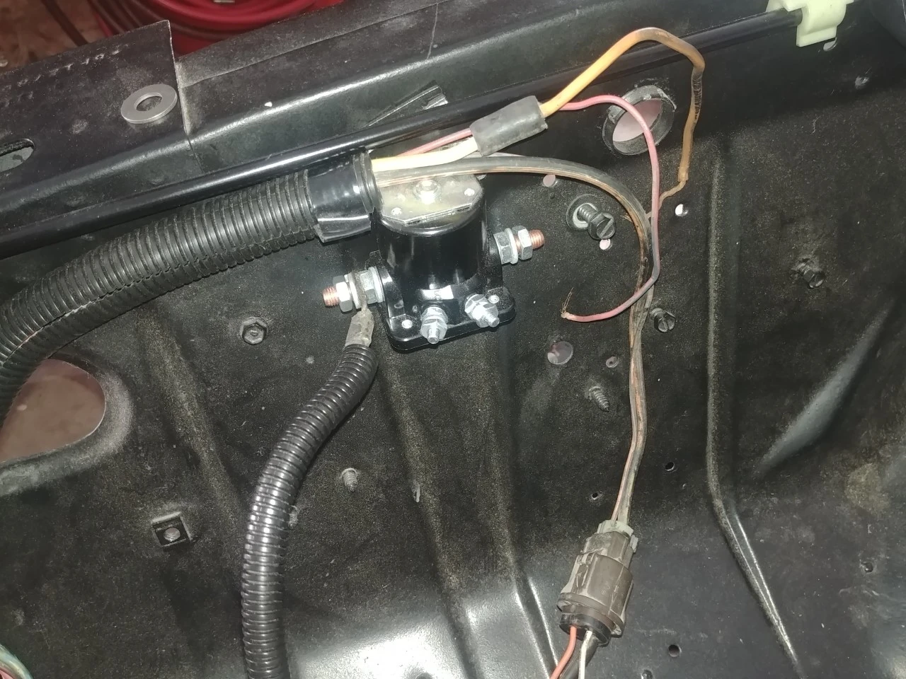

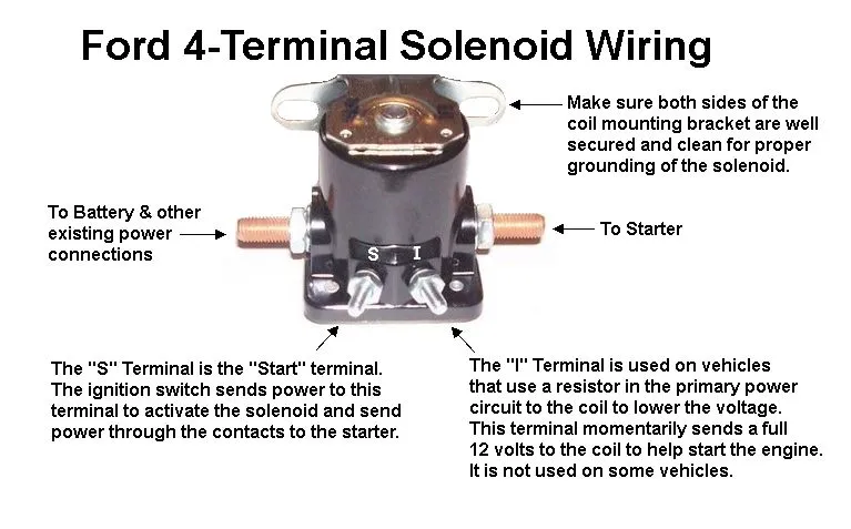

me again this probably comes off as a stupid question, can someone tell me what the difference is between these two starter solenoids. The one with the two terminals on the front is the one i bought, and the other one is the original i think .i thought the two wires in my pic with the new one the wires hooked to the terminals on the front.the old pic to the right says different.why is that.?
The aftermarket one is made for all type of Fords. My 66 Mustang used such a 4-Terminal solenoid. Here is an description and you can read there, that the I terminal is not used for all vehicles:
  • Winner
Reactions: IICrew and Adieu
Extra nailed it. Just remember you can use a 4 post in any application. A 3 post can only replace a 3 post. So aftermarket mostly makes 4 posts since they are pretty much universal.
For me if it has points ignition you use the 4 post. Points will burn out faster on constant 12v. Therefore they run on 9ish volts except for starting when the hotter spark helps turn the cold engine over.

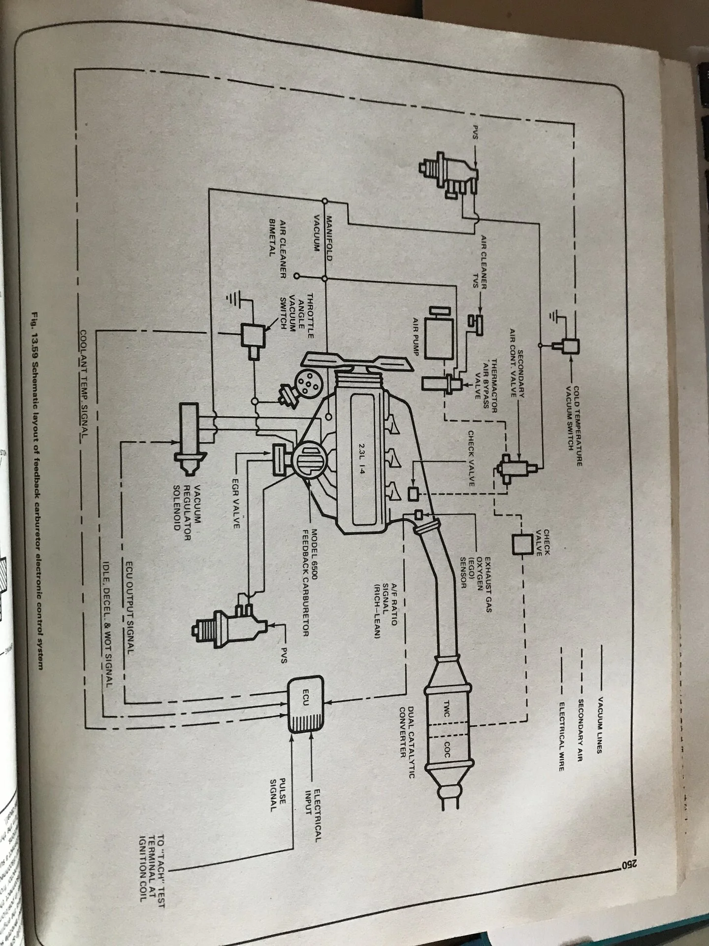

hi again, need more help. Can someone post a diagram showing where all the vacume lines go for the 78- 302.i bought a new 4 barrell 600 holey carb but because the car wasnt together when i bought it ,never had the chance to see what goes where.thanks
