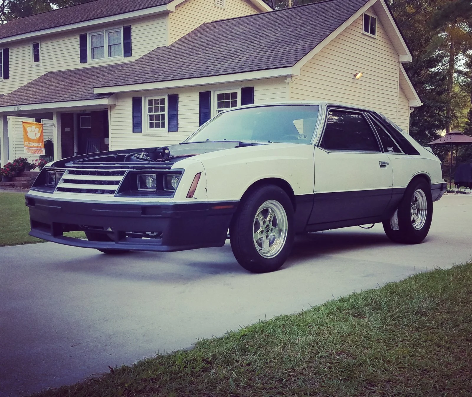

Got the lower body all black

The two tone is looking good
Need drive it and spin the stickers of the rear tires

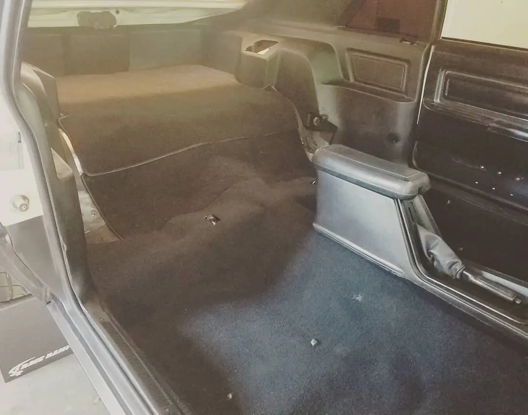

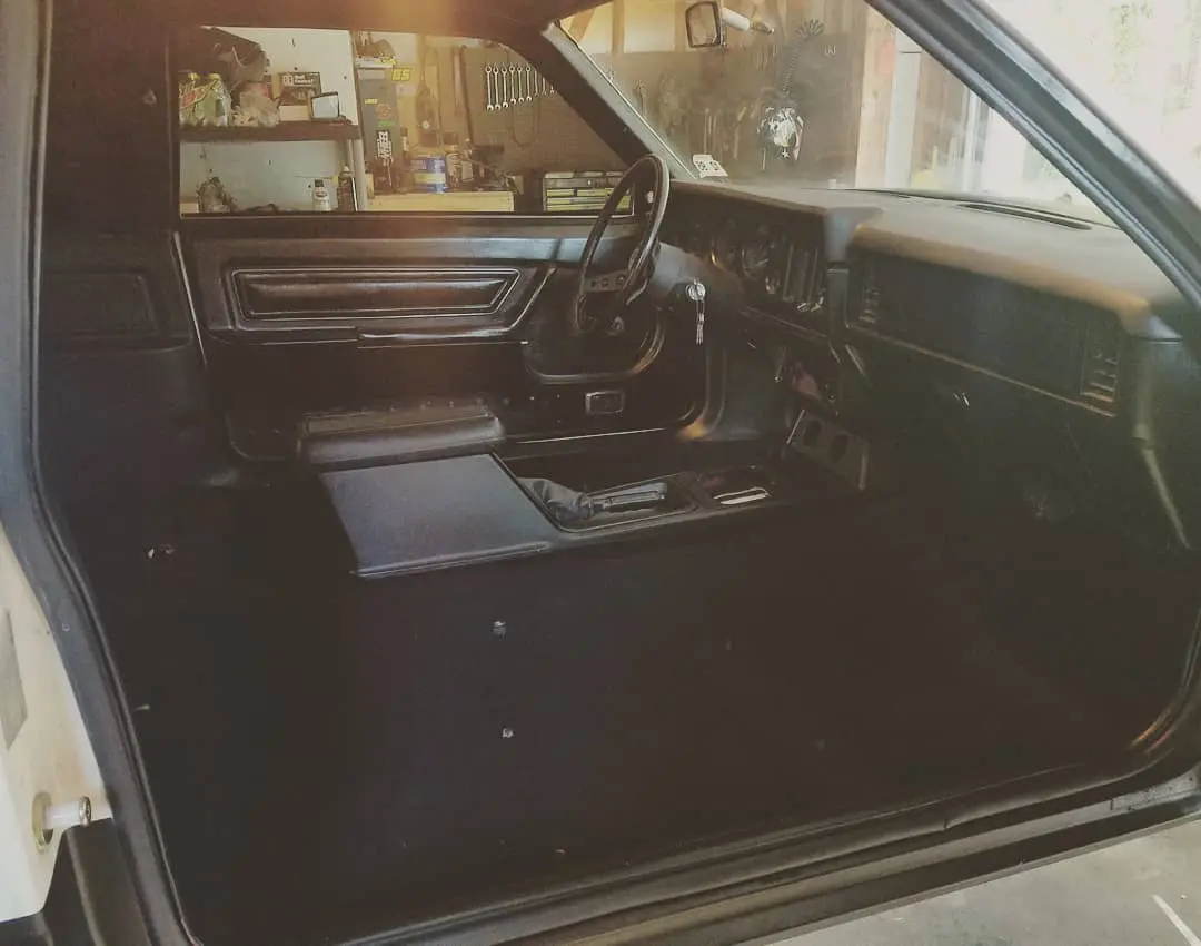

More progress on the interior

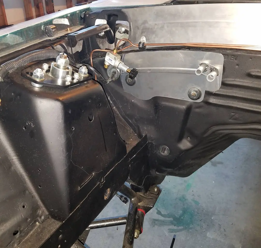

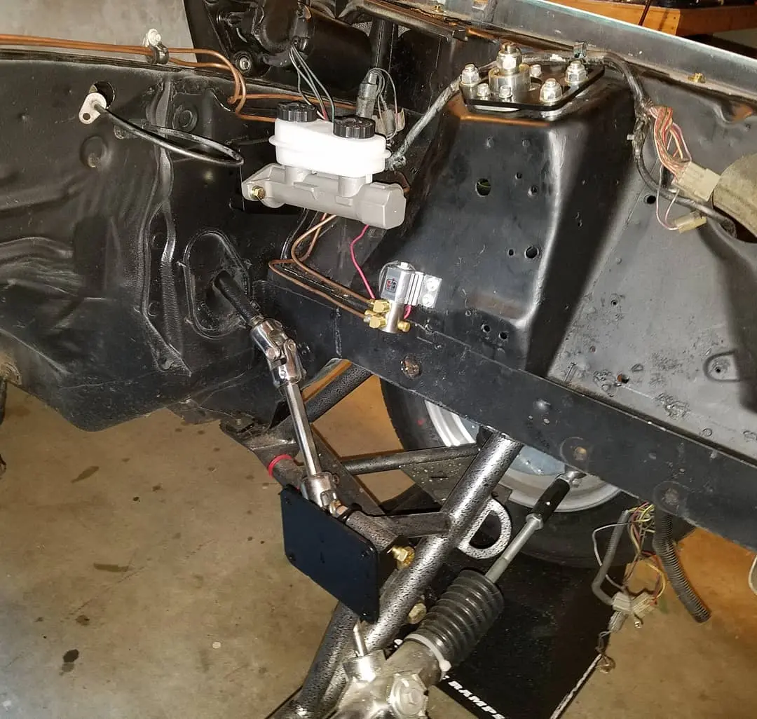

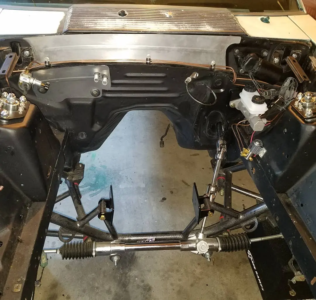

I have been second guessing the placement where I had the rear brake prop. valve. I like the new setup better, it looks cleaner and gets the valve away from the heat of the headers as well. Still got to make the drivers side hardline from the line lock to the wheel well. Fitting should be in today. All that is left at that point is the install the rear brake intermediate hard line and bracket that goes in the center over the rear end. I was hoping to use the 79 hardline as it passed through the inside of the car but it was in rough shape out back near the rear end. Swapping to the later style that follows the frame rail.
