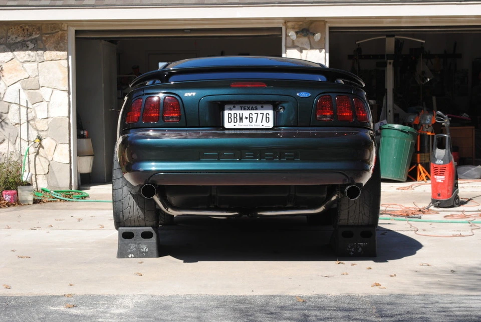

You sure you don't want the drivers behind you to see this lovely sight as well as the increased handling??
Excuse the dirty garage, we were moving at the time so things were thrown everywhere.
txredgt i must admit that is one sexy sight lol,

Thanks man. I know of a few people who have done the watts on their SRA and they are quite happy with it. I went pretty dang far with mine before installing it in the car with FTBR bushings and powdercoating everything. The only things I didn't do is coilovers and replace the dif cover but I did go with a brace. The car (when actually moving) handles so much better than the stock, tired 96 SRA did. Now to get my car's motivation under the hood fixed and then I will be a happy camper.
