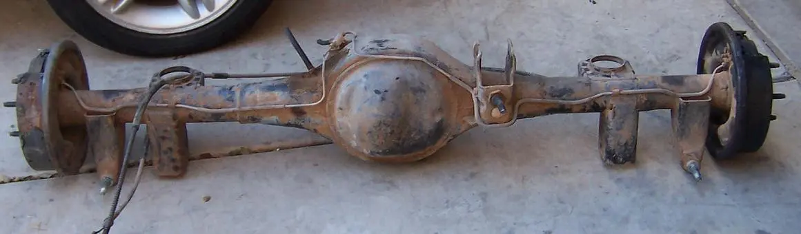

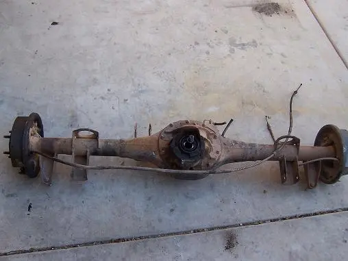

here it is, i am planning on picking it up tonight if it will work. Any idea if it is a small bearing or how to tell? Will the drum brakes be an issue if I am planning on going with disc brakes?
I cannot tell for sure without seeing the flange on the ends (where the brakes are). Whatever it is it is not from a Mustang, and probably not from a car. Looks similar to the large bearing axle i have out of a Bronco, with the various flanges. That is going to take a lot of work, which will cost more than a blown-9 is worth unless you plan on doing the labor yourself.
It is from a 73 mecury marquis. Depending on what labor i would do it myself. But I am guessing maybe I would be better off grabbing an 8.8, replacing the axles and getting c-clip eliminators. I found some rock crawling site with a 8.8 from an explorer for $750 new (just an example). Summitt has new superior axles for like $100 and morser c-clip eliminators for $125. I think I will go that route instead.
A Marquis eh? I'm willing to bet it is too long for a Stang. So you are looking at cutting the tubes, welding on new flanges, cutting all the braketry off, welding on new spring perches, then buying a complete chunk (the one in that pic is toast) and axles, then you still need brakes.
I was lucky to find a cheap 9 that bolted right into my Stang. I'd go for a bolt-in 9 first choice, but I'd take a 31splined, track-lok, and disc brake equipped 8.8 from a Ranger/Explorer second choice over a nearly custom 9 (for cost reasons).
