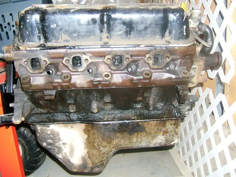

The 351w engine just after pulling from an old truck

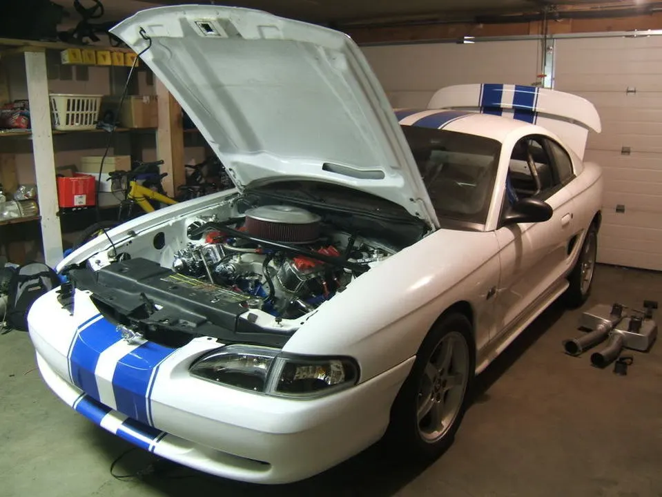

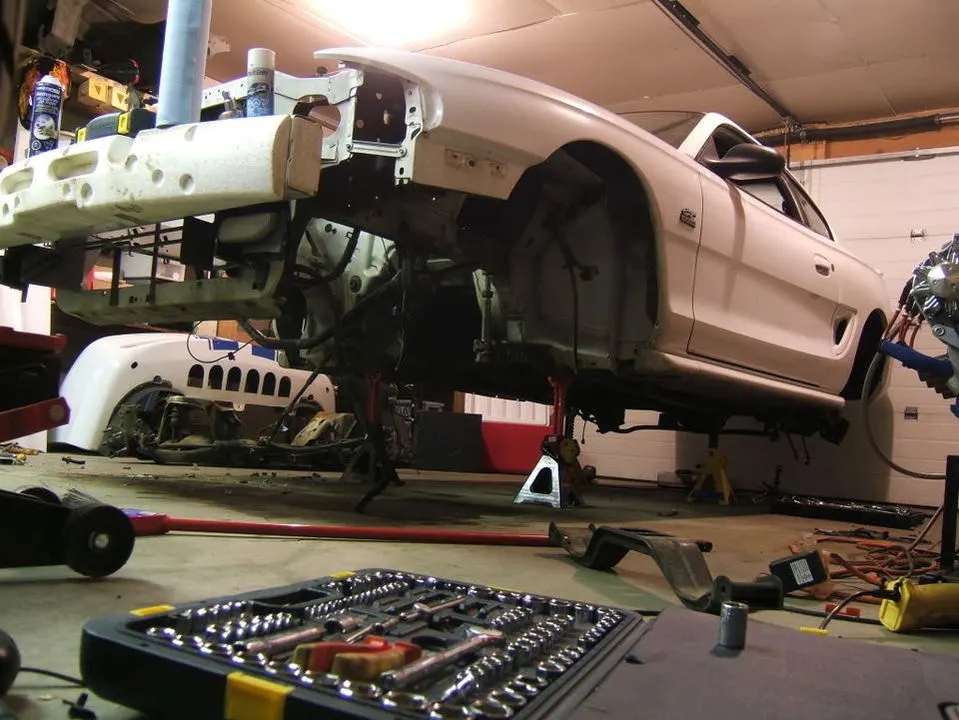

The mustang torn down

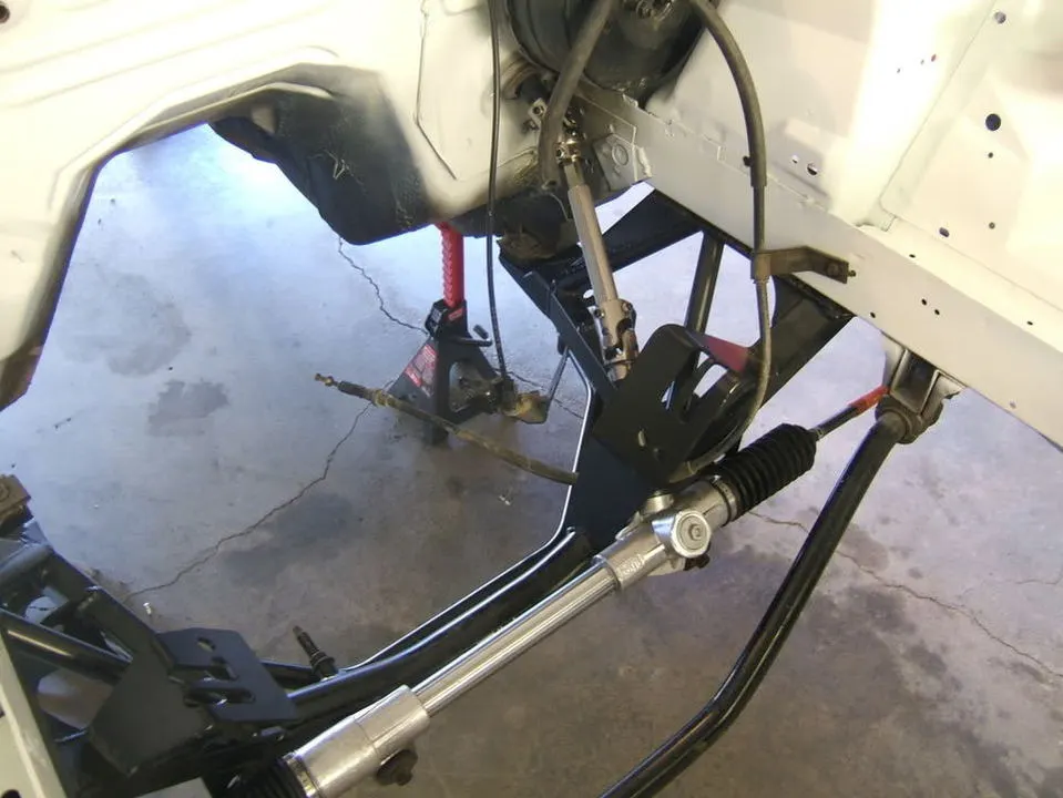

Maximum Motorsports k member and flaming river manual rack

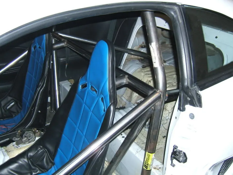

The roll cage tached in. I am adding two more bars to my main roll hoop.

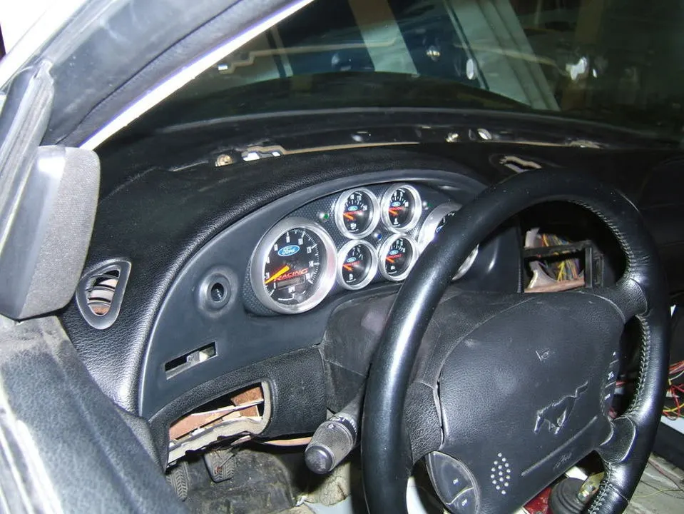

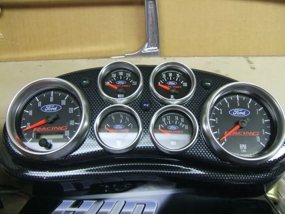

My new dash turned out amazing. I have everything I need here. No other gauges to give it a cleaner look.

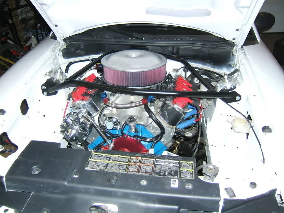

I was able to fit a 4" air filter under the hood! The headlights are black beauty with an HID conversion. I will be able to see a worms ******* in the ditch.:rlaugh:
That's pretty trick with the coil over setup and a clean/unique install.
Is that a kit you made or is offered? I'm assuming the dizzy gets used as a cam sensor. Do you just run a reluctor wheel off the balancer? Will a standard 6al support that or do you have to run a dedicated driver?
Just curious. Looks awesome!
I pieced it together. I get my cam sync signal from the oilplug/halleffect sensor and I use a msd flying magnet crank trigger to get crank signal. This feeds to a standalone ecu (Vipec v44) to control my coils. It has alot of other goodies. It has an idle air controller on my throttle body which will be nice with a larger cam. Another cool thing is that my ecu plugs into a indash computer which goes to a 7" touch screen in the dash. So I can tune on the fly. The computer is built but I am currently getting it all in the ac bezel from a 2002 mustang right now. Taking alot of time to make it look good.
