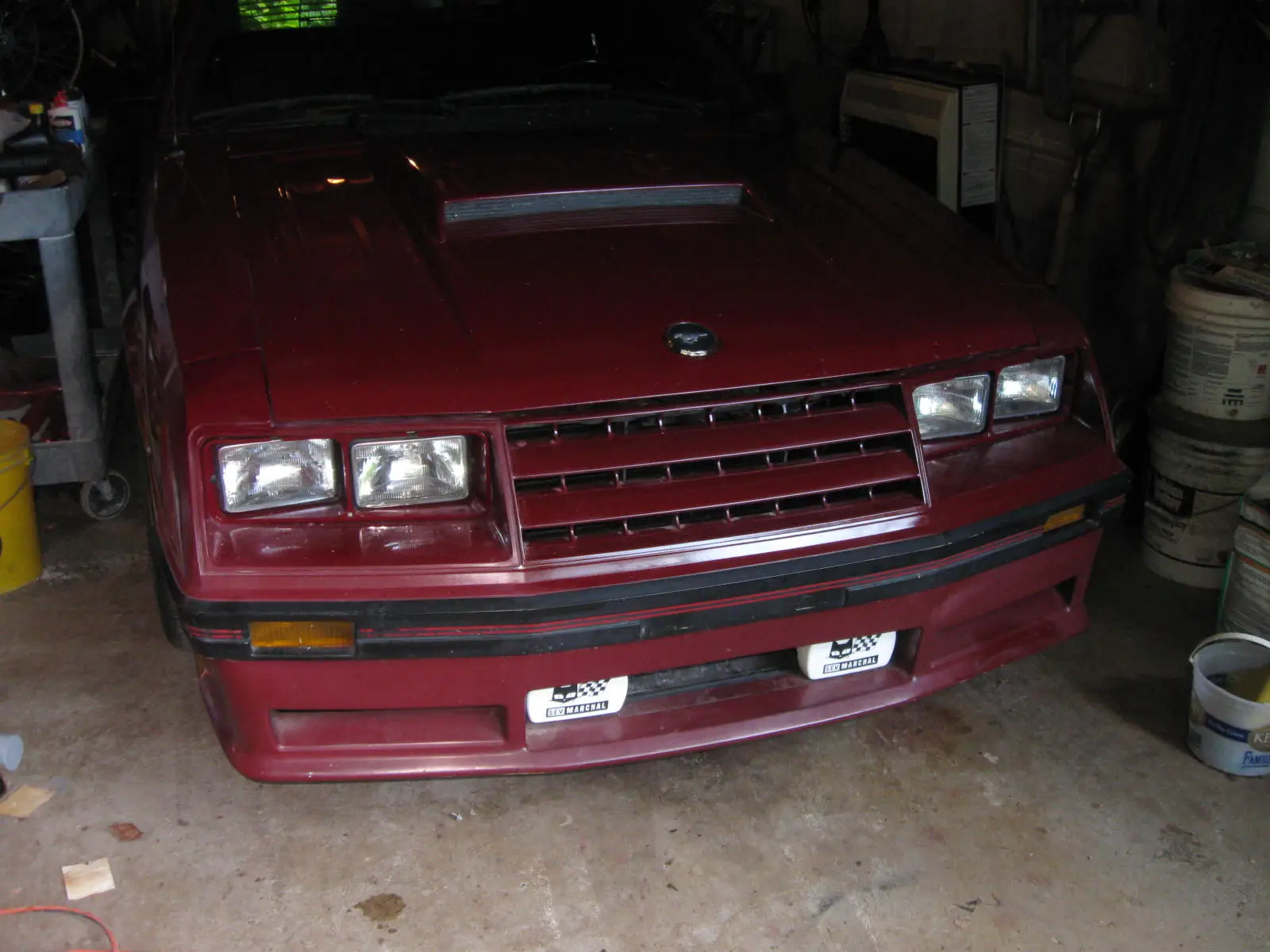

Hi. New to the forum. Just picked up a sweet 82 gt project, one of my "always wanted one" from my younger years. It came (not installed) with a posi rear end that is disc and 5 lug, from a 88 turbo coupe. Would this be a straight up bolt on application. Done alot of wrenching in my years just new to fox bodied mustangs. my last stang was a 68 fastback i restored 8 years ago. Somewhat simpler. Thanks much
As a direct bolt on as far as controls arms and shocks are concerned, yes. Buuuut, it is 3/4 inch wider on each side. You will have to play with wheels sizes and off sets. You can use factory wheels usually if you retain stock tire size. You will also need a bunch of other random odds and ends. I would just go yank one from a mustang at a you pull it and call it good. throw the disc brake conversion on it later. Ooooor, you can buy the semi built rear end I have in my shop. Lol
best ive got till i roll her out. 88 k original miles. No cancer. Runs. Bought it in the middle of a 5lug conversion and no exhaust. So not driveable at the moment. Ttops, manual.
