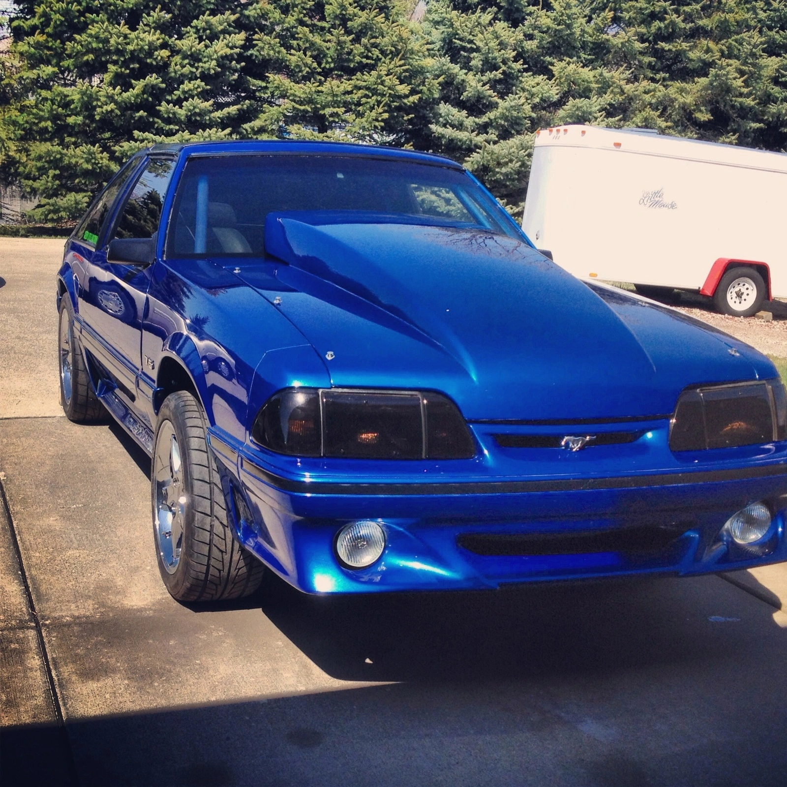

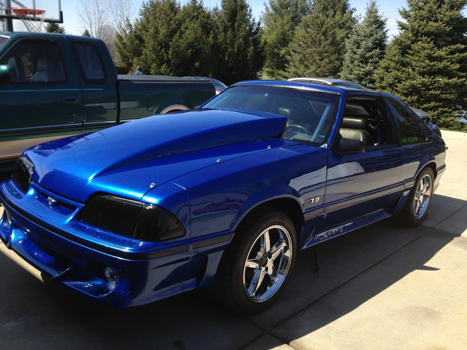

It's been converted to a 93 and has 10point rollcage, big frame ties, coil over in front, Lakewood drag shocks, drag bag, and don't forget the 6in outlaw hood ;)

One thing is for sure... you'll have plenty of room for intake/carb.
Purty color.
The short block should be plenty strong for what you are doing.
Good choice in heads too I'm sure.

I'm liking this. Except I would take the 7.5 emblem off, it's not a 460 lol. And that will be a pretty potent car. I'd love to have an early 80's 4 eye car and put a nicely built 351 in it. It'd be a fun little street runner
