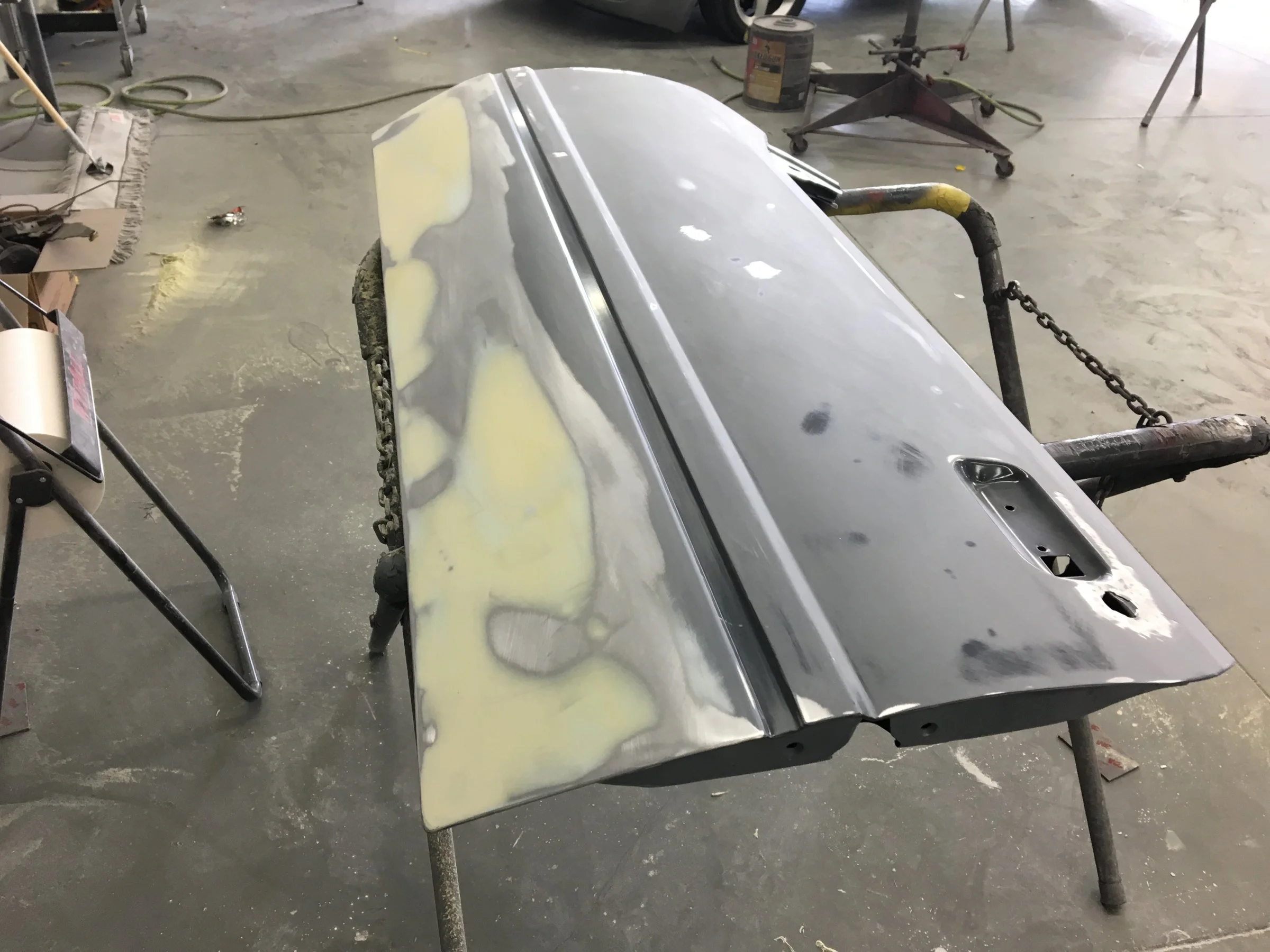

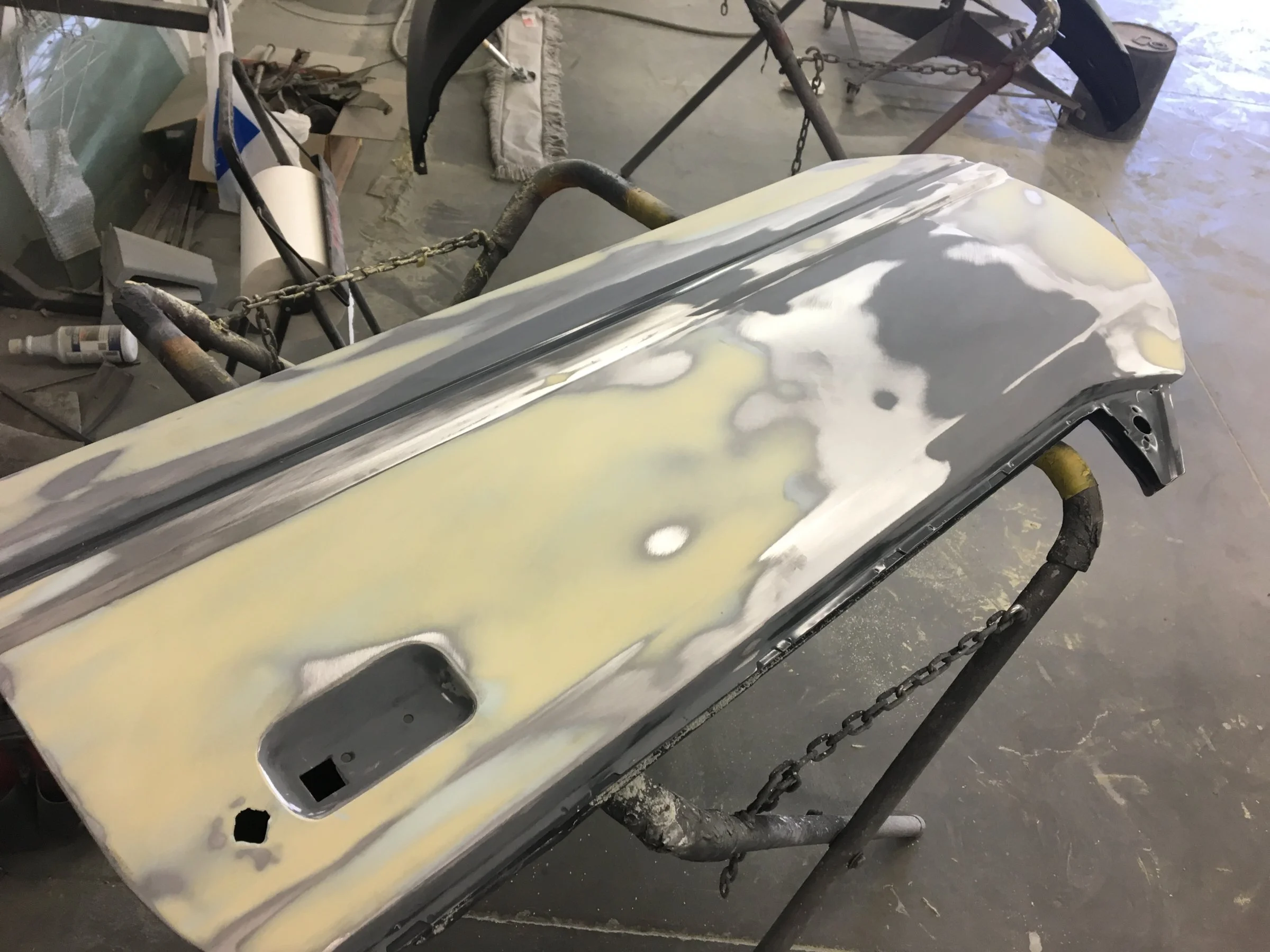

Ok, pulled out the worst of the dents.
Then I mudded the lower. It blocked out very nice. Those fox lower door waves are no more.
I had a little more time so I ground the primer out of the way around the door handle and slung some more mud. I'll block it out tomorrow.
Hopefully tomorrow I'll finish the bondo stage and be able to get it back in primer.

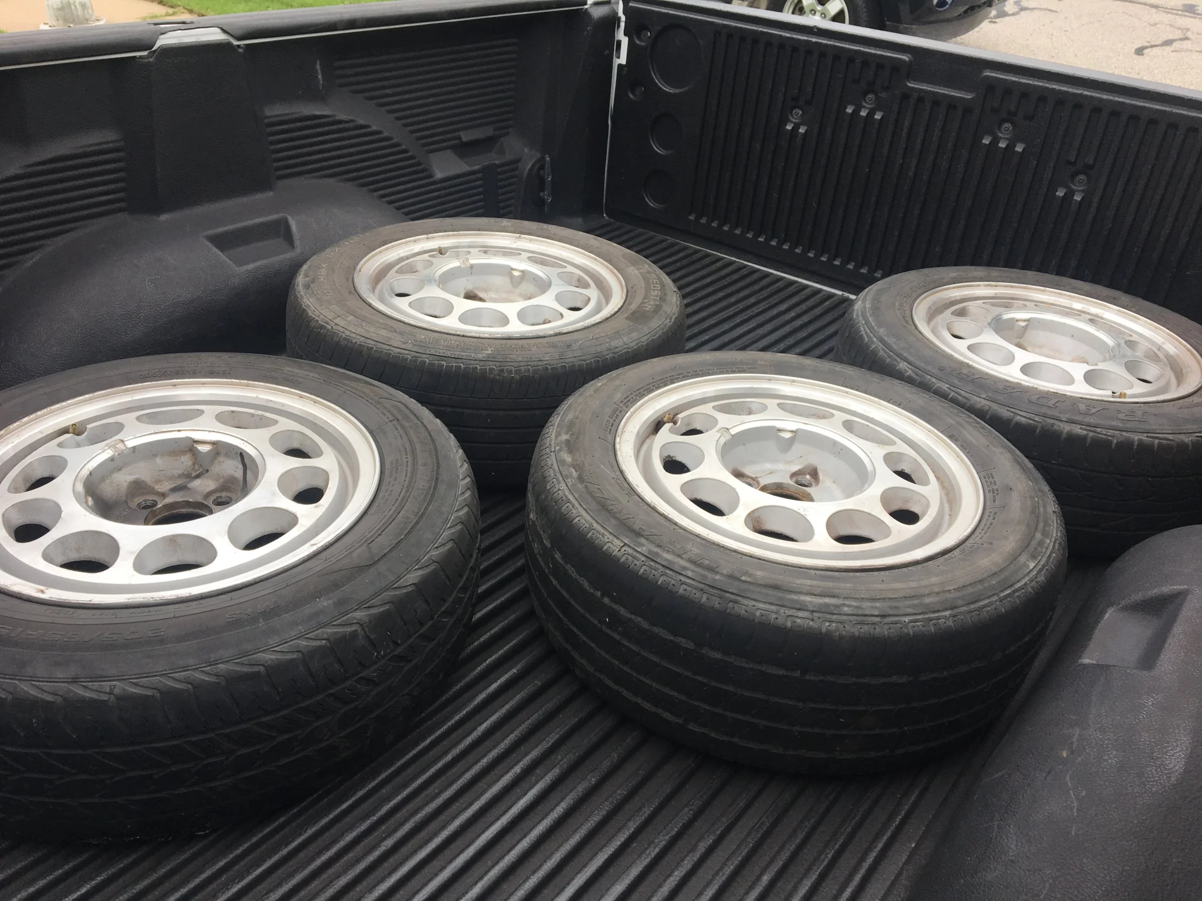

Latest mini-purchase. I got a set of four ten hole wheels with decent tires for $50 off of CL! Woohoo! I'll be able to move the car now when the time comes.

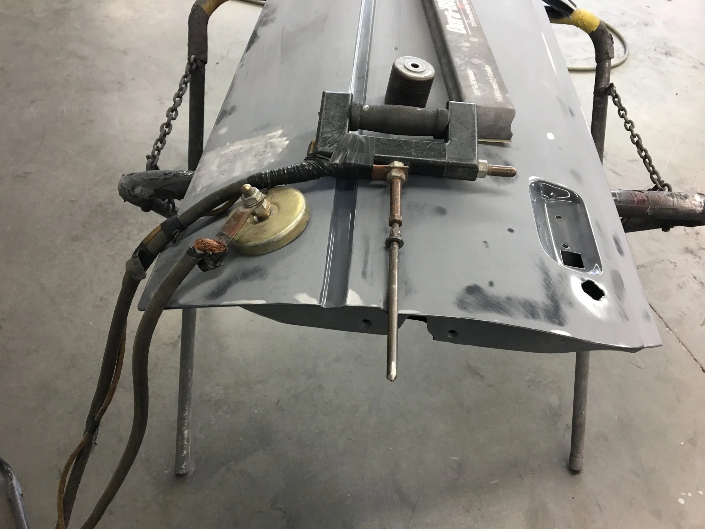

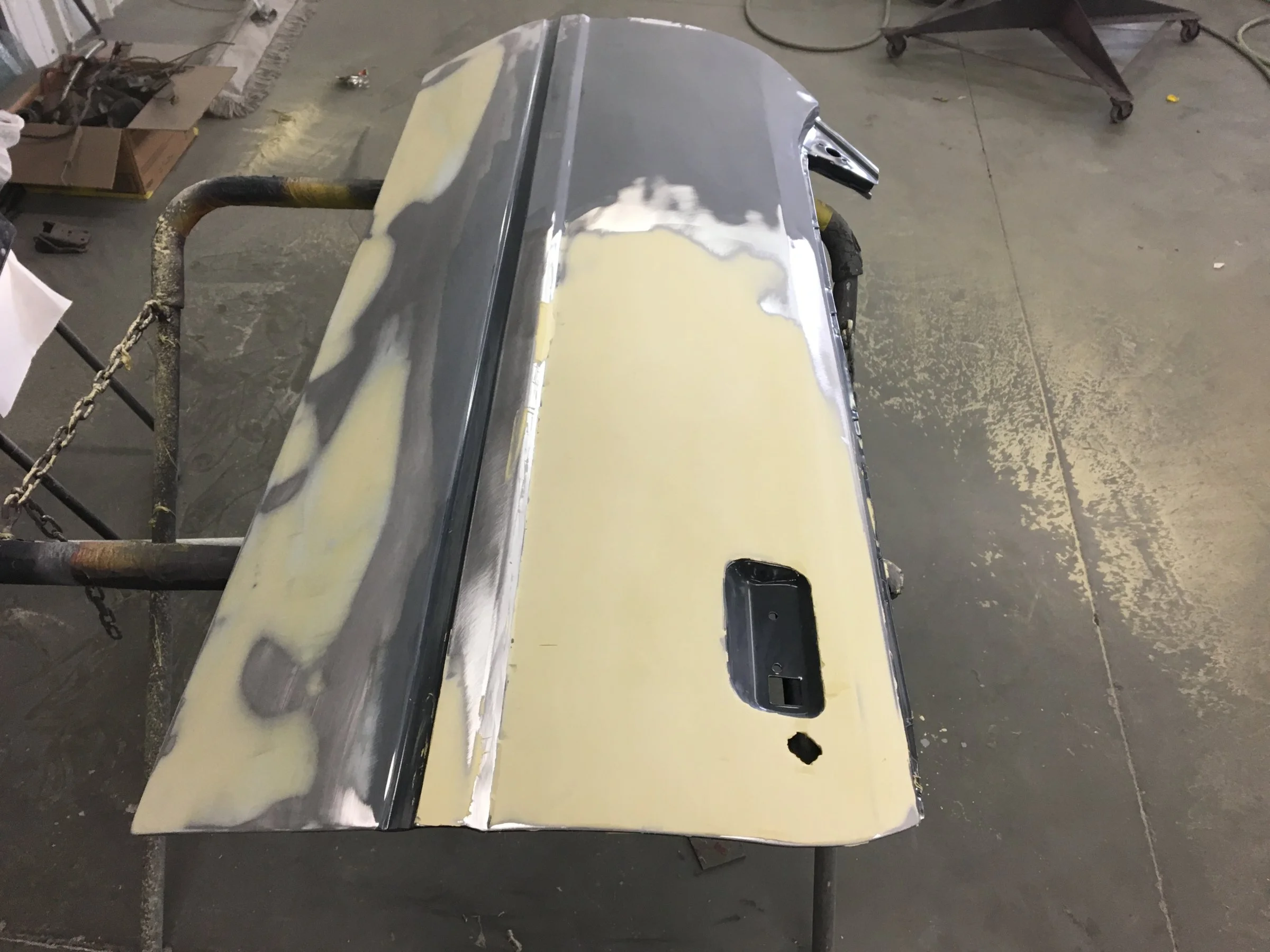

I got the top half of the door finished off today. I still need to get the edge where the belt moulding goes.

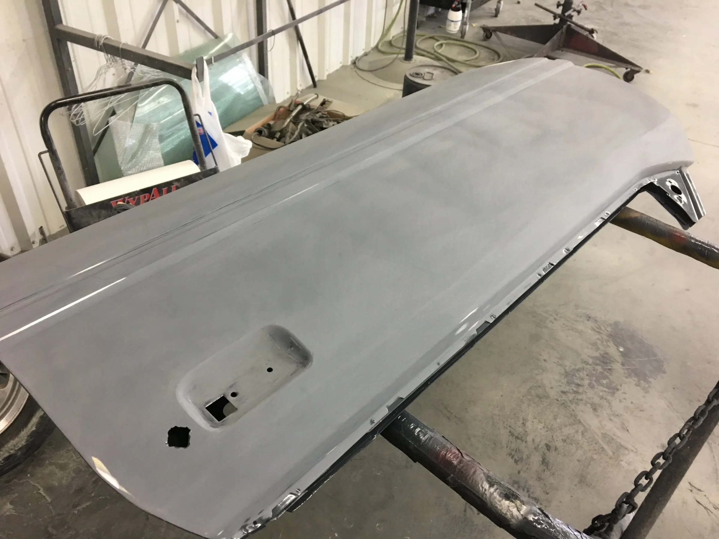

Got the mud work done and got primer on the door. I'll probably start blocking it tomorrow. 220, then 320, then reprimer, then final blocking. I'll flip the door after I reprimer and get the seam sealing done though.

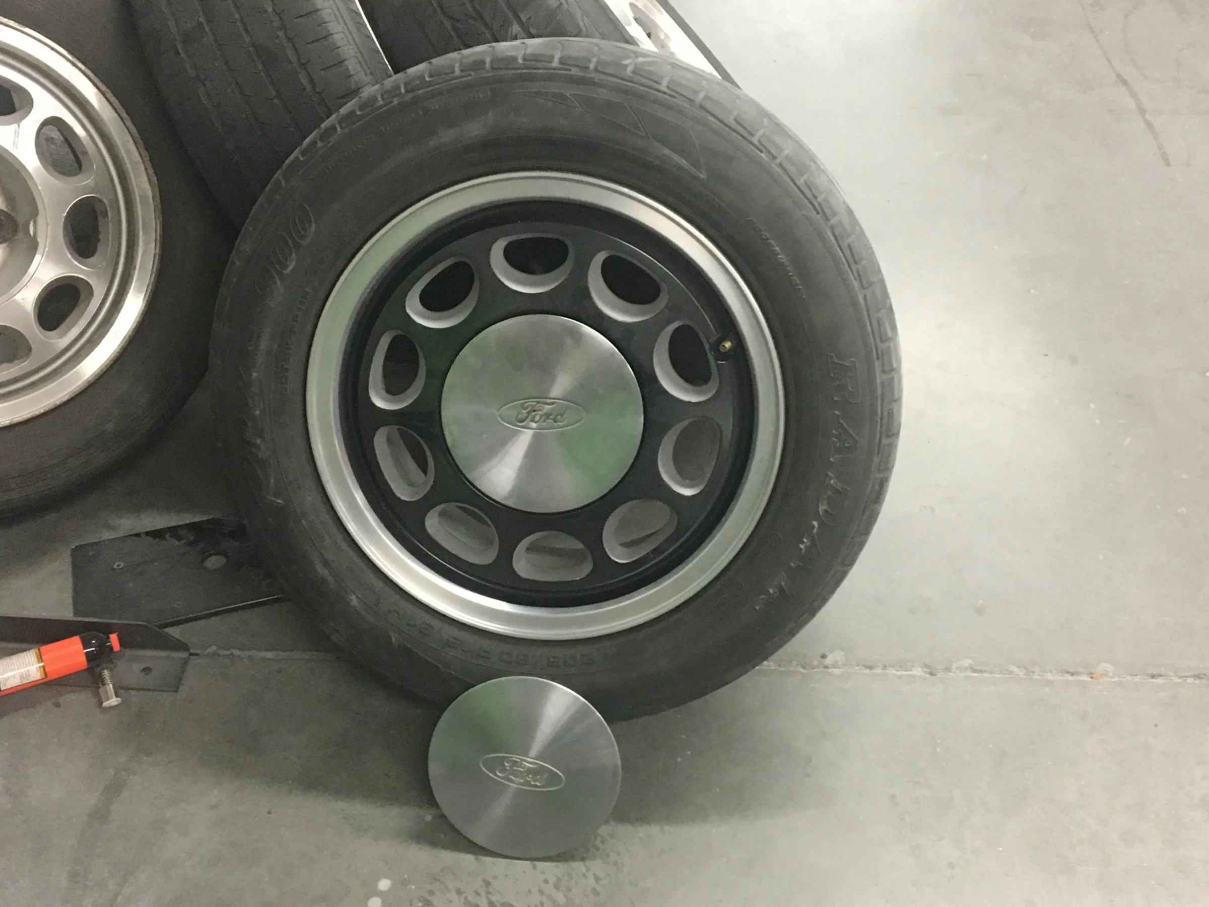

Opinion time!

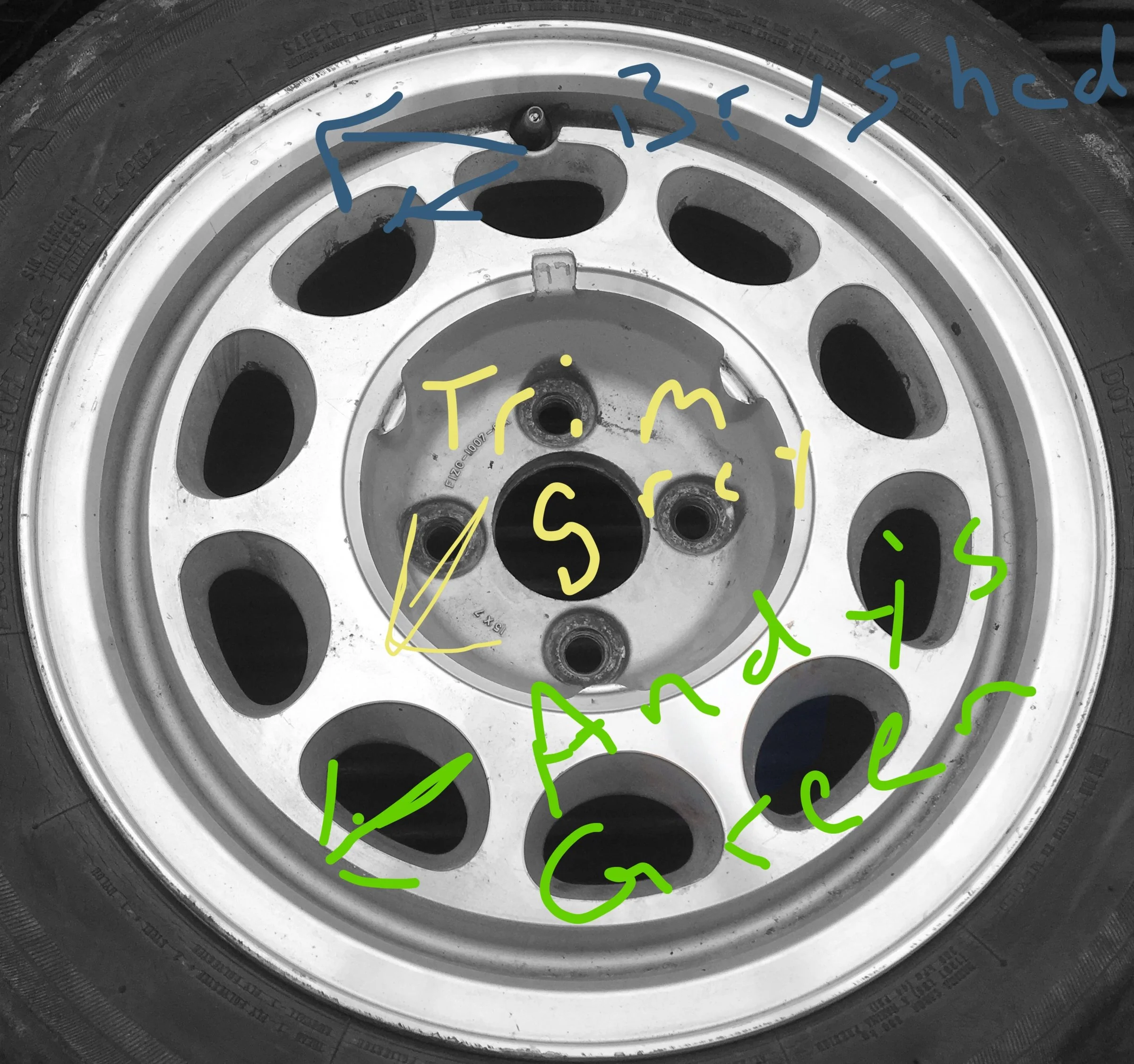

I picked up my "new" wheels today. I might be keeping these for a little bit until I can afford the new wheel/tire combo.
I think 10 holes are ugly, maybe paint. Take a look at this picture and tell me what you think can improve this ugly design. This is an initial idea. Andy's green is that color I used for the GLX emblem on the hood.

I did my initial blocking this morning with 180. I couldn't be more pleased with how the bondo turned out. It's a straight door now! Woohoo!
One more blocking with 240 and reprimer today.

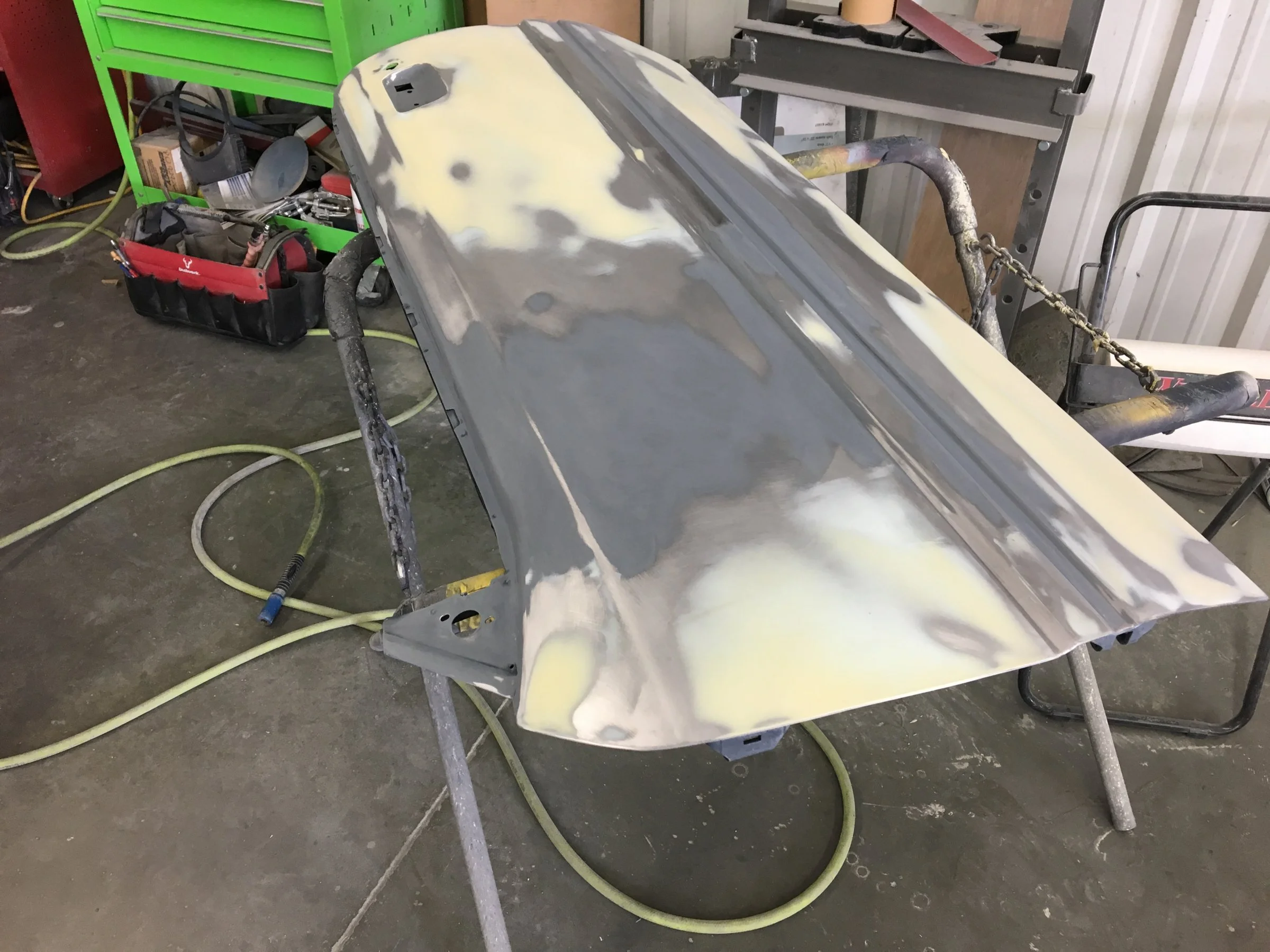

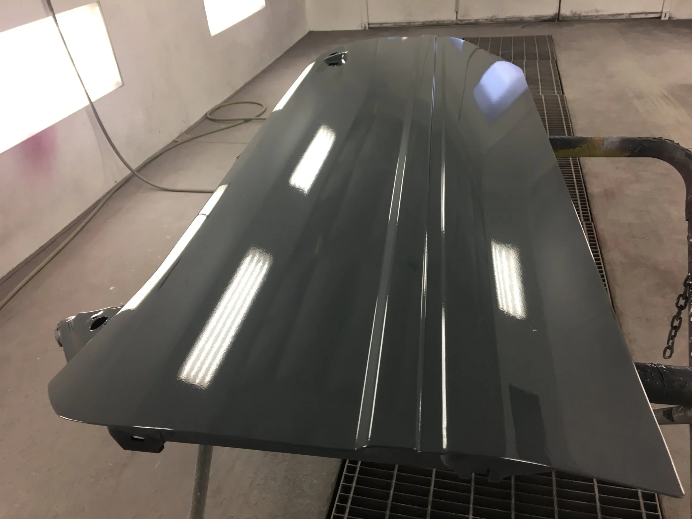

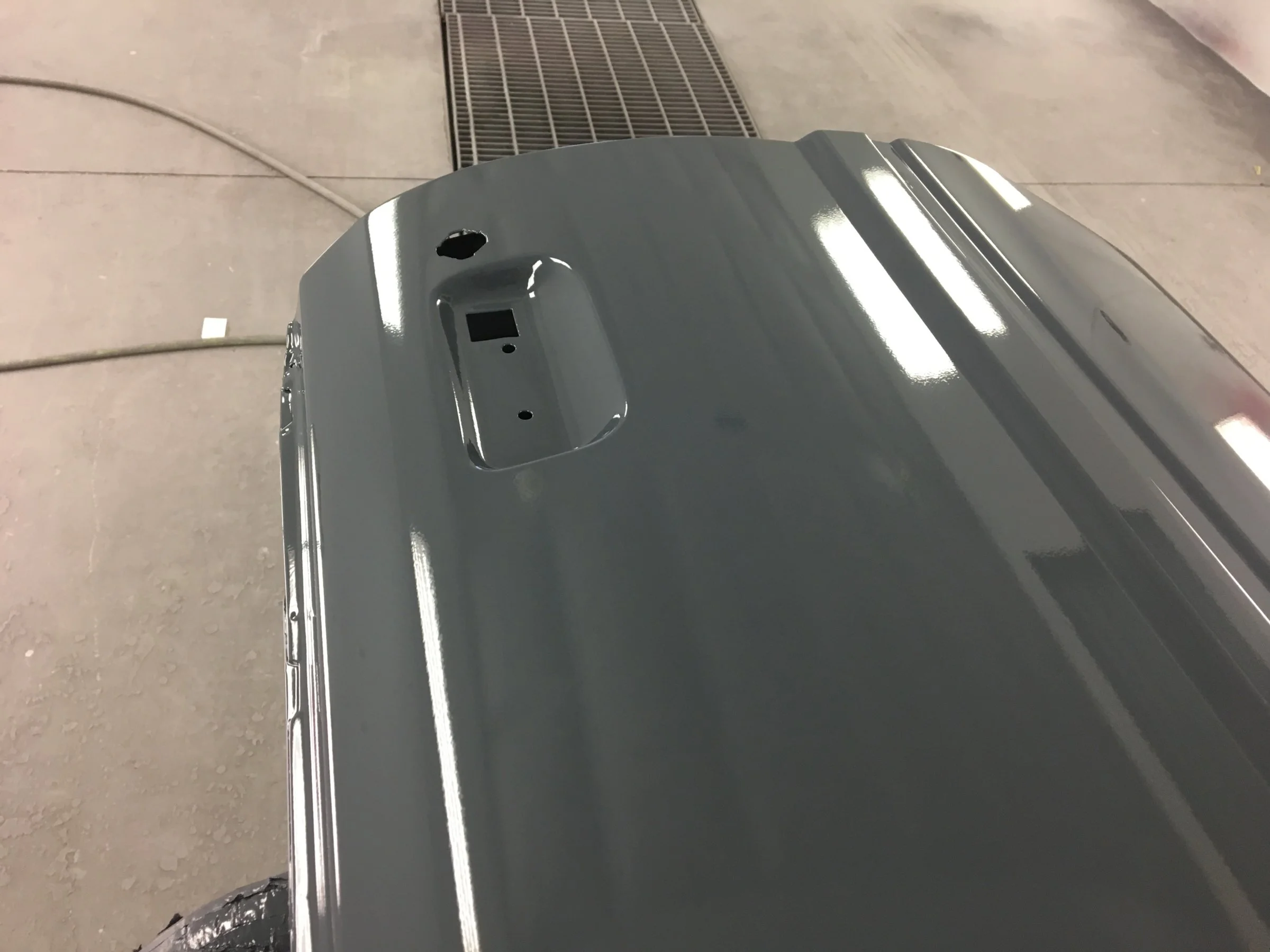

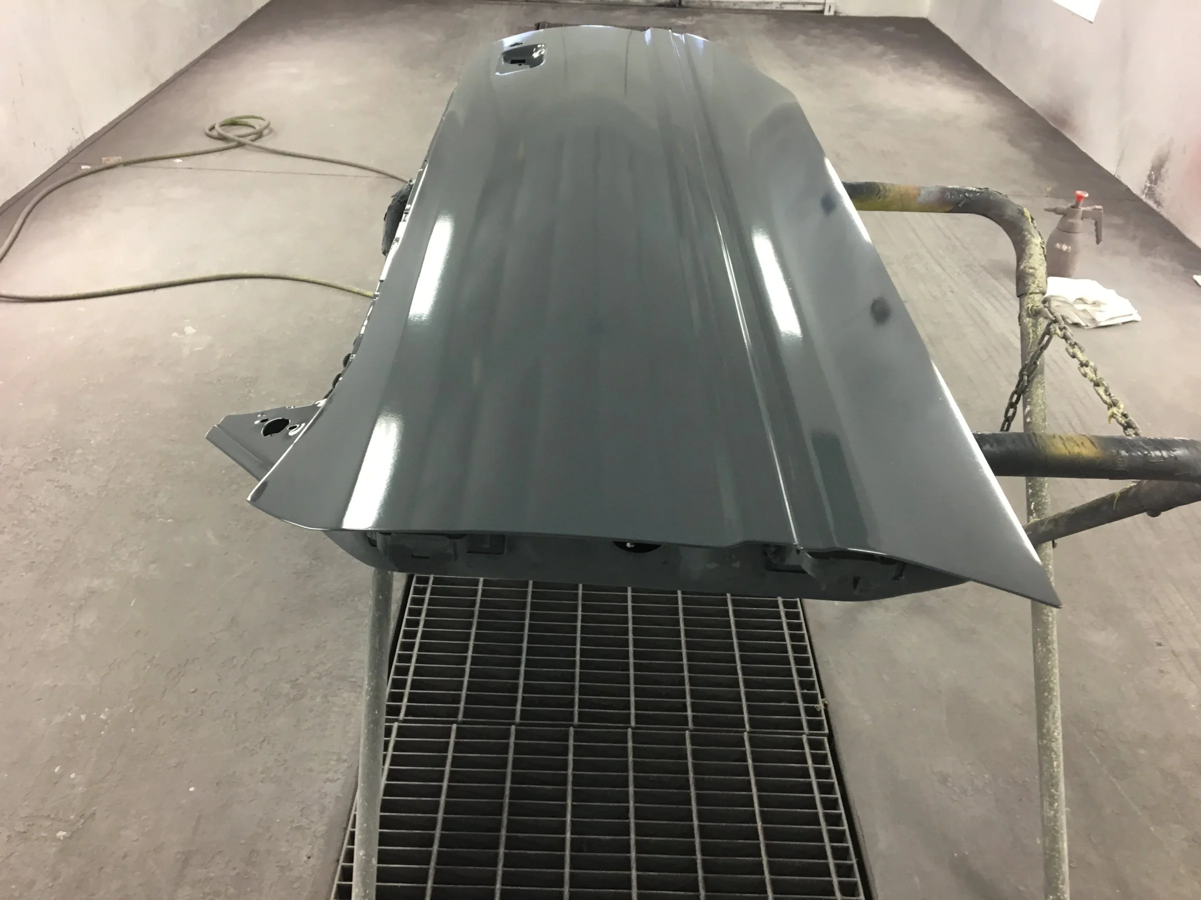

Here it is in final primer. I love how straight I got around the door handle.

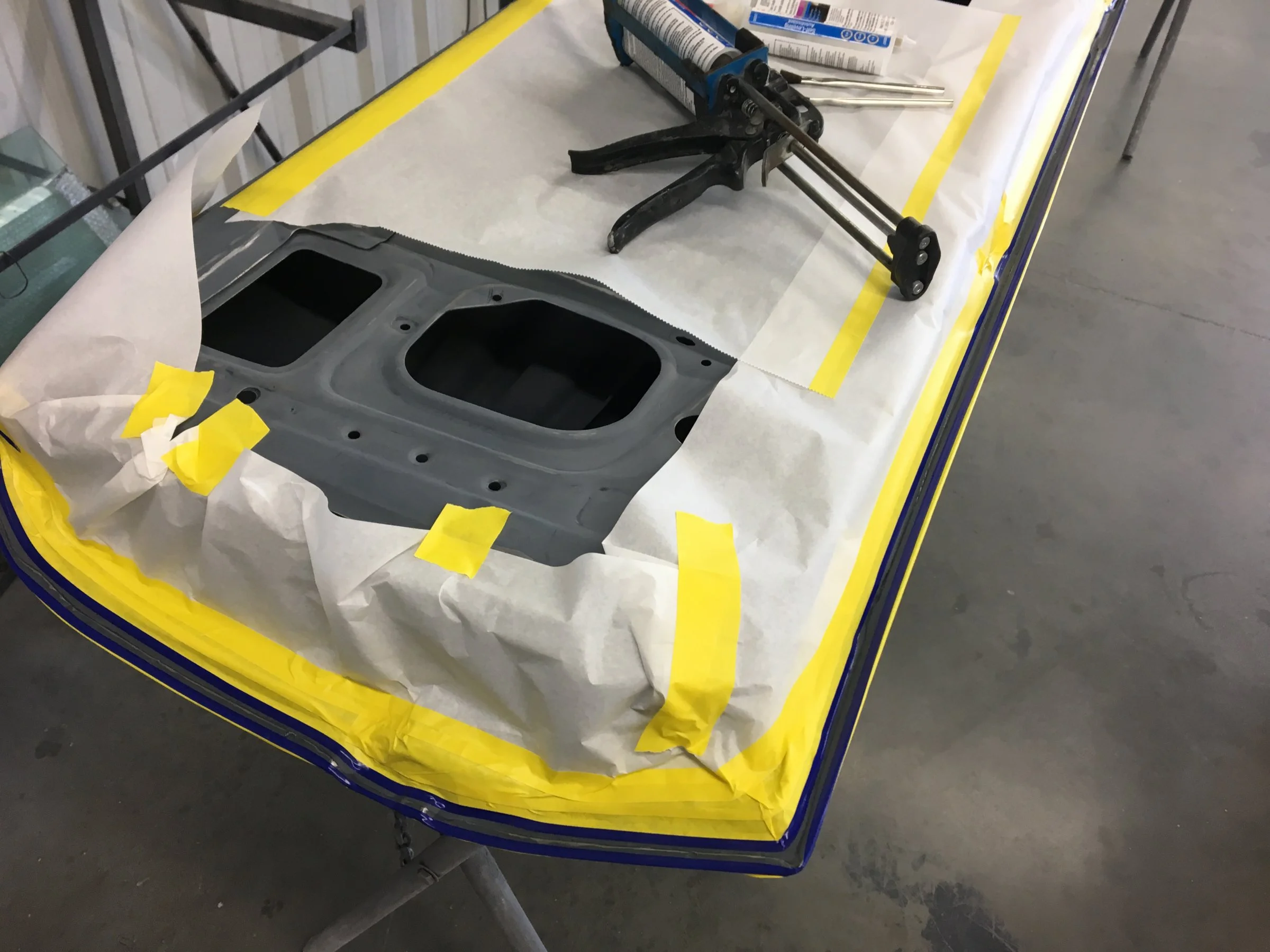

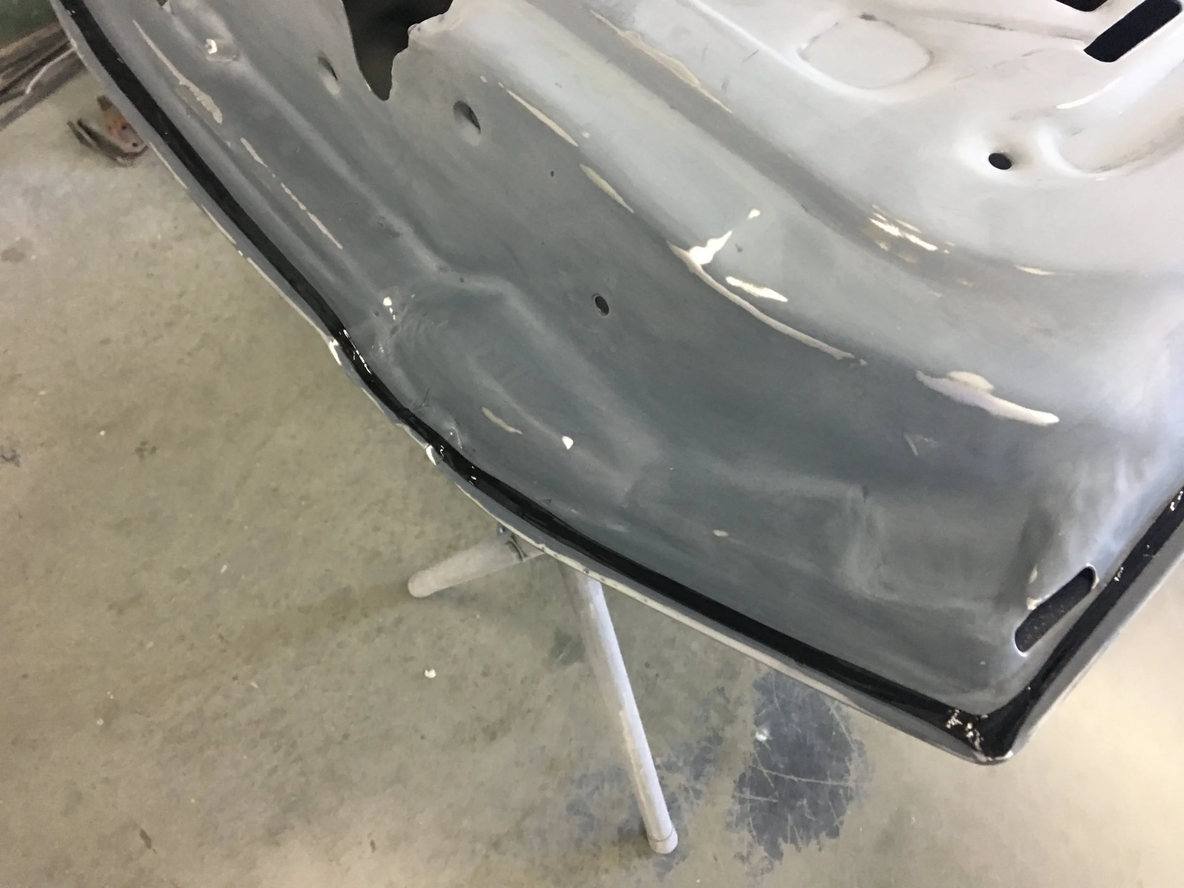

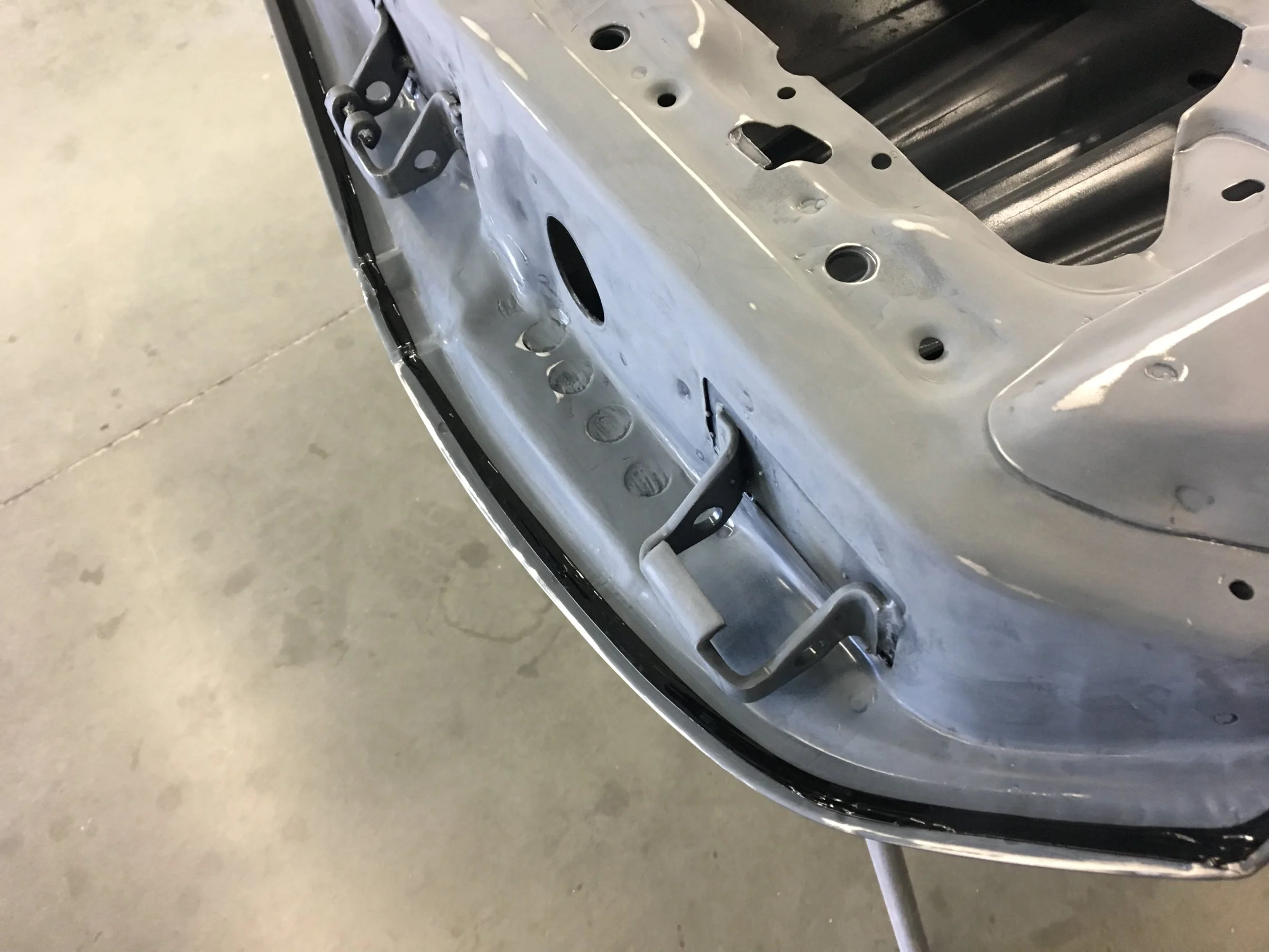

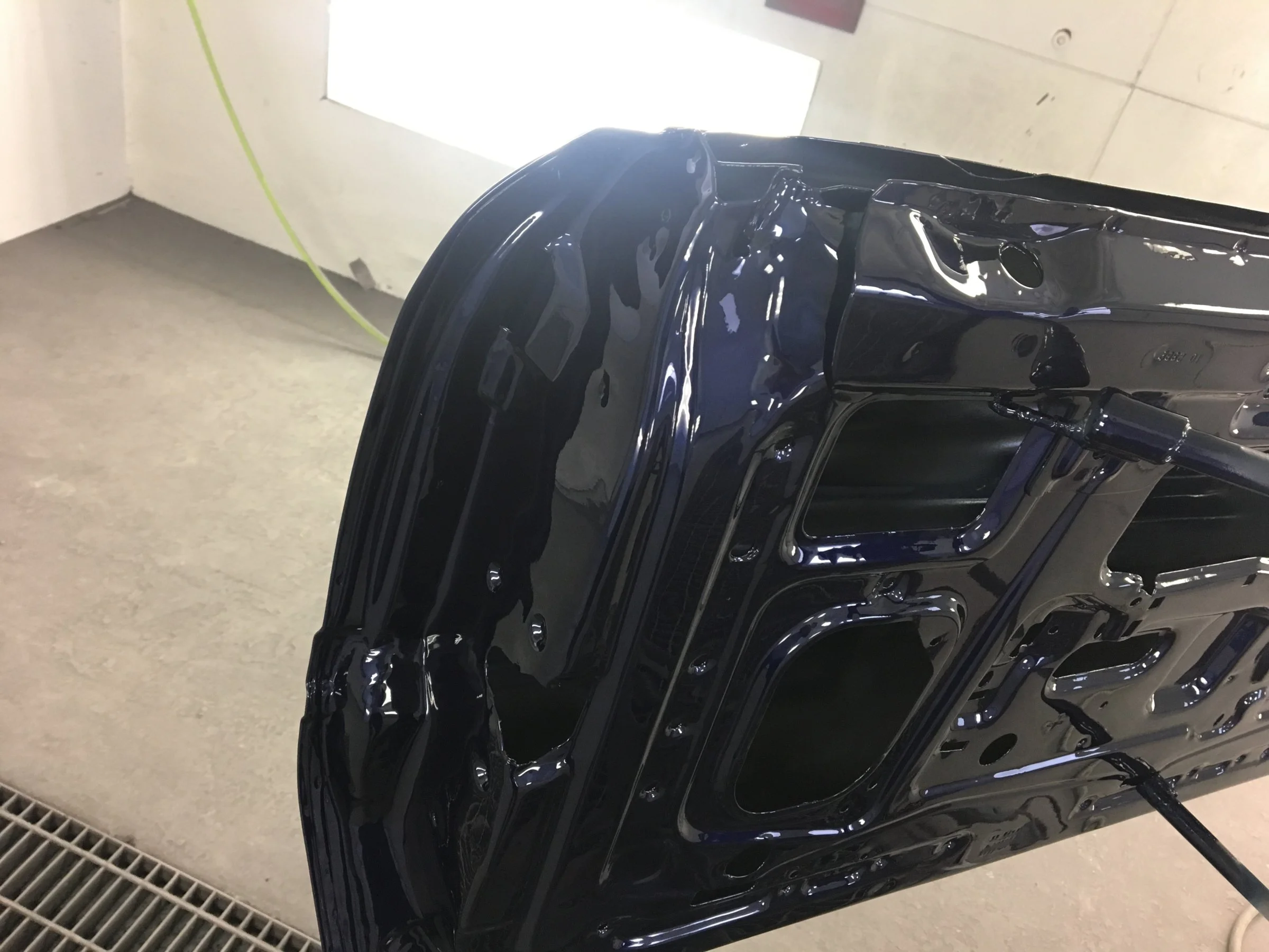

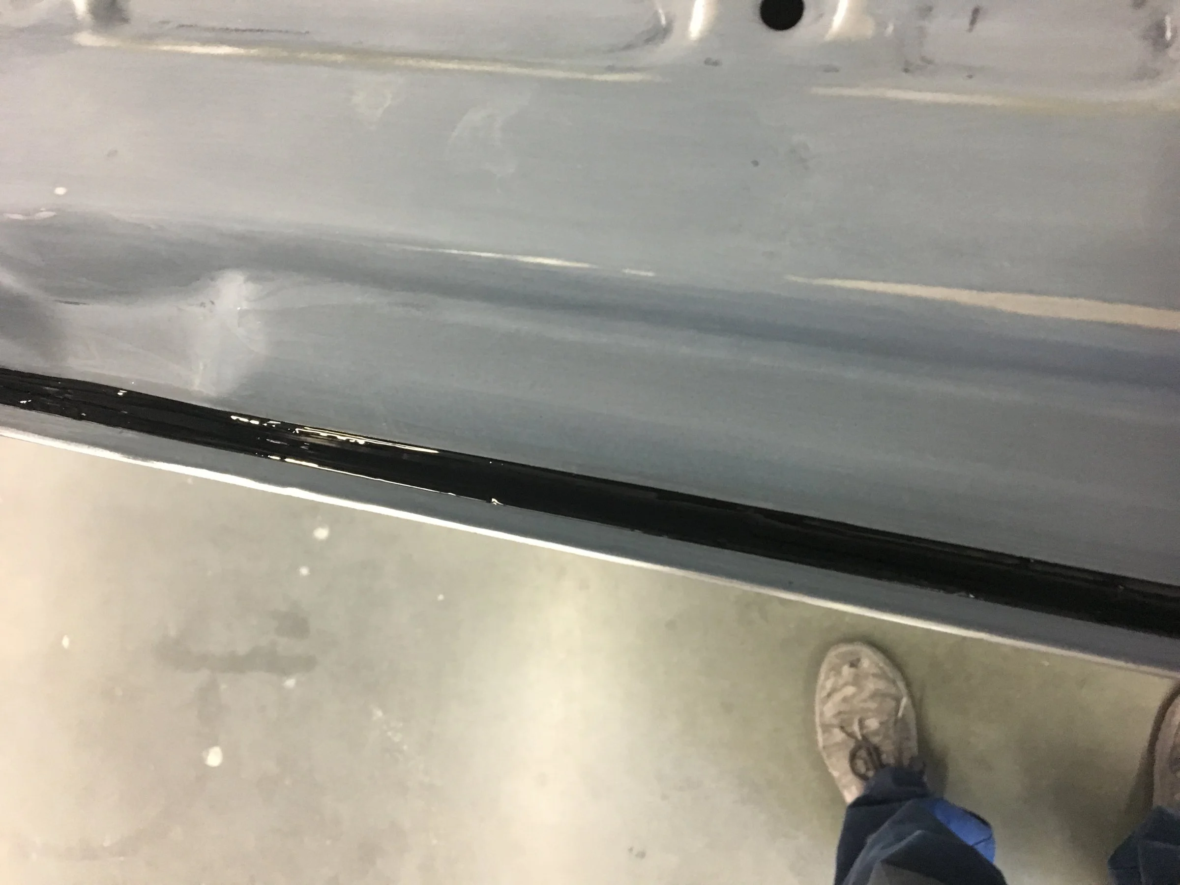

Got it seam sealed. I used a heavy body seam sealer because of the curvature of the door. Flowable ss would have run right on down that door.

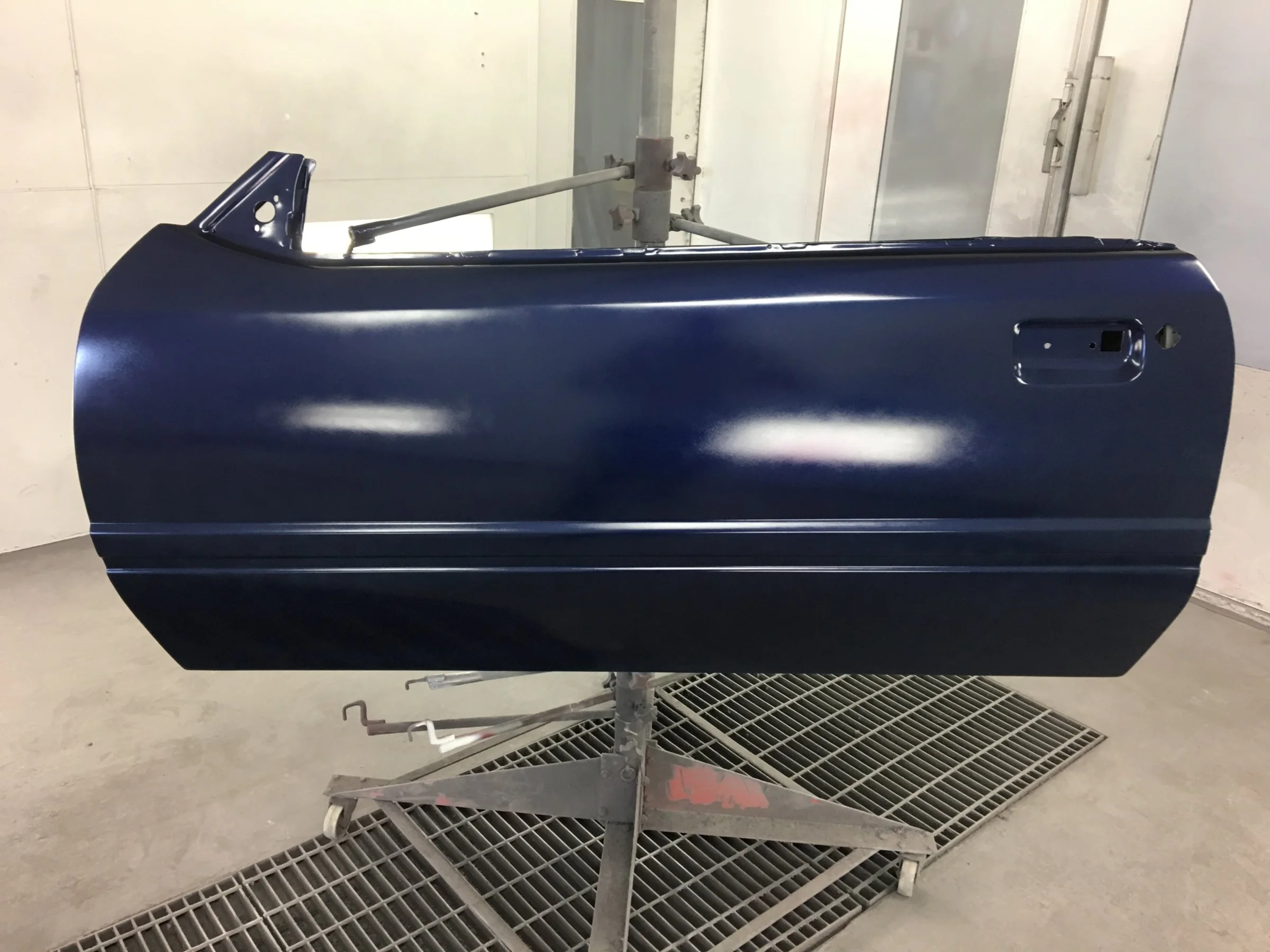

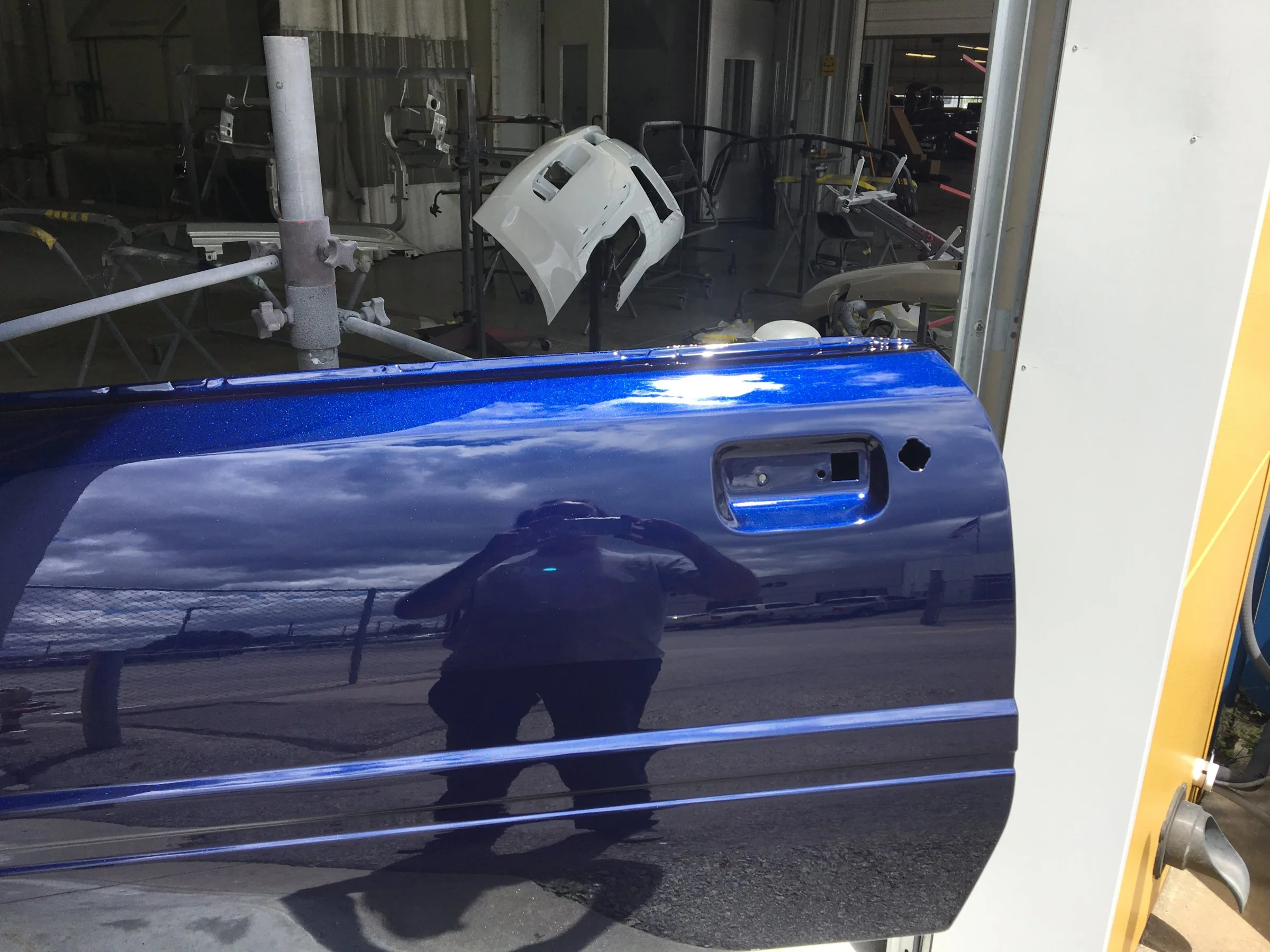

I'm doing something. One coat of base.

With clear, I'll try to get one in the sun, it's partly cloudy today.

Thanks man, that's nice of you to say.

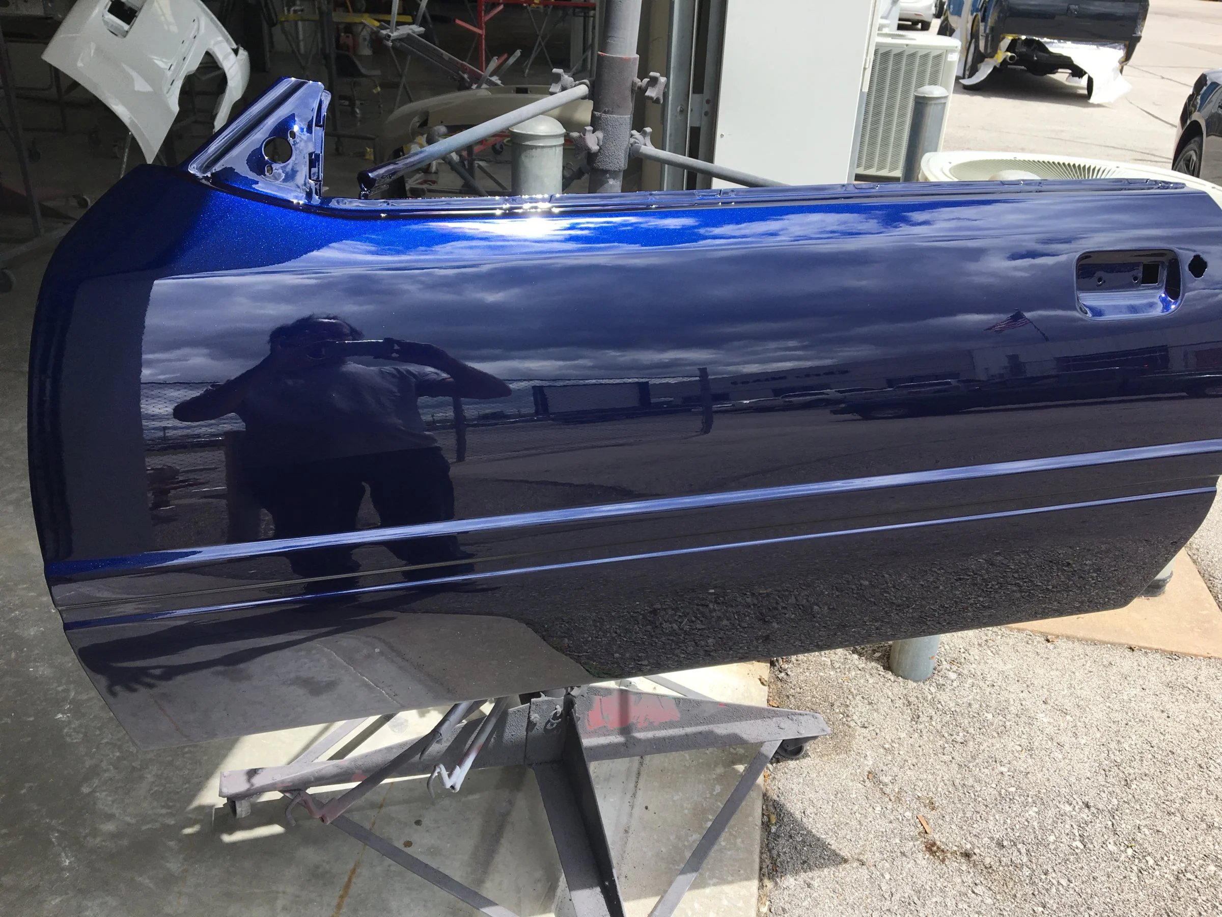

Here's a couple in the sun. Tough to get sunlight today, it's mostly cloudy. At least y'all can see the blue that I think is so pretty.

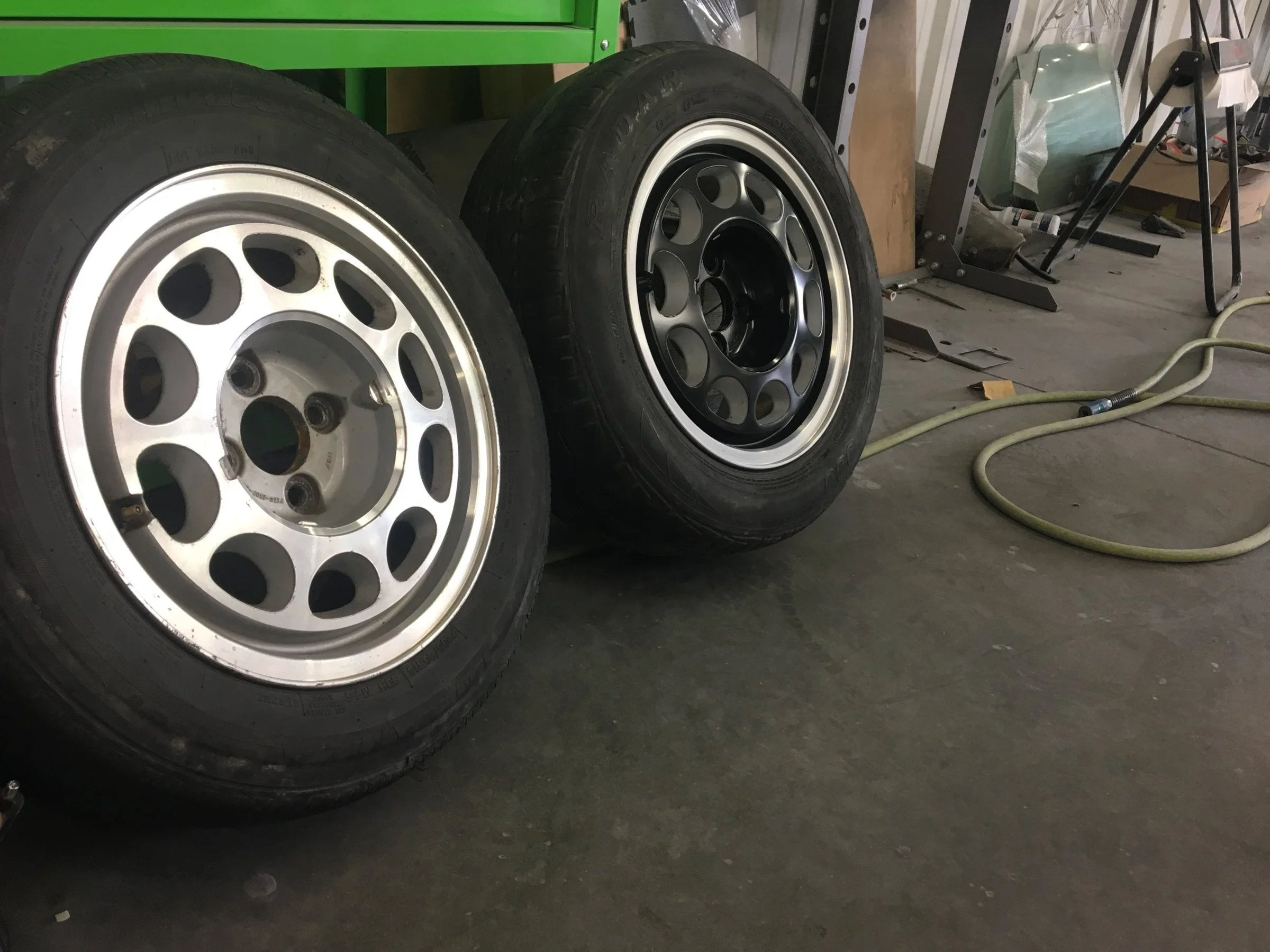

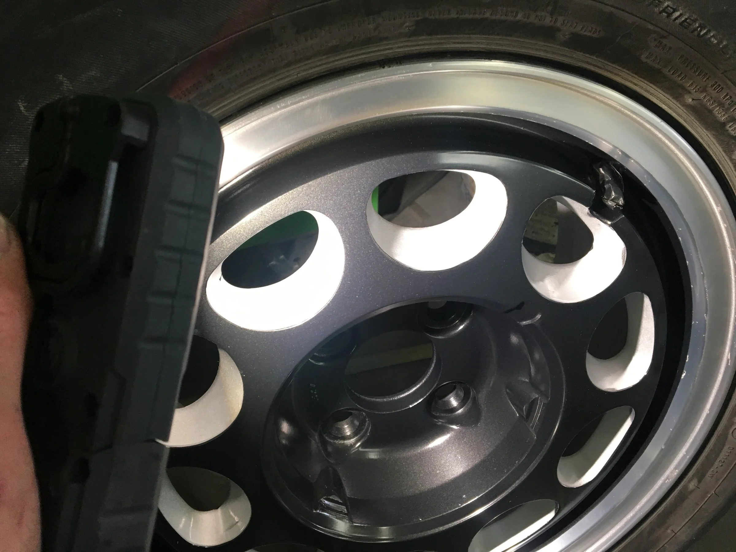

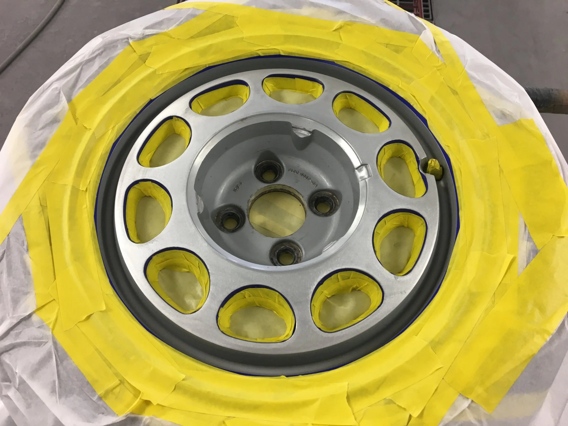

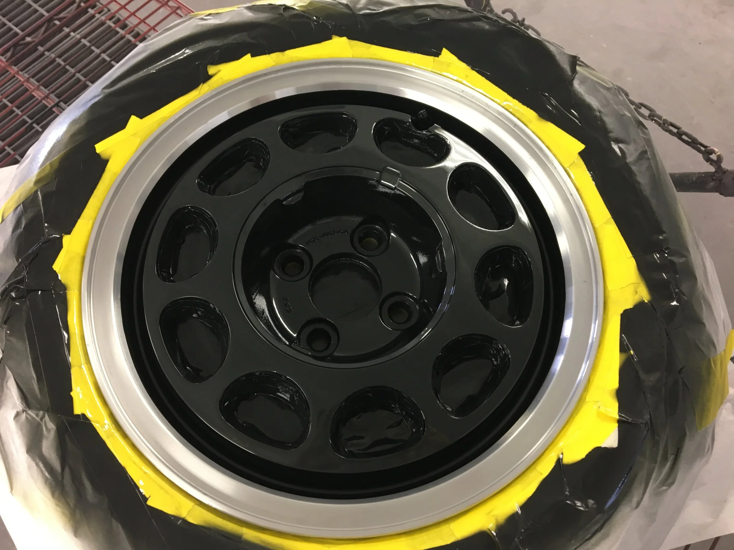

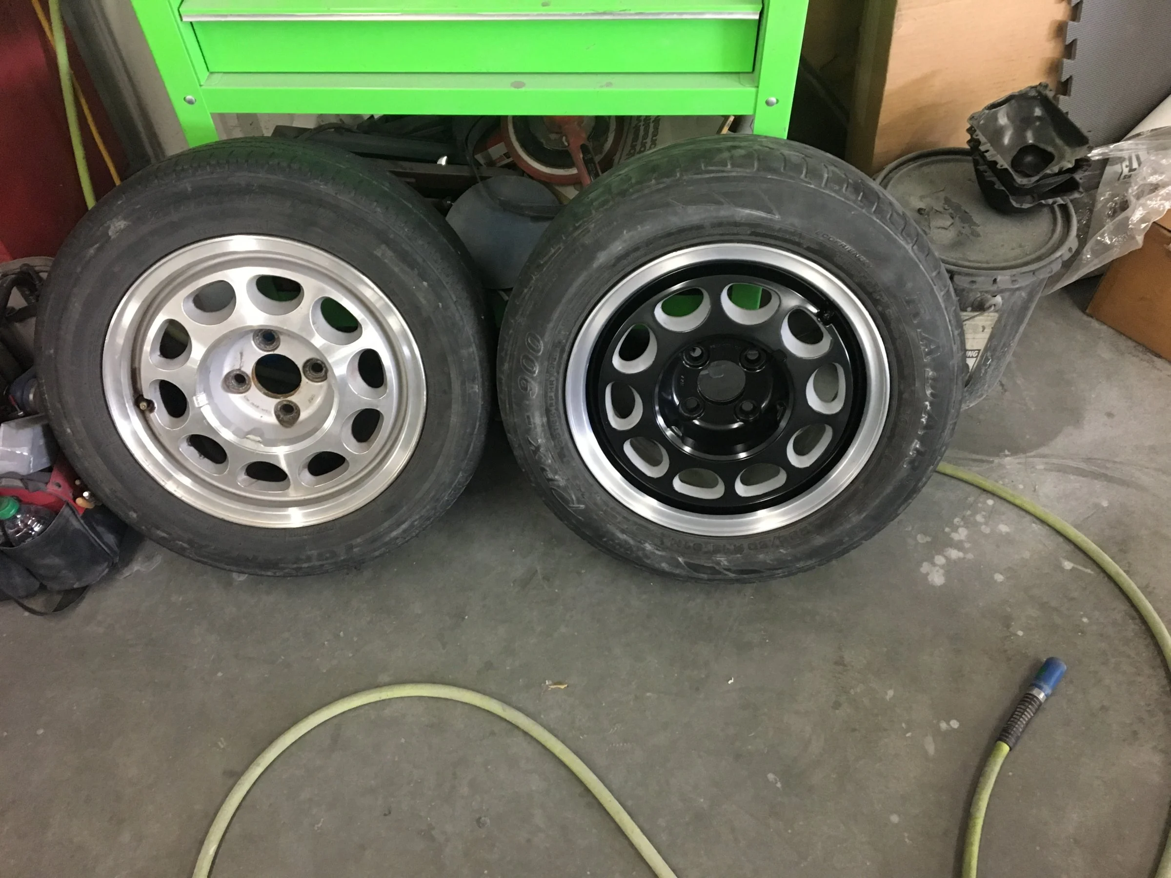

Something else today. I decided to try grey in the center of the wheel with a brushed look around the rim. I didn't paint the holes. I'm not sure how that'll look until it's done baking then I'll set it next to a nonpainted one for a comparison picture. I used a satin clear. It's just wet in the picture.
So, masked and then painted
Davedacarpainter
SN Certified Technician
Nov 28, 2015
11,833
11,634
203
Discordia
May 24, 2017
#334
  • May 24, 2017
  • #334
Next to another wheel.
What do y'all think? Should I paint the holes dark grey as well?
Picture with the sun lamp so you can see the grey.

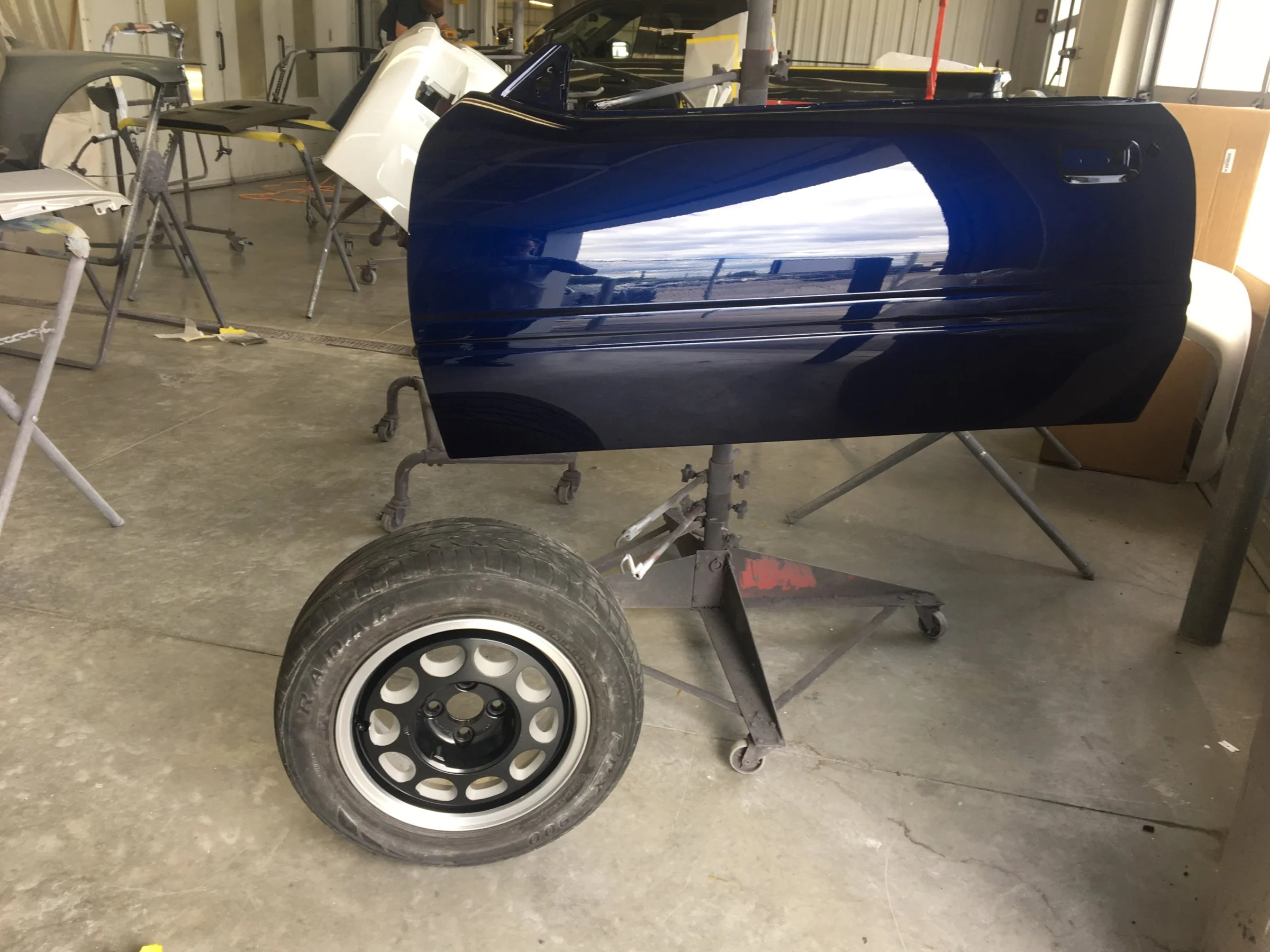

RaggedGT said:
With the sun lamp on it-I really dig the grey-my only concern is-in the shade/overcast/night-it looks black..
Have you done a side by side with your painted wheel and blue door? (Door looks Amazing .)
I'd vote either paint them kona blue or polish the holes lol.
First, side view.
Then with the door, I think I like it.

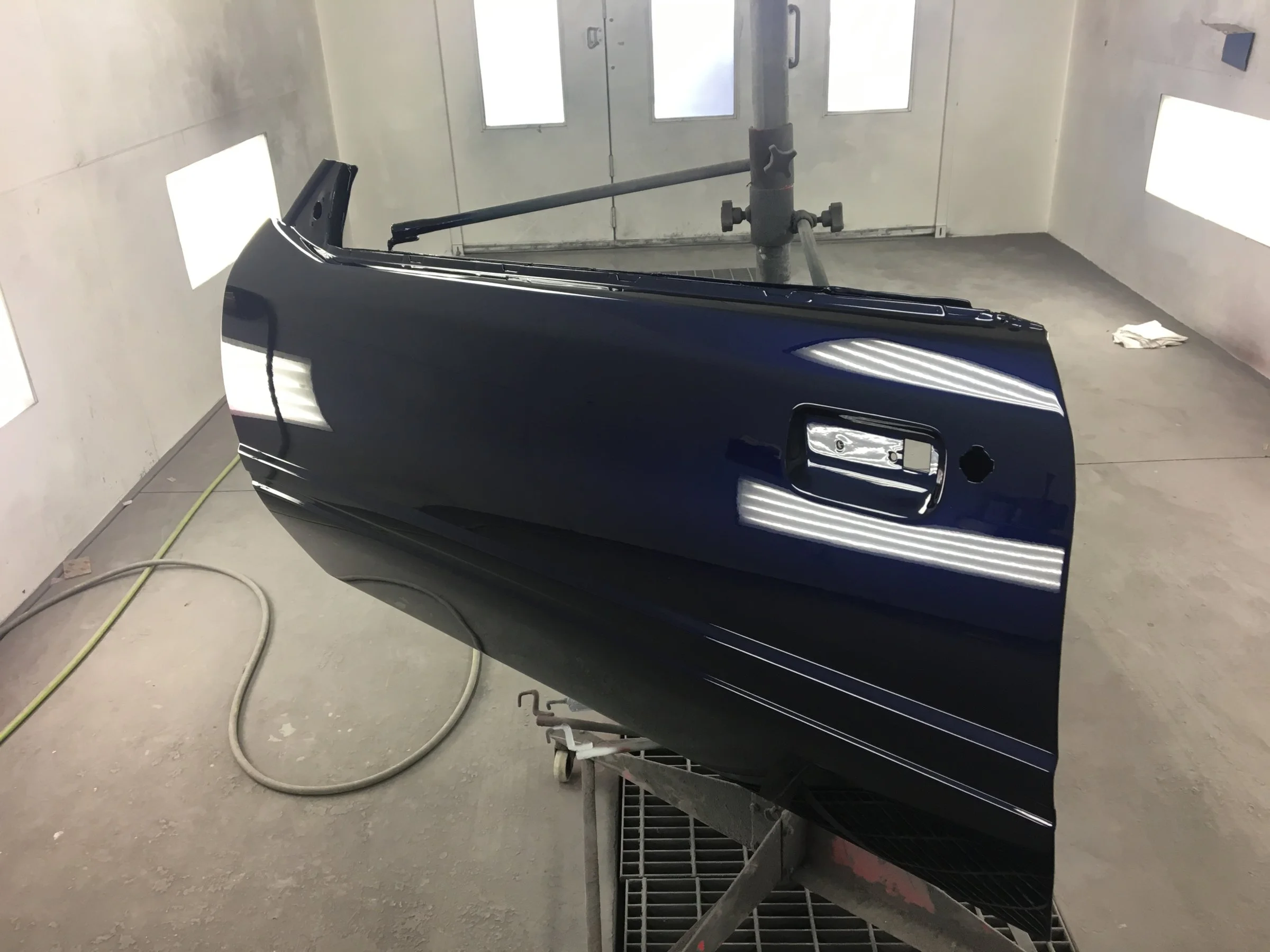

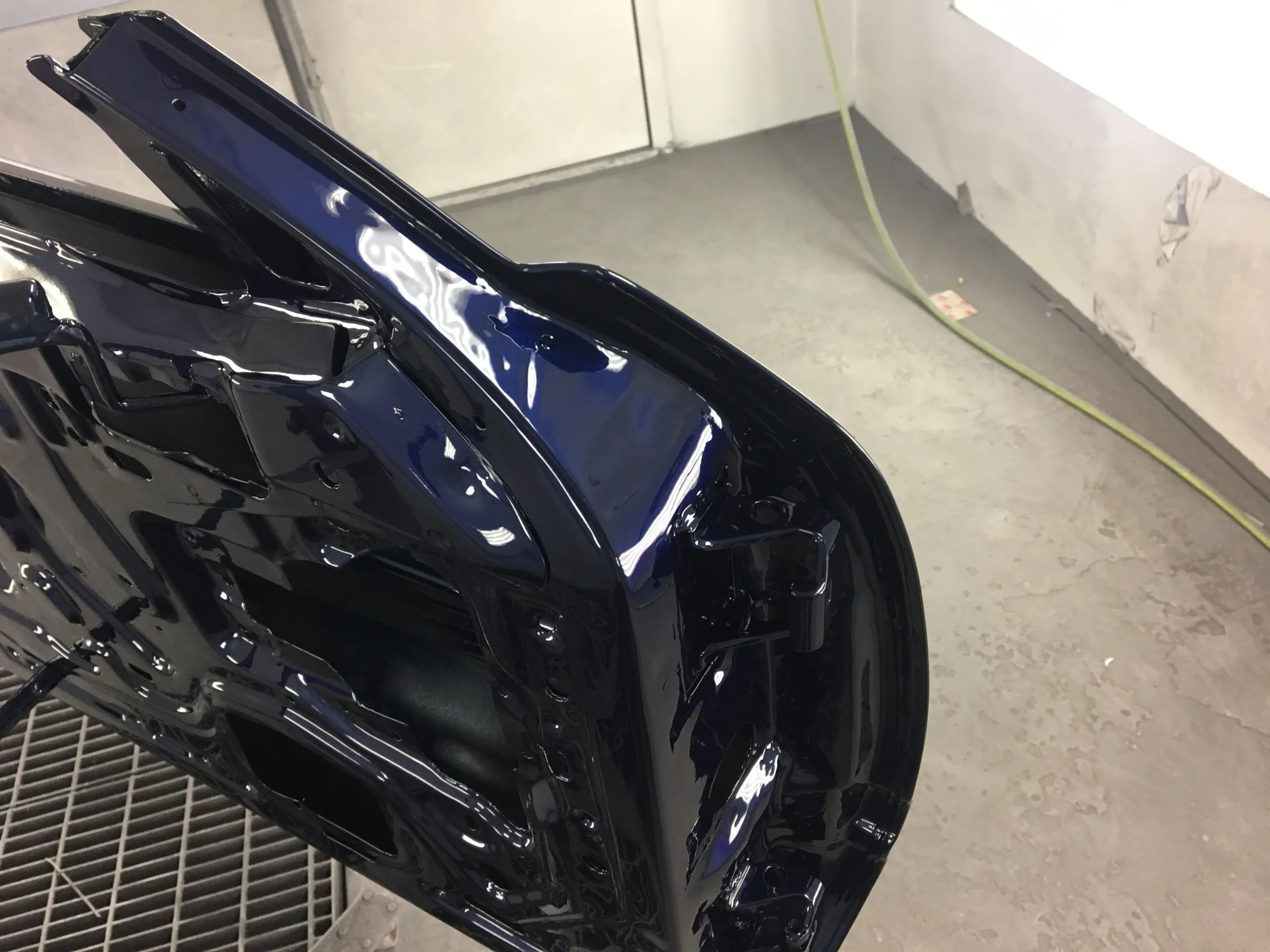

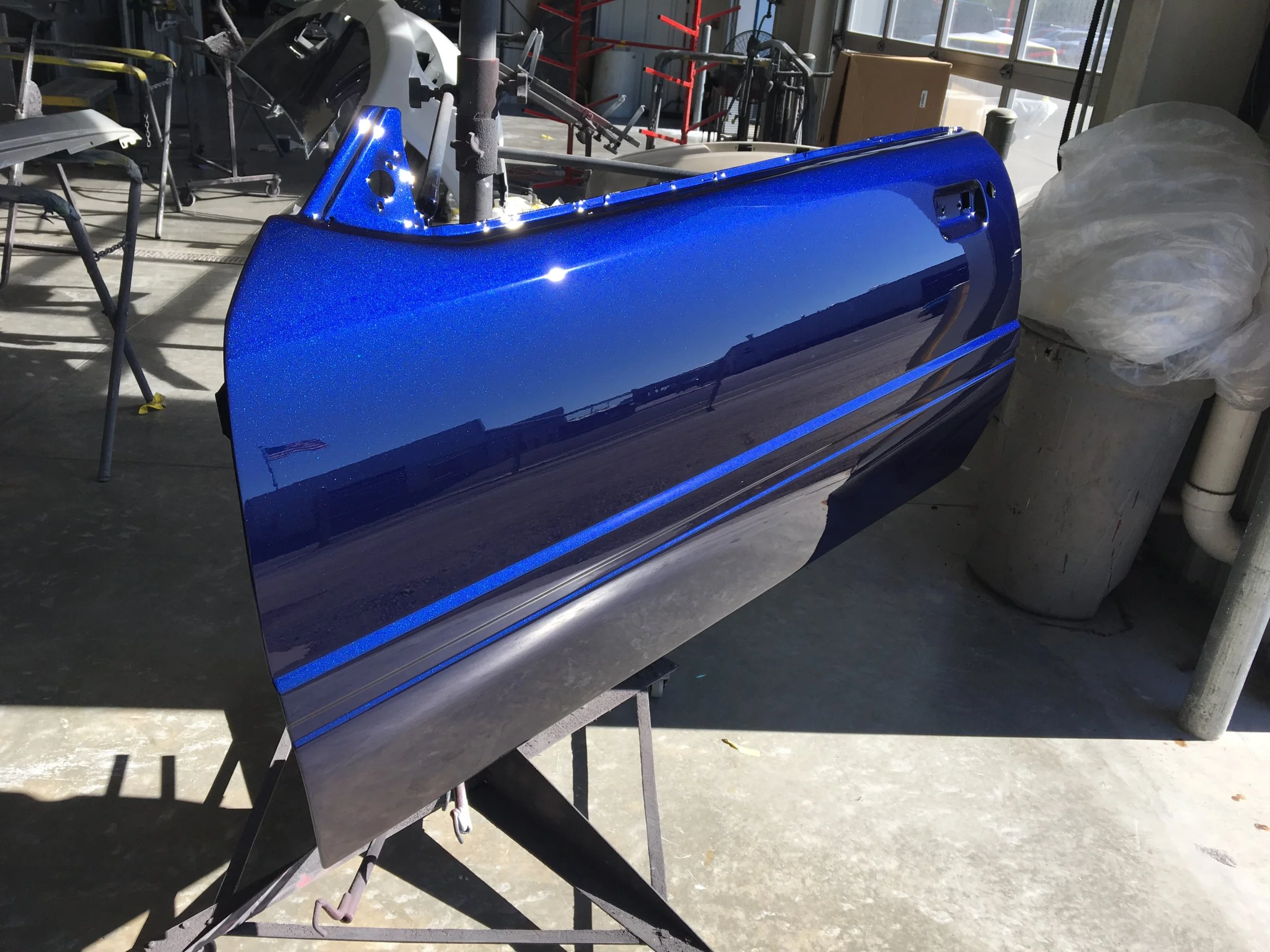

We have sunshine today, so I got a better picture of the door.
Before and after.

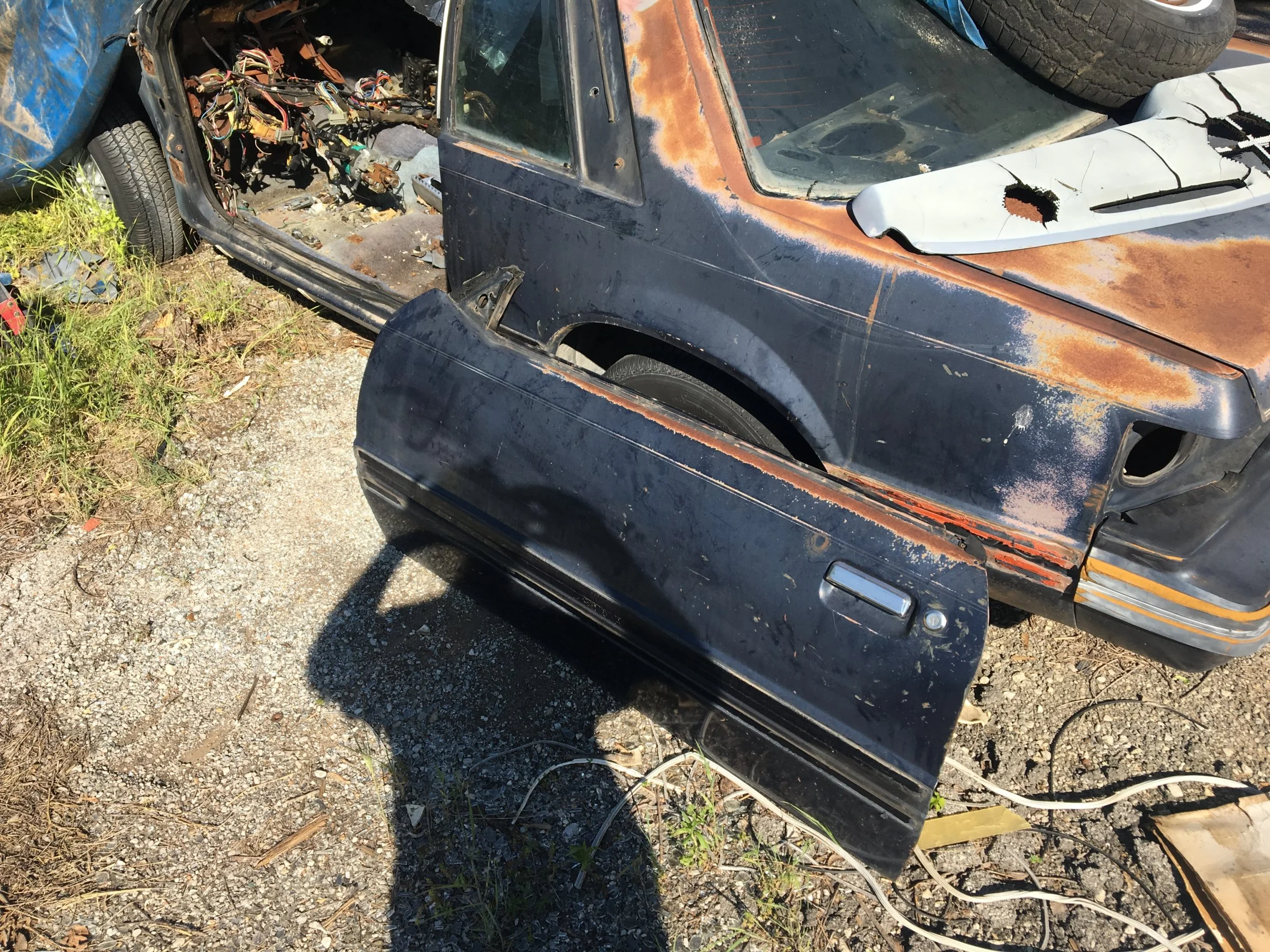

Alright, let's say my interest has been tweaked a little here concerning a super coupe engine.
I texted Danny (the yard owner where my blue car sits). I remembered he had at least one super coupe t-bird there. I asked him if he might be willing to part it out.
He got back back to me and said he has several and has one with a blown head gasket that he might part out!
So, I have a donor car.
He hasn't quoted a price for the drivetrain yet, I might ask him how much he wants for the whole car. If I remember correctly, didn't they have four wheel disc brakes?
Fact is, I think they had IRS. I need to do some googling.
