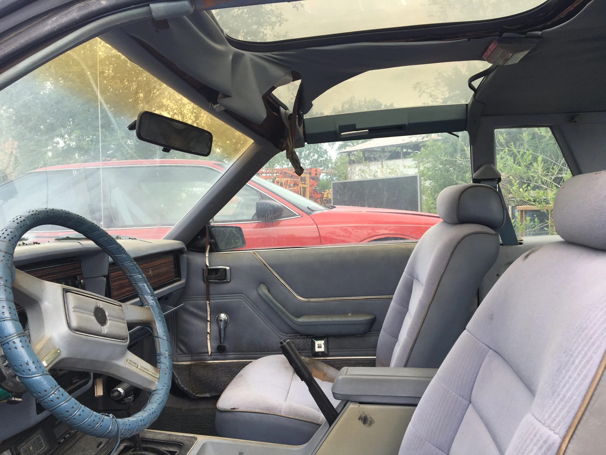

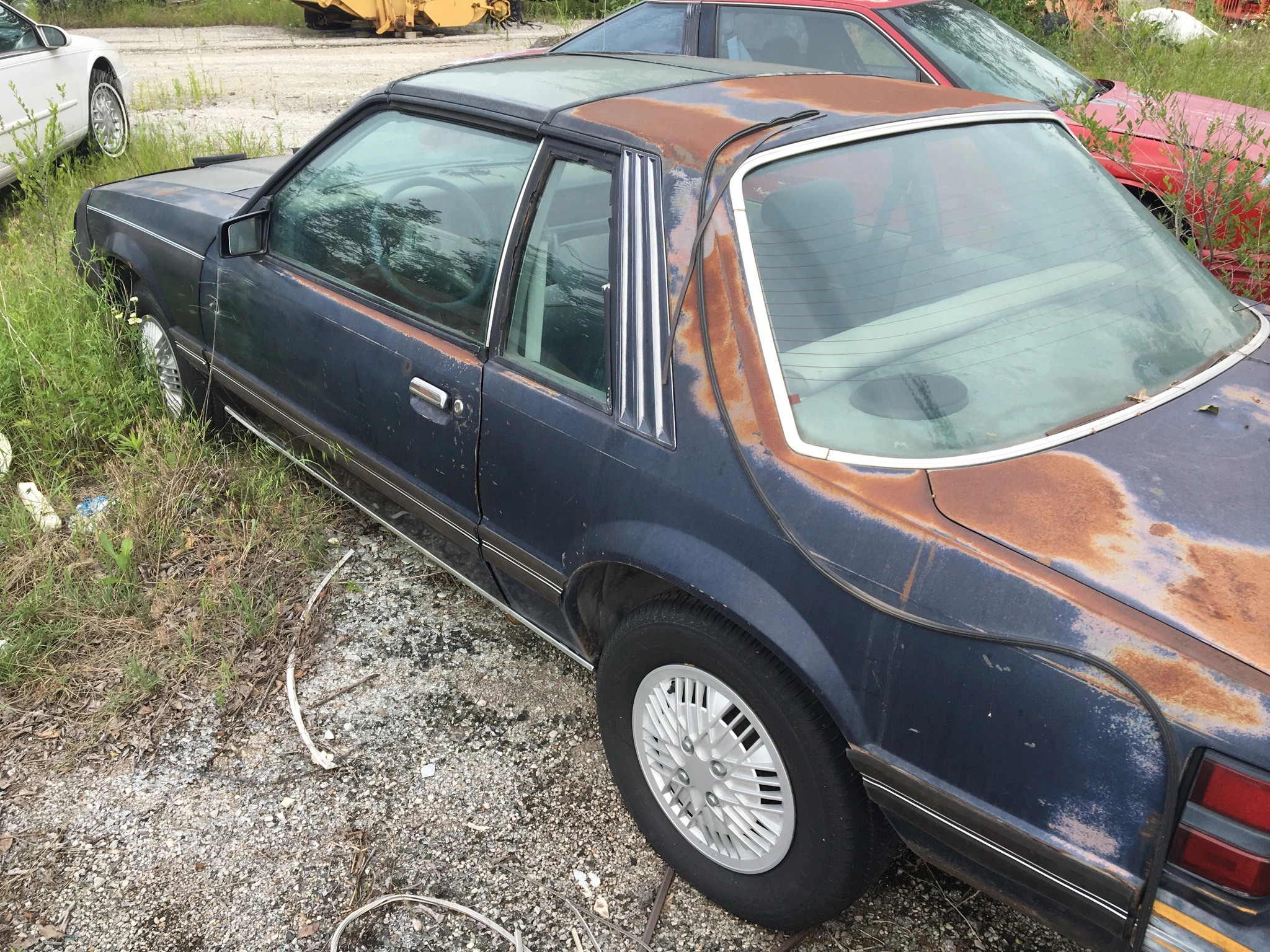

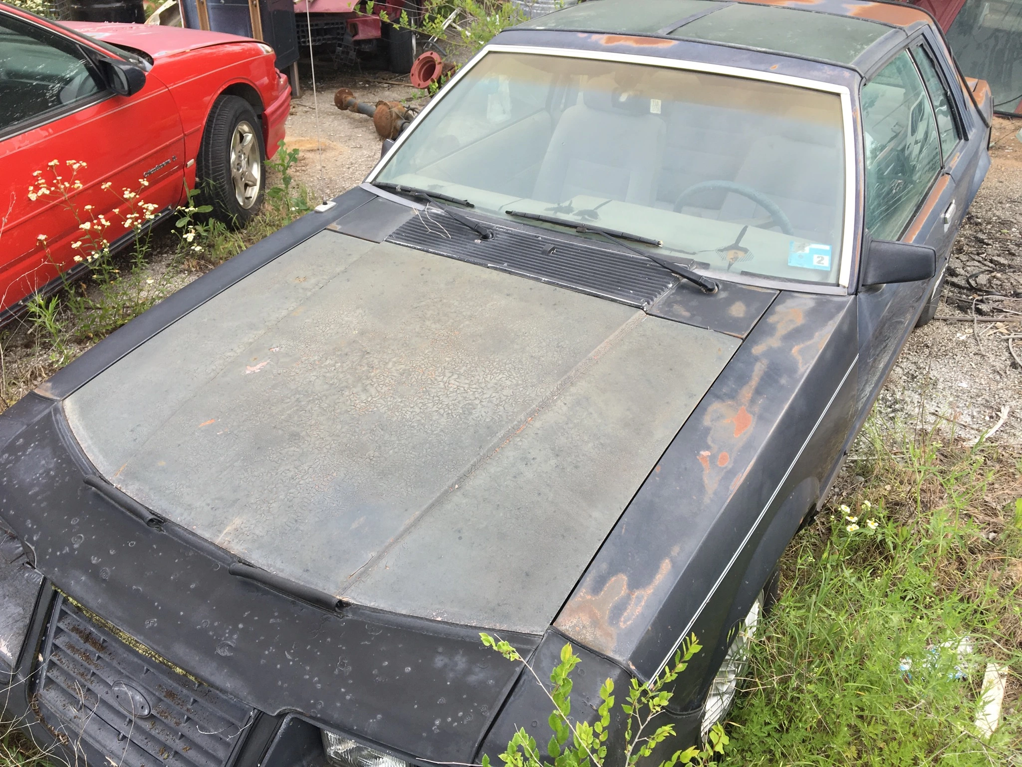

Robby (Rusty Old Blue Bastard) as he sits right now in the salvage yard still.

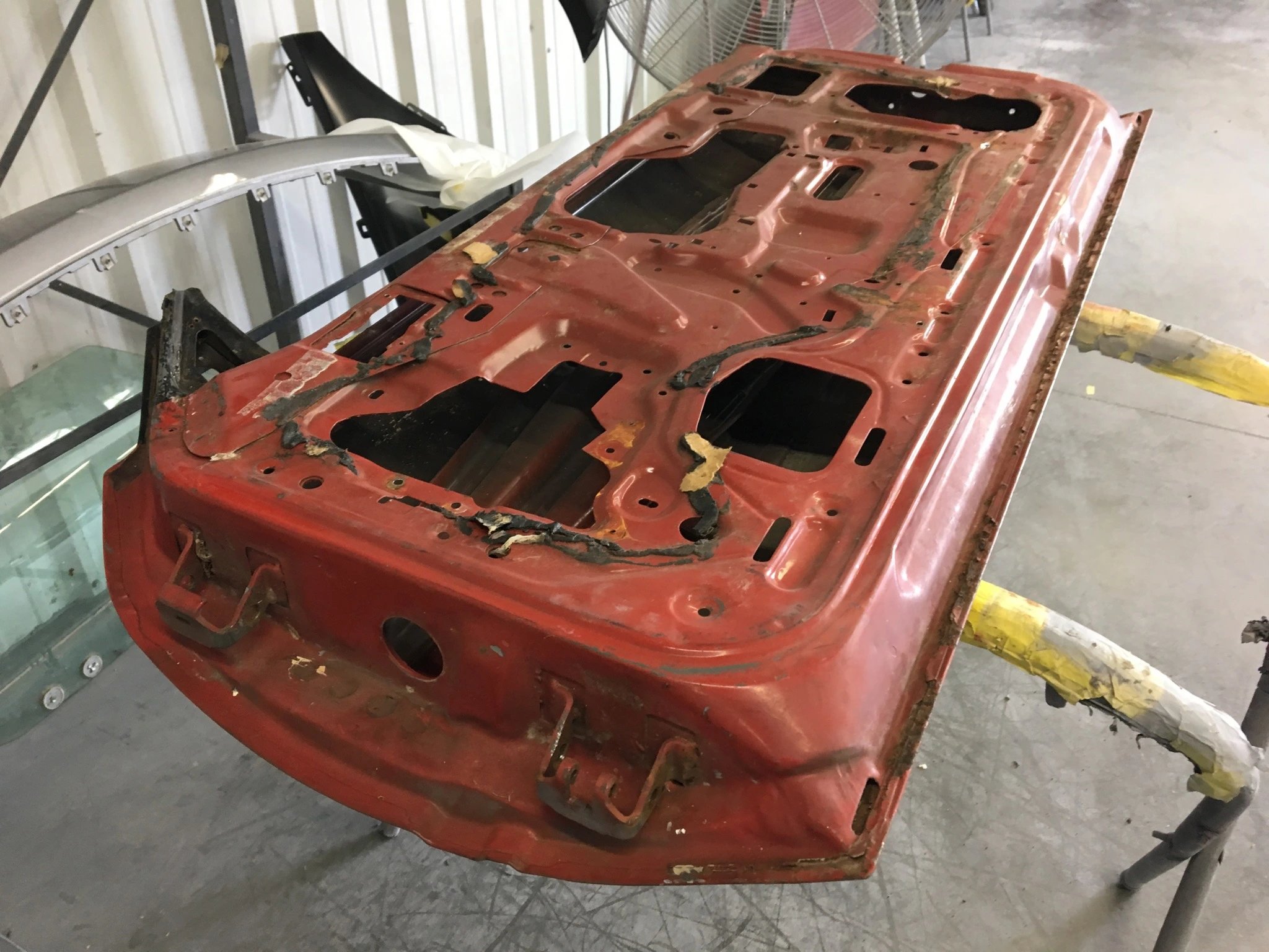

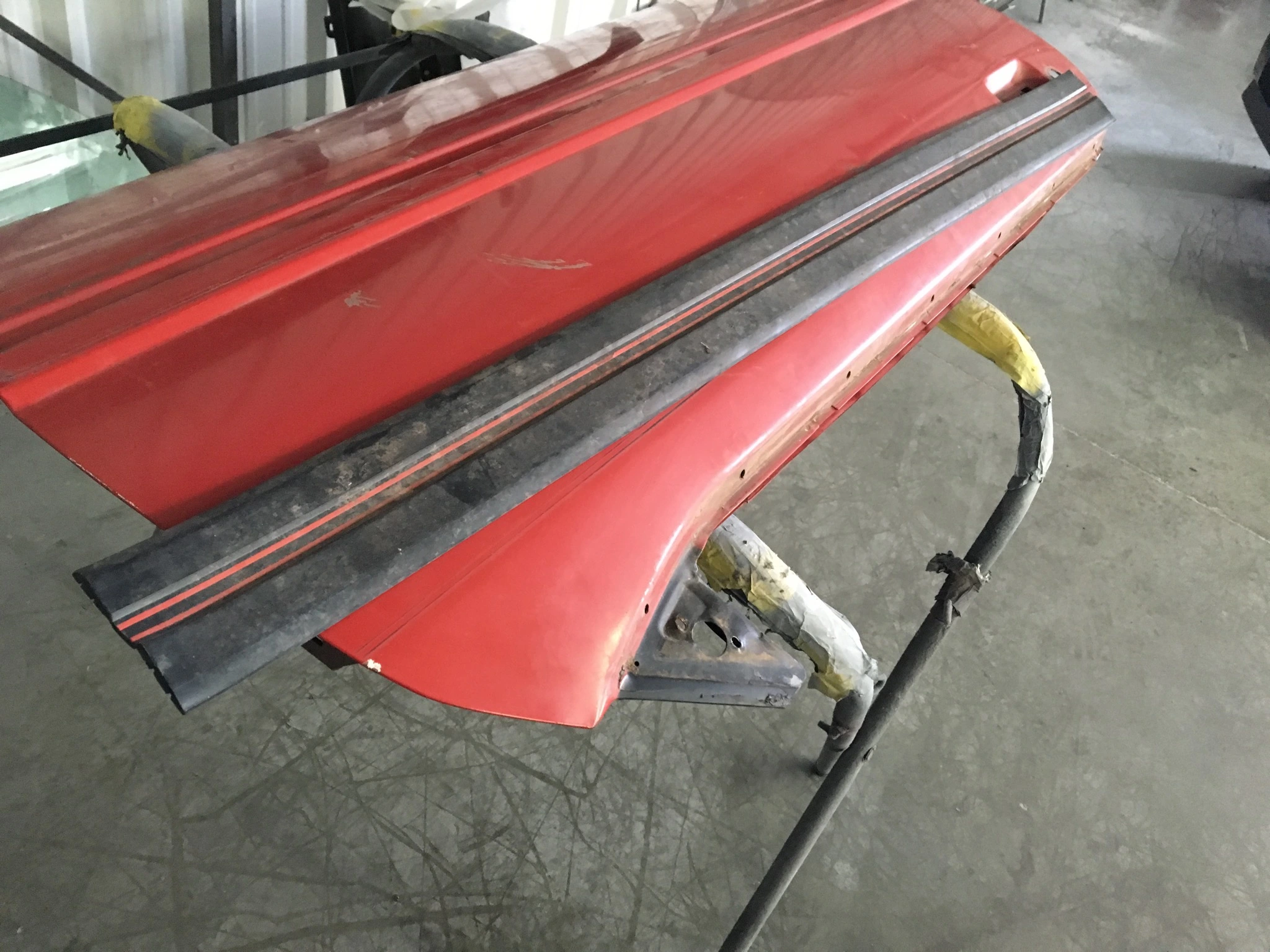

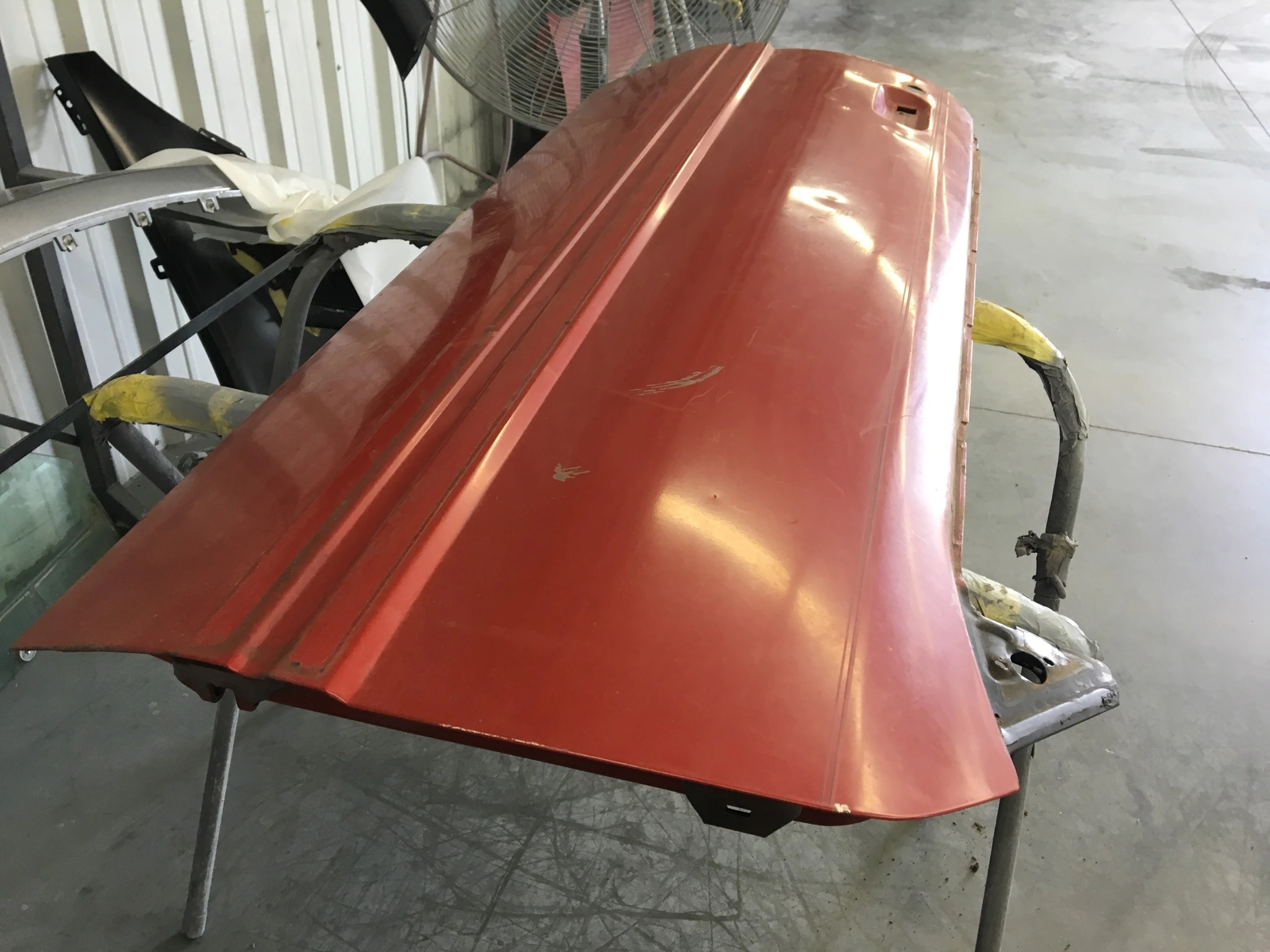

First purchase. Two "new" doors. I'm only going to work on the passenger door for now and put the driver's door into storage in case it's needed. This is the door after tear down, obviously. Notice the mouldings, they're in great condition. These mouldings are just about impossible to come by, it's like gold. Nice mouldings.......my precious.......my precious....
BTW, this is the second set of hinges that I've had to take apart. Both times I've had the door off. I will drink one tonight for you guys that have done this on the vehicle. I don't even want to know what a pita this is doing it on the car. That hinge pin must be a monster to remove in that tight crevice!
I will drop the door off with a good media blaster here in Broken Arrow (suburb of Tulsa). I'll have the front side blasted with ground up walnut shells and the back with sand. I will be using this company quite a bit in the next month, they are very reasonable in their pricing ($50 for the door).
Next Monday I'm going to pull out all of the door dings prior to taking it to being blasted. I'll get a couple pictures of the equipment I'll be using to pull those dents. If one is patient enough, one could do all of one's bodywork without bondo. This one will try to be that patient, One shall self medicate in effort to increase one's virtue in this area! Though I'm just going to glaze the bottom of the door to get rid of that factory wave that seems to be on all fox doors.

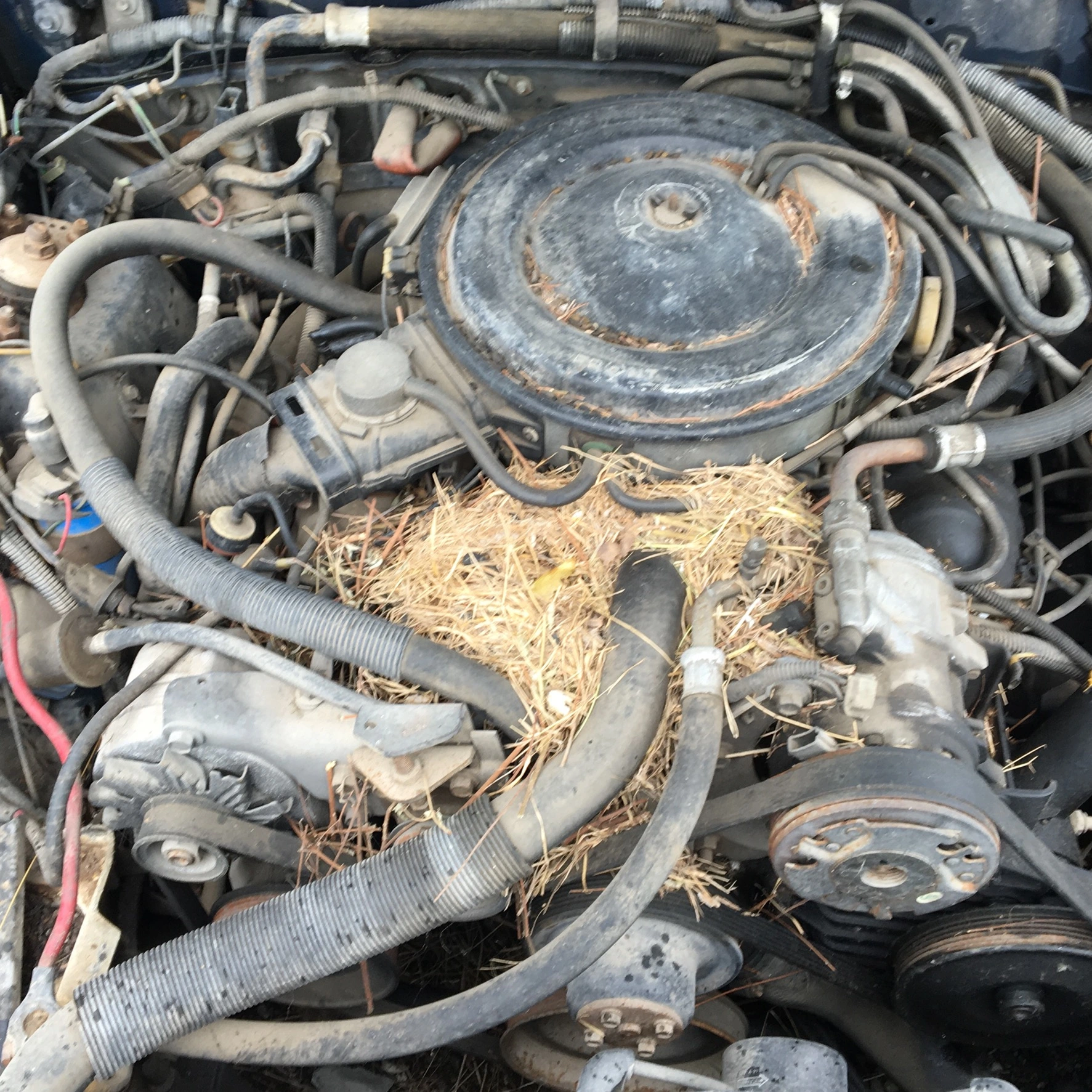

I almost forgot, the engine bay:
