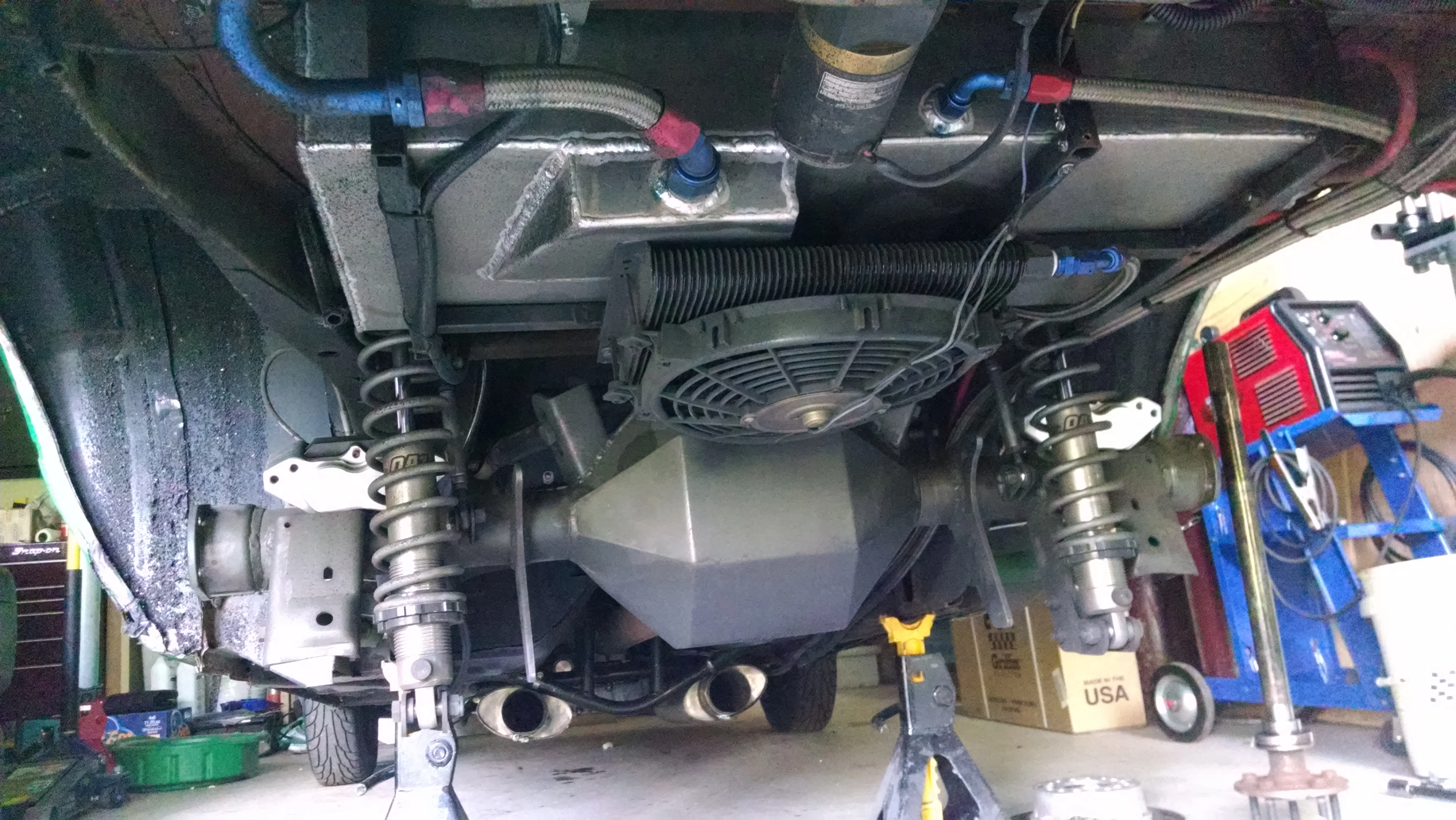

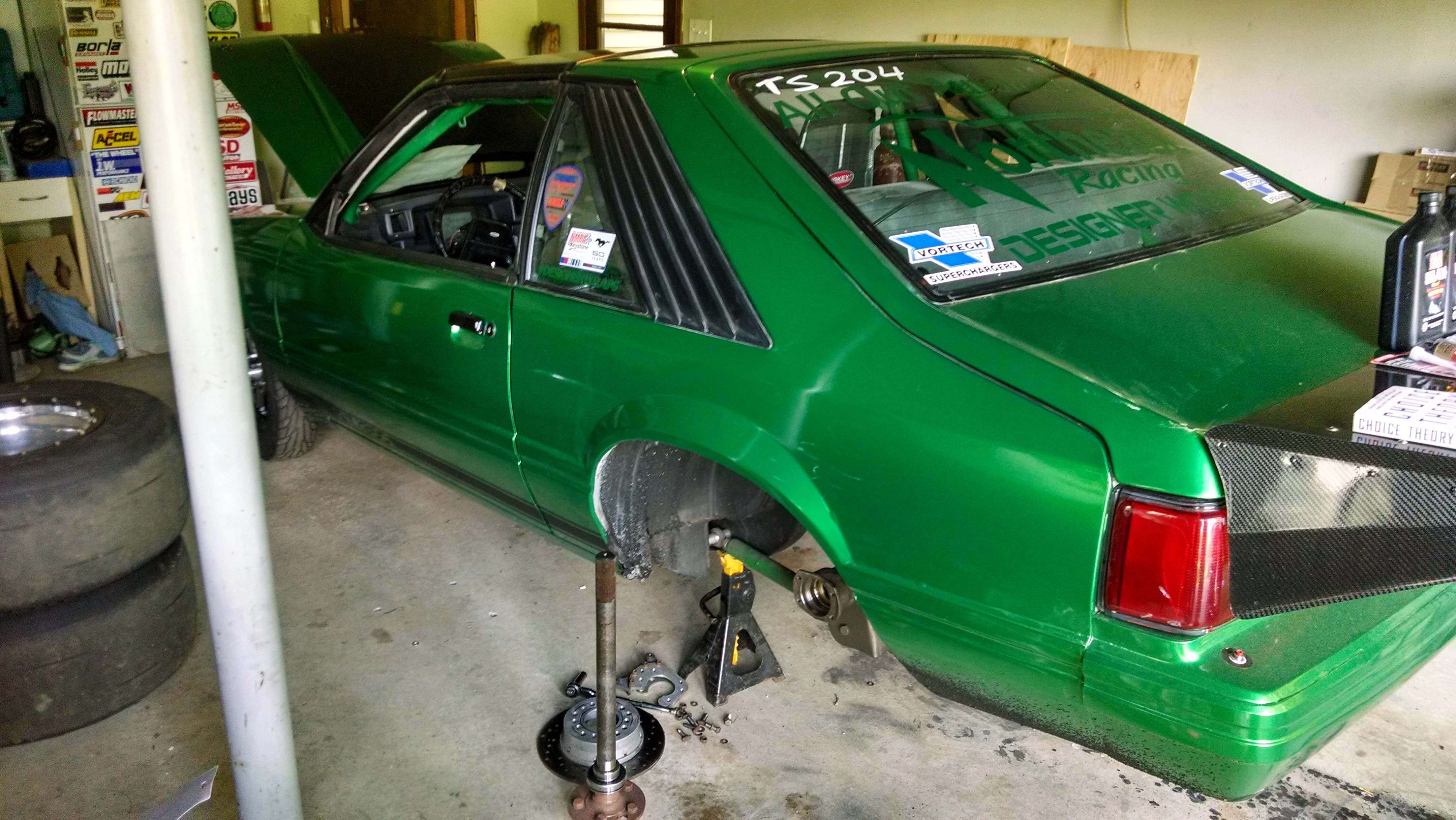

It's been a while since this was updated, so here I go.
After the last track outing and seeing 177 mph on the top end of the track we pulled the data logs and looked to see what we had. The tune up is still on the fat side and we have quite a bit of timing pulled out of the motor still. The rpms going through the traps were in excess of 8,650:eek:! I'm not cool with that idea, haha so a rear gear change is in order. When I initially put this car together it was going to run on 30" 315 drag radials. They are a thing of the past as far as I'm concerned and the 275 Pro radials is where the game is at. Going from a 30" to a 28" tire has a huge effect on gear ratio!! I will be swapping the 3.70 gears that are currently in the car over to a 3.50 gear. I was hoping to get my hands on a 3.45 gear but they seem to be forever back ordered and Richmand has been less than helpful. So here it is sitting in the garage being torn apart. Along with the gear swap I will also be changing the rear shocks to double adjustable units from AFCO. After this is all done it's back to the track to make a 7 second pass and then set the car up to run in X275 trim and hopefully squeak out some 4.8x's in the 1/8th mile. More updates to follow in the coming days...
The undercarriage...
