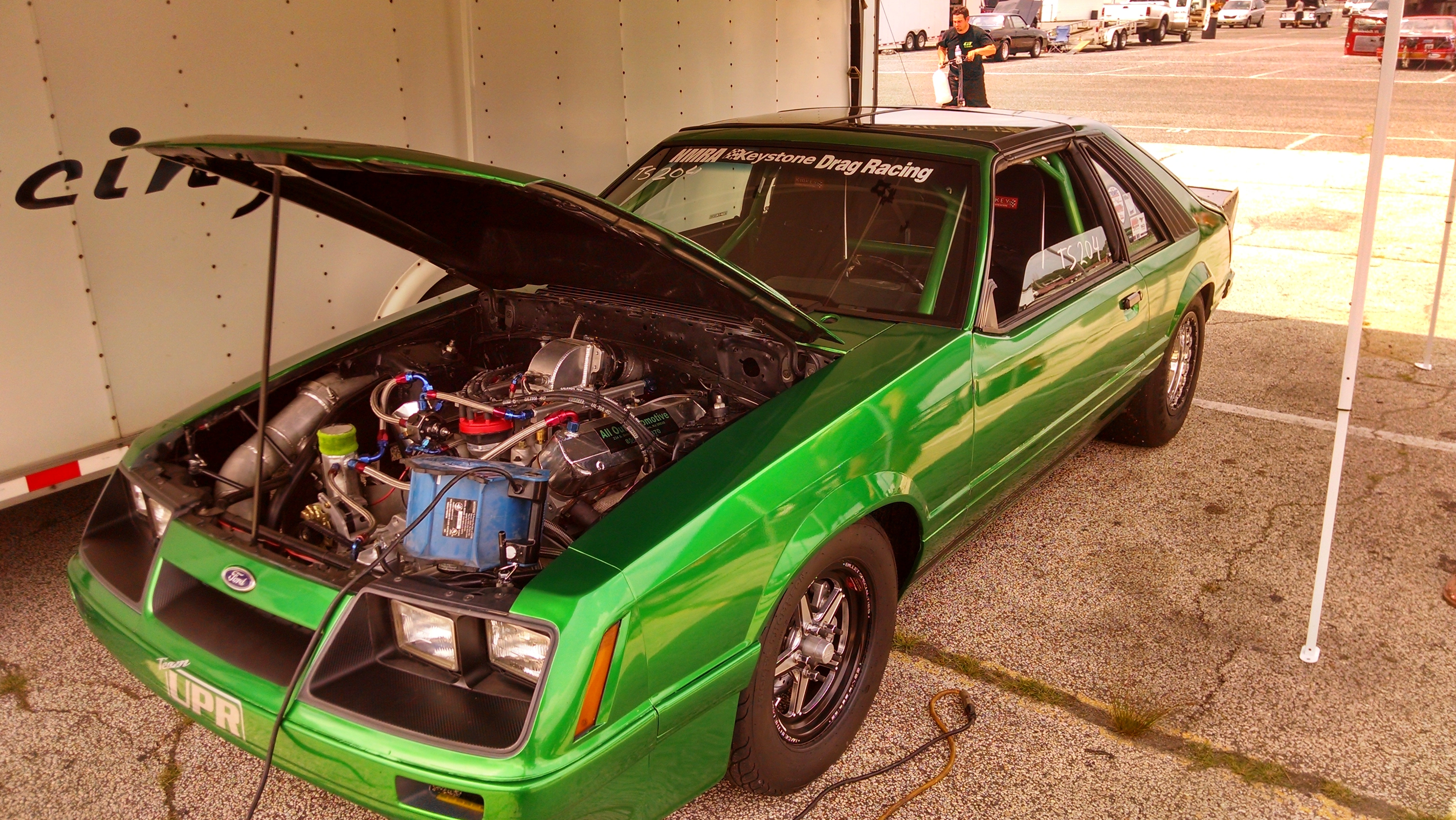

This was from the pits yesterday:

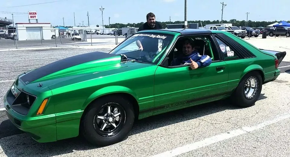

This was taken by the track, That is Kris driving and yours truly on the other side of the car:
A few new questions. What was the reasoning for choosing the CDs geardrive over the others? How cool does the engine stay on the street with the radiator mounted like that? Have you thought about going to the dark side and putting a turbo on? Who's elbow is that? Think it would clear stock hood 8.2 based? Just some things I am currently asking myself and your already doing it all so figured I could ask you! Thanks
1.) The reason for the CDS drive. Plain and simple, I think that the design is far superior to the SuperChargerStore. They include a lot of nice features that they other brand doesn't. The built in alternator mount was a huge plus! I also really like how they doweled the entire assembly together unlike the SCS. I met Chris Alston at PRI last year and he really worked closely with us to get everything spot on and that in it self goes a long way with me. If I had and questions he would call me personally to answer them and truly was a resource. I have friends that run the SCS drive and after seeing both in person the quality of the CDS is paramount. That being said, I haven't had any experience about the ATF drive and can't comment about it.
2.) With the radiator mounted the way it is and with a 2,000cfm fan the car stays reasonable cool on the street. It actually stays cooler in traffic than cruising, I think due to the lack of air flow while at speed. After the 30 mile true street cruise in 85 degree weather the car would idle at the stop lights right around 200 and never exceeded 220 while driving. I have another identical radiator and fan that I can mount on the opposite side if I would like to double the cooling capacity. I just haven't found the need for that yet. For what it's worth, I have no thermostat and just use a 3/4" water restrictor currently.
3.) Have I thought about a turbo... Not at all. Vortech has been nothing but the best to me and I would never consider not having one. They make a super reliable product that makes killer horse power. I have yet to see any brand turbo out last one of these Vortech units. Even under spinning my current setup we easily made 1,442 rwhp @28 psi. The efficiency from a centrifugal supercharger will far exceed most comparable turbos and a turbo just won't ever be for me :)
4.) The elbow was made by Aaron from http://6061.com/ I gave him my specific requests and he quickly turned out an awesome product for a very reasonable price
5.) This setup with my 9.5" deck motor will clear a stock hood in my car. I first had Holcombs drop mounts before the motorplate and we did successfully test fit a stock steel hood on my car with zero cutting!
As your questions arise, please feel free to ask! I would be happy to help, even if I can save you even the smallest amount of hassle or aggravation.
