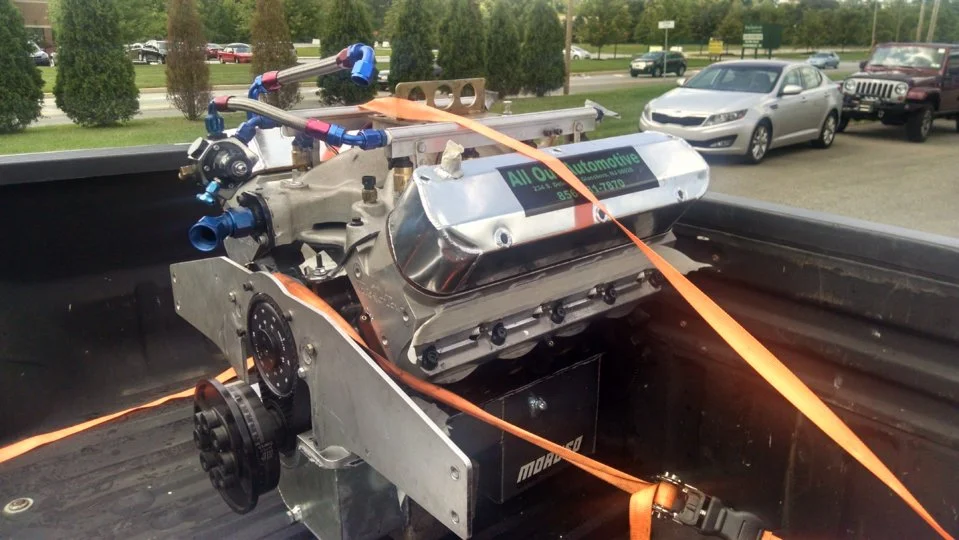

Well, I have answers. How is that for efficiency lol.
The Jesel cam gear actually broke. I'm waiting to see what Jesel has to say about it as there isn't a lot of run time on this belt drive setup. Either way, it could have been so much worse. One intake valve and two exhaust valves are smashed along with a few bent push rods. Believe it or not, the longest lead item is head gaskets. Cometic makes every single gasket to order and that takes 5-7 days. The top end is completely torn down and the heads are already disassembled. The parts have been ordered and it's just a matter of cleaning a few things up and waiting on parts to re assemble the top end. I'm hopeful to have it back for next weekend. Luckily it was one of those no big deal type issues. On the other hand, if this thing came apart during a pass and was spinning 8,500+ rpms it would be a whole different story!

I'll be sure to post up once I hear back from them. The machinist is going to call them, I would probably just yell over the phone haha. I've used their products for years and years with no issue. I'm hoping it was just bad luck on my part and I wound up with something defective.
