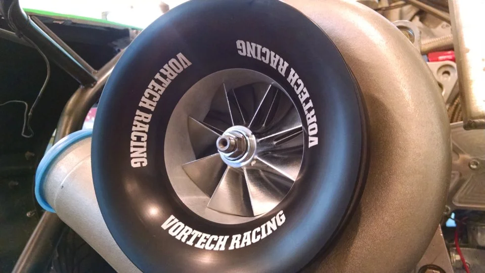

In other news, I recieved a package from the UPS man yesterday that really made me happy. The new Billet wheel V27-YSi is here and ready to rock and roll.

Lol, I should have taken a side by side Xb105 vs YSi, the new blower is so much smaller than the one I took off. Fingers crossed we nailed the combo and can still lay down some big power

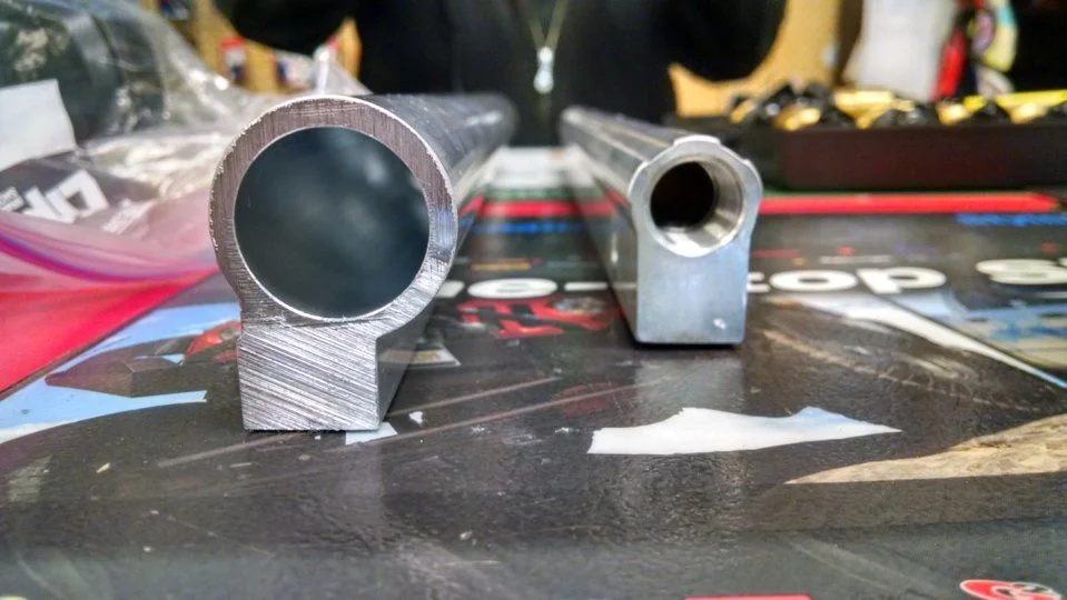

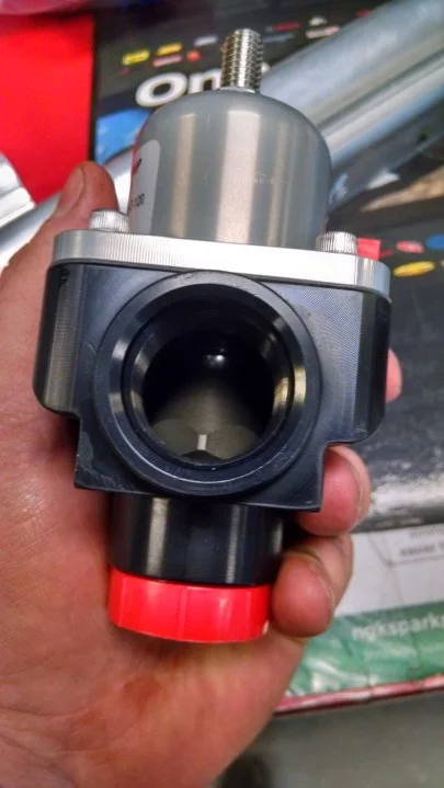

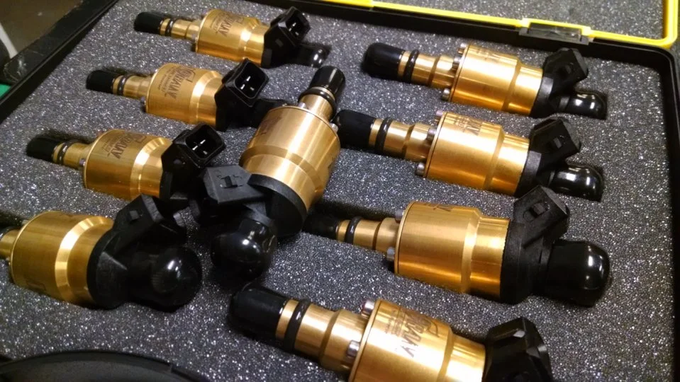

New Fuel Pressure regulator and Fuel Rails showed up and they are a little on the huge side... The -8an fuel rails won't cut it anymore and Mike Moran had recommended these -12an fuel rails. I'll be drilling the injector ports tomorrow night as well as tapping the ends for the oring fittings. I had to order a 1 1/6-12 tap just for theses rails.... One more tool to add to the collection of things I will only use once in my life. The new 500lb injectors showed up as well... Whoot Whoot almost go time!
I can't thank Mike Moran enough for sponsoring our racing program this year!! Top notch guy who is truly the best in the business!

why did you chose to tap the rails rather than just weld the fittings on?

Typically I wouldn't think twice about welding a set of bungs on the rails, the one thing that has me concerned in this instance is the fuel being methanol. I know that it's not good for aluminum to begin with and if the welds aren't 1000% it could wind up being a bad thing not to mention that methanol if it were to catch fire burns with no color to the flame making it even more dangerous if there was a leak. On top of using methanol, the fuel pump is straight gangster... It flows 12.5gpm's at 100psi and it will see every bit of 90 lbs of fuel pressure or more under boost. The adapters were 6$ a piece and I had to buy the tap, it gives me some piece of mind I guess, lol.

I don't even want to guess how much those babies cost. Probably more than my entire car..lol

I think I would have to frame the picture of the injectors and the supercharger. A heck of a lot cheaper and just as sexy as the pin ups. So what are you looking at making when it all gets together?
