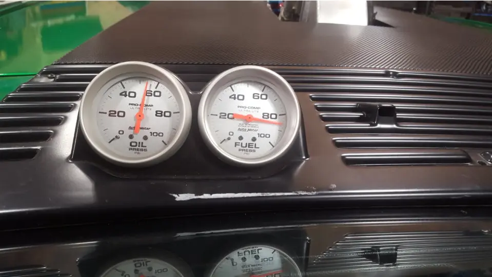

And just in case you were wondering, this is the oil pressure and fuel pressure at idle
The needle bounces pretty good on the fuel pressure due to the mechanical pump. It averages 90lbs of fuel pressue at idle :)

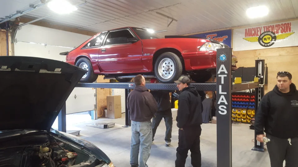

On a more serious note, my car is done and we had intentions of dynoing the car last night... That didn't happen. I pulled some interior out of the Cobra, fixed a small transmission leak on my buddies hatchback and we dyno'd 2 other cars instead. The night wasn't a total waste though. We bbq'd inside the shop and used the 84' as a picnic table :stupid:. Some times you need to put paying work ahead of your own... I still need to pay to keep the lights on somehow I guess :crap:. In the most blasphemous moment of the evening we had a 2008 corvette get dropped off for a blower install, really there is a GM in the shop :scratch:weird...

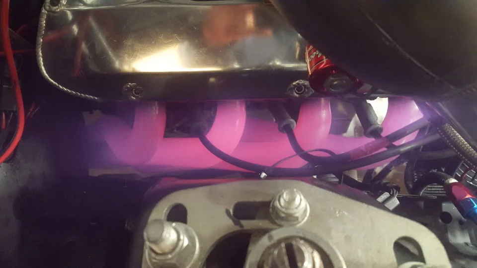

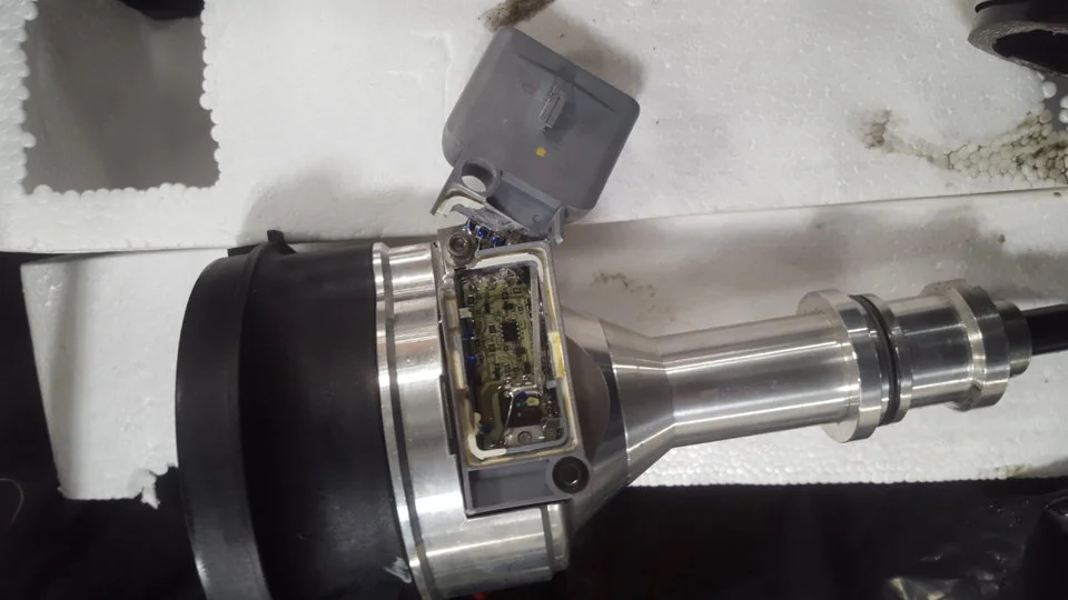

I also need to post these pictures... People are classic, they never cease to amaze me! The one car we dyno'd last night has a PMS and was "self tuned". Check this shot out after a 5 minute drive on the dyno about 50mph, think this is bad?
Car came in like this, obviously the issue was resolved by the time it left. The fuel tables in the PMS were not even close, this = scary for sure! :flame:
This one was on the other car, it kept dropping the spark out. Honestly I don't know how it even ran... There was some tape holding it together :nonono:, this was under the tape :banana:
A stock ford module fixed her right up though.

A little lean was it? Lol.
