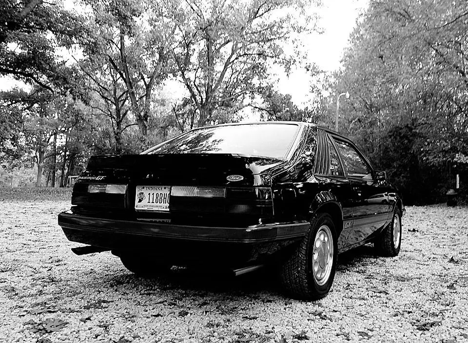

49,000 miles and I am original owner. Bone stock, nothing has been changed. I have been through carb a coupe times over the years.
5 spd car and throw it in reverse and just dies when trying to let clutch out. No chugging, tach drops immediately to zero. I jumped clutch pedal safety switch and still same result. I wiggled tach wires under hood and can not make it die. It dies so fast it seems electrical. Carb does need cleaned again and I have been blaming the carb for it running a little rough but I am starting to think the dying in reverse is making its way to other gears. I down shifted to first at an intersection and it started bucking. Notice the tach was jumping zero to 2,500 repeatedly while it was bucking.
Any suggestions where I should look?
