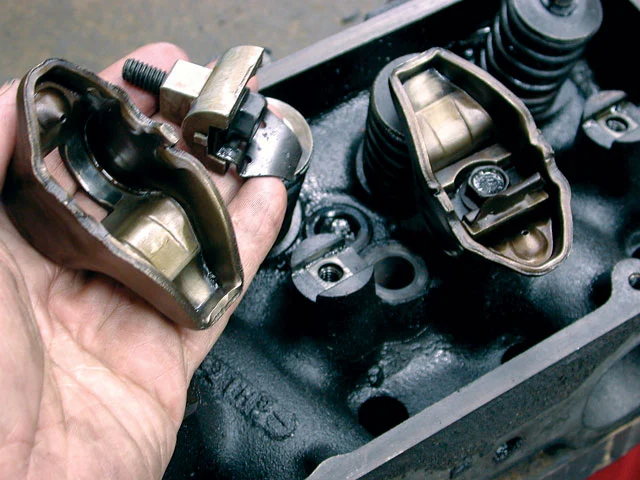

here's a couple of pix, the first should be of stud mount if I inserted the images correctly, and the second are pedestal mount rockers

I am on the edil. site now under 5.0/5.8 heads and it states that "86 need pistons notched and will not accept rail rockers" So now there are 3 types of rockers. As you can tell I don't know that much about the sbf. I do have a few pontiacs though, there easier. Thanks for all the help.
There's only "3" types of rockers because the two different types of stud mount rockers are known as rail and non-rail rockers. The important part to know about them is that rail rockers are stud mount but not adjustable. And '86 engines need pistons notched because they have no valve reliefs...at all. And, if memory serves, they actually are above the deck by a couple thousandths. The '86 engine is NOT taller or shorter, or anything like that...just different pistons and heads, but since you have aftermarket heads and you have a 331 stroker all that information is completely irrelevant.
Edelbrock aluminum sbf heads are either stud mount or pedestal mount. If you have RPMs, they will say it on the ends of the head...it's engraved and it'll say Edelbrock in script, then Performer, or Performer RPM...then there should be a model number, and if you have Performer 5.0 heads for example, they'll have a CARB E.O. number...just take the number and cross reference it on the Edelbrock site, or through Summit or Jeg's...and you can find out what version of the heads you have.
