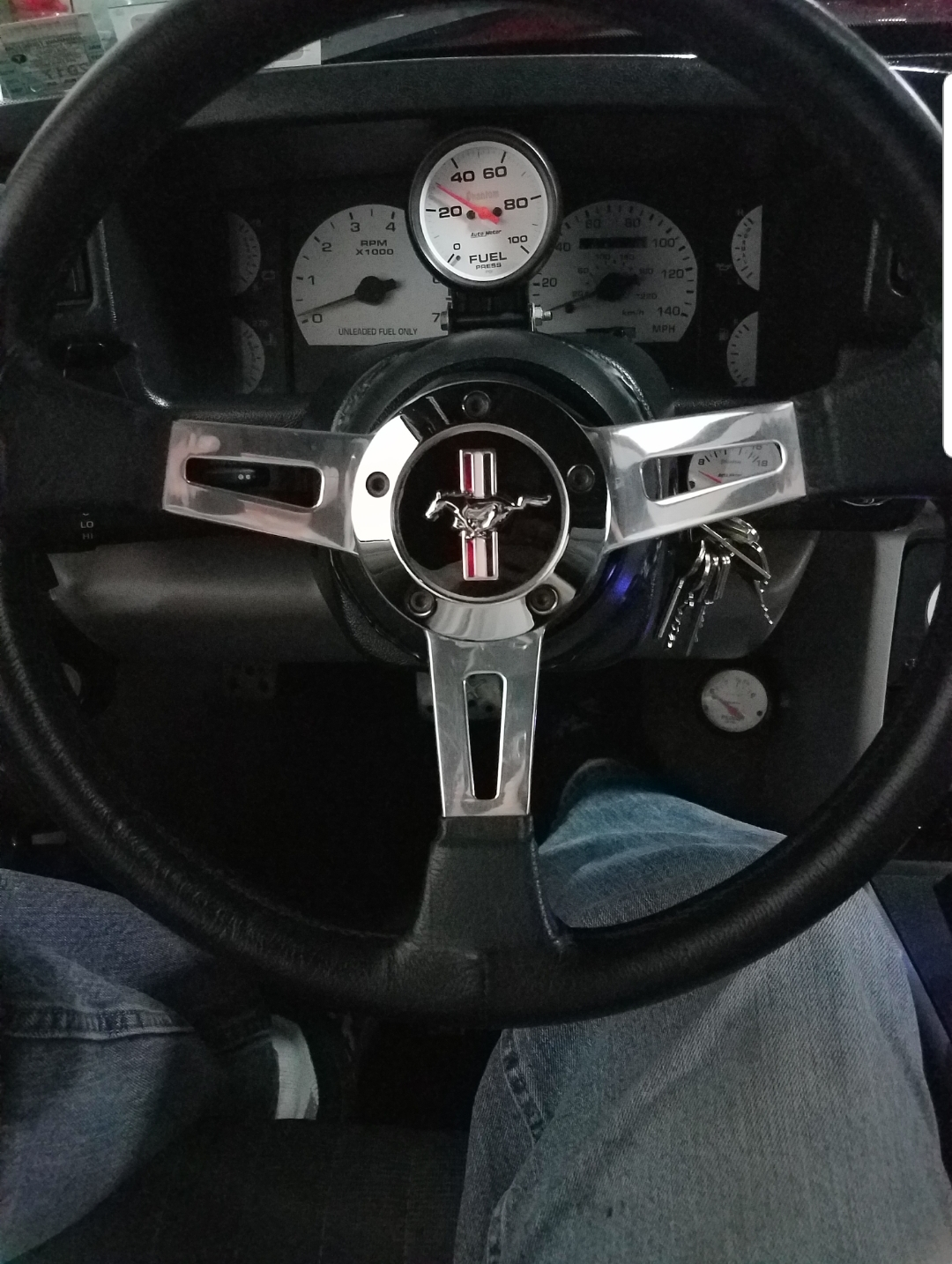

When I removed old stocker steering wheel, clockspring and airbag to install the grant wheel I removed all that as I didn't need it. I had to wire a new horn button because the grant wheel horn sucked. So I'm not worried about a horn, I deleted the cruise control, air bag module and light. Do I need my old clockspring for an 1989 wheel? 89s didn't have airbags...
Once I removed the old clockspring, I didn't have to use it w the grant wheel. I'm looking to junk the grant wheel and slap an 1989 wheel as they were simple. My question is, if I dont have to worry about a clockspring, would the 89 bolt up?
My current set up

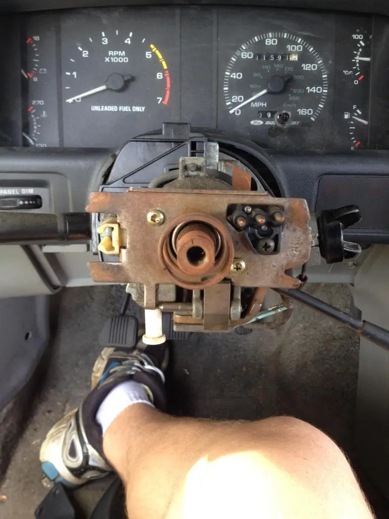

The pre-airbag cars don't use clocksprings. They have three fingers that are electrical contacts that ride on a horn ring. Completely different.
Here are the fingers
And on the backside of the steering wheel mounts the contact ring. 3 rings does horn and cruise control.
https://www.foxresto.com/1985-89-Mustang-Horn-Cruise-Contact-Plate-p/31185001.htm
Plus, distance to driver is different from airbag to non-airbag colume. The airbag column is shorter due to the bigger wheel. Correct way to do this swap would be to swap in an 87-89 column. At least you'd get tilt as well

Hey, thanks for the pic and reply. It's been so long since I had steering wheel apart. I remember eliminating them 3 fingers when I put Grant on. From that pic, it will bolt up. I may just have to buy the 87-89 column cover.. or may be able to use mine i jerri-rigged to work w the grant. Anyhow, thanks again!!!!!

THIS PIC OF YOUR COLUNM IS FROM AN 87-89?? RIGHT...
