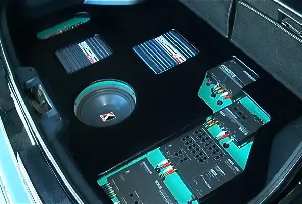

I'm thinking about keeping the spare and installing two boxes each holding a 10" Infinity. Then I'll raise the floor around the boxes. It'll raise the floor around 9 inches but it is already unuseable. I'll build it in such a way that I can take a few things apart and get to the spare.
The bad thing will be weight but I don't race so it shouldn't be a big deal.

Imagine the pic above with the speaker coming up to the top of the back seats, and that is my system.
It was built by a Pro shop, using MDF. That crap is heavy.
