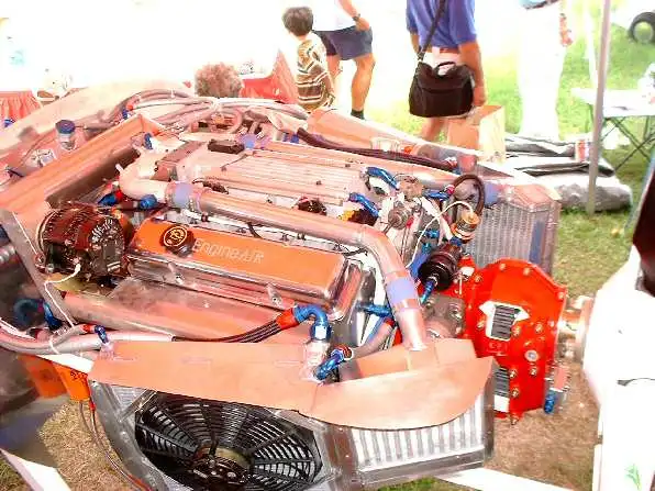

Can that engine go inverted?
Only with positive G maneuvers, but in that case, yes. Then again, any engine can run inverted in a positive G environment. The airplanes I put them in were not for aerobatics, they were for rich mofo's that wanted to go really fast. The airplane in the photo was my fathers. It'd cruise comfortably at 300 kias, or about 350 mph
@NickPohlAandP
I worked as an aircraft mechanic for 12 years, 9 of them as a licensed A&P. I saw some different types of aircraft, but never anything like that. What kind of airplane is that and what kind of engine?

Looks almost like a Cherokee 160
Not even close, lol
@NickPohlAandP
That's a Lancair IV-P, Experimental aircraft, homebuilt in a two car garage until we had to put the wings on, then it went into a hangar. The engine is something I used to build and sell, mainly to other Lancair IV-P owners. It's basically a Chevy 400 if you want the dumbed down version. The longer version is it's a Dart aluminum tall deck small block 400 with custom Dart spread port cylinder heads, custom cam (119.5* LSA), custom built exhaust that hugged the head more than anything you've probably ever seen before, Oliver rods, Scat billet crank, full roller valvetrain, Turbonetics T3/4 hybrid turbo, dual ECU's, redundant everything.... I can go on and on and on. There were basically three iterations of the engine. The smallest used Brodix spreadport heads with a standard deck Dart 400 block, it was a 375 (destroked 400) that would dyno at 425 hp at 4900 rpm. Then there was the 400 (tall deck) with Dart heads that would dyno at 450-460 at 4900 rpm. The biggest was the 427, another Dart tall deck with Dart heads and it would dyno at 510 hp at 4900 rpm. My dad flew with all three engines and his favorite was the 400. He claimed it had the best fuel consumption for his style of flying, and in my opinion was the toughest of the three. All three were built strong enough to take 4x the power we were pulling out of them though.

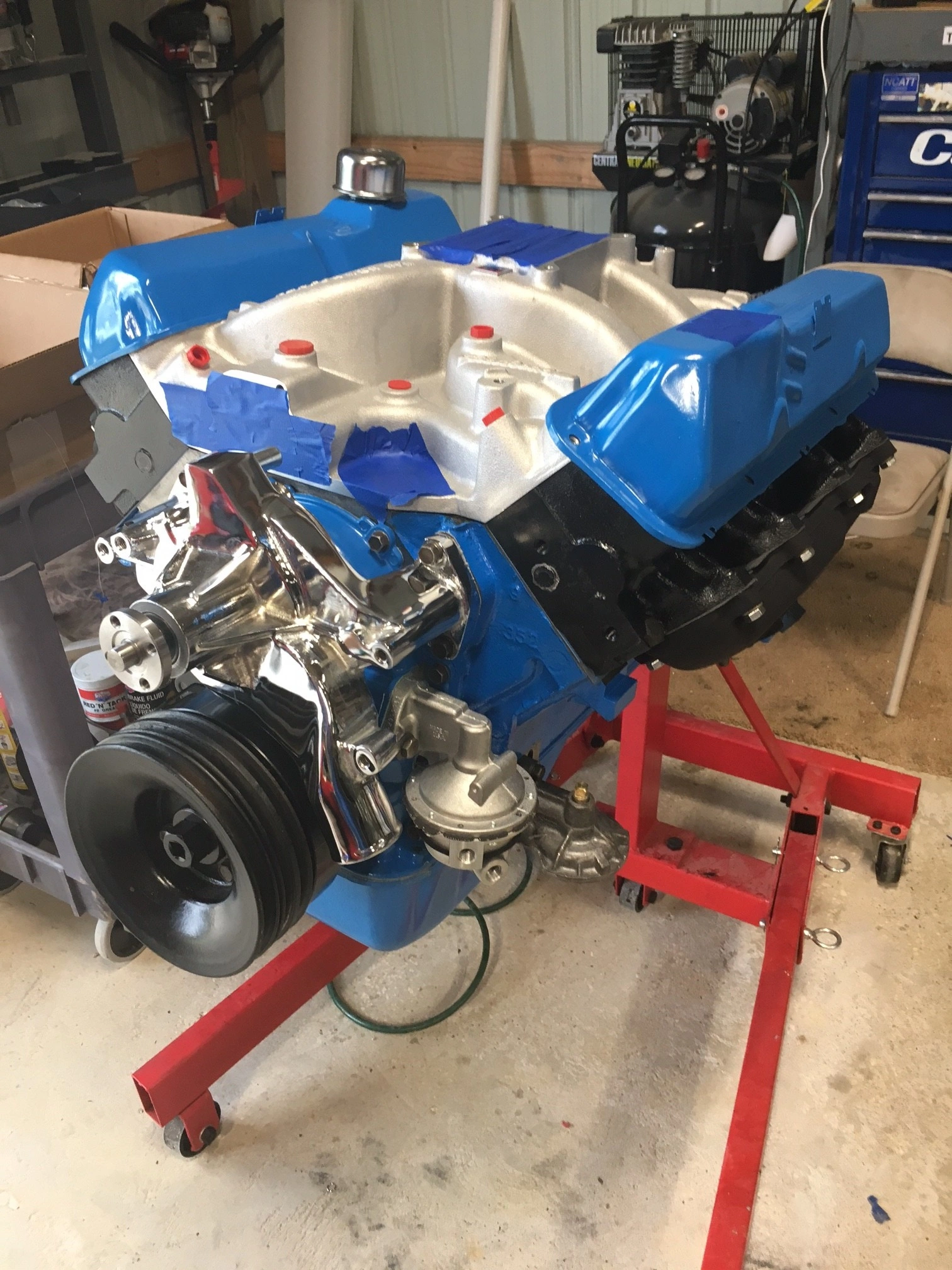

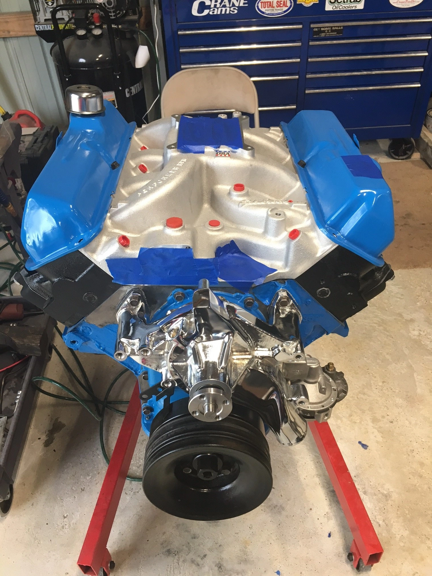

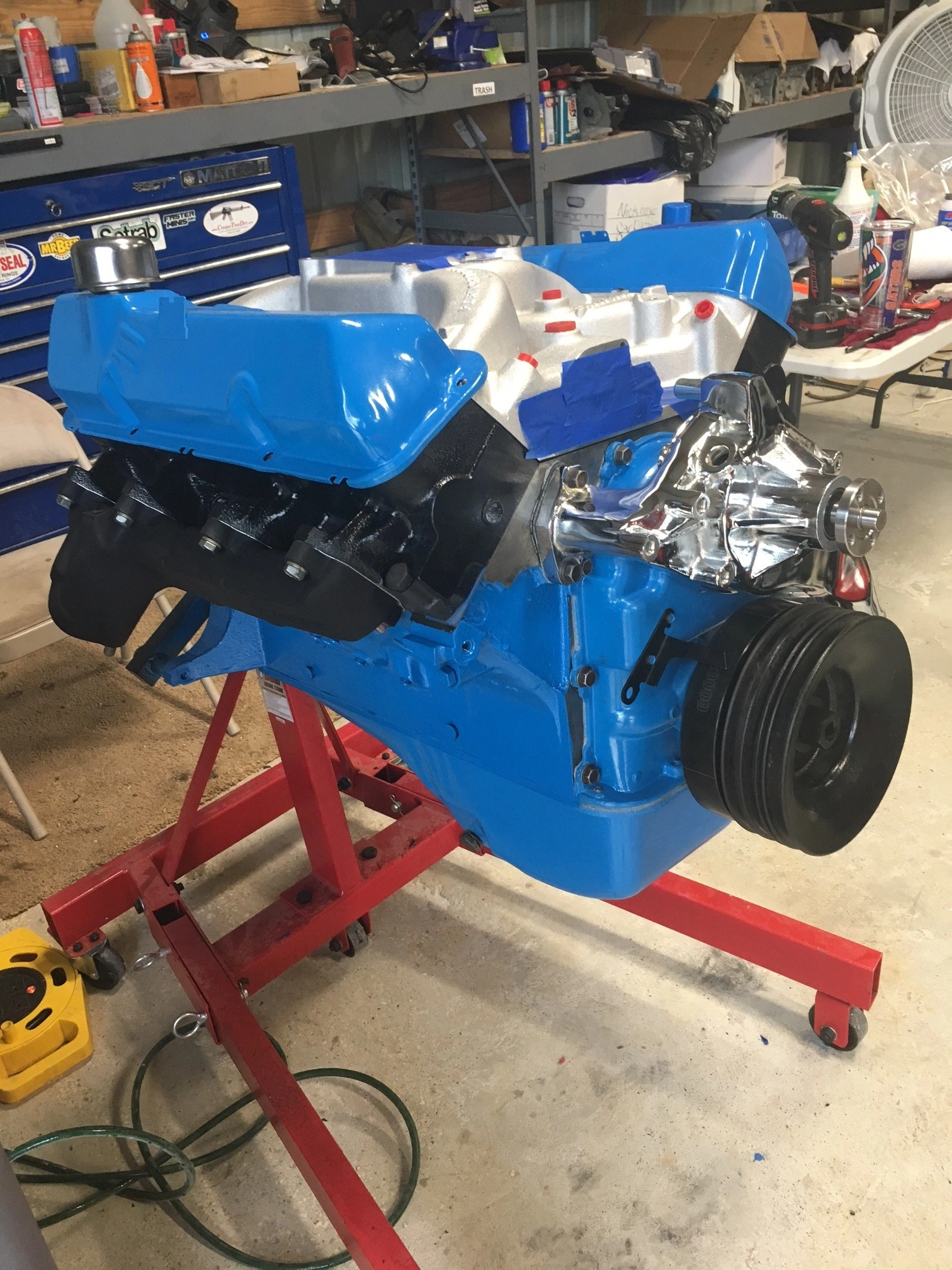

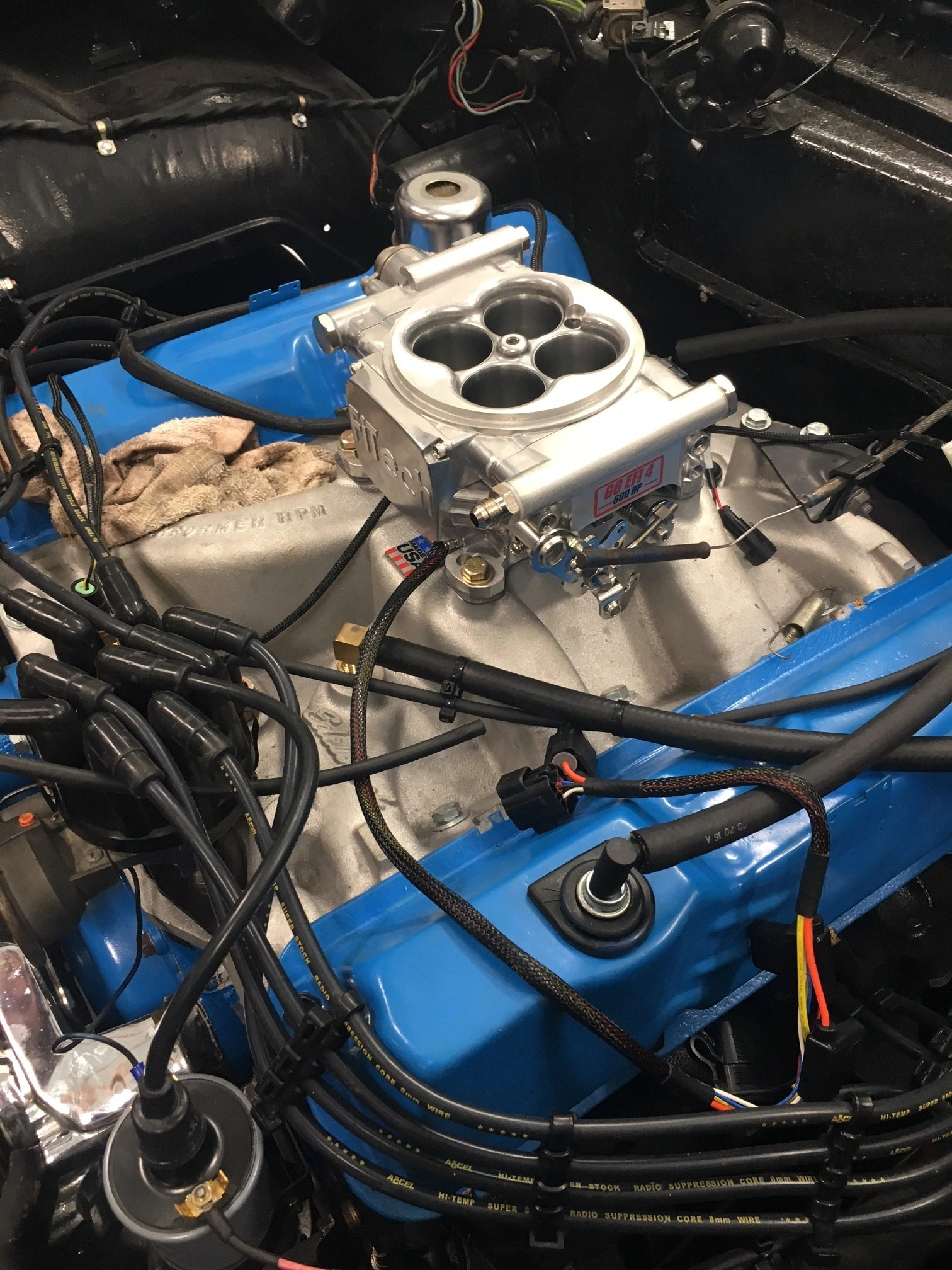

Also, I wouldn't even know where to find a 351. I can go into any junk yard and pick up a 350 or BBC (if they haven't been robbed, BBC's go fast), but I was taught on Chevy, I know them very well. I'm kind of Ford illiterate. I just built a 390 FE for a 65 Galaxie and that was a fun learning experience. It was by no means a high performance rebuild, just a stock freshen up with a very mild cam and fuel injection, but I'm cutting my teeth into the Ford world.
