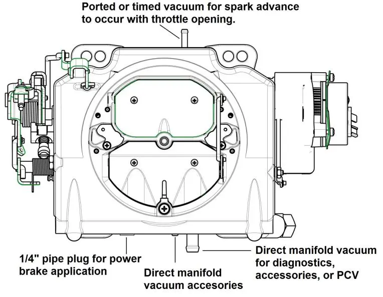

I can run at it where i'm at without it pinging without the vacuum advanced hooked up. if it is hooked up and running 6 initial 30 centrifugal and i floor it, it's fine but once i'm light on the pedal it will ping. I know that is all vacuum related but i keep tunrning and turning this thing and nothing. i road test set timing till it pinged at 8 without the advance hooked up and had hard starts so i turned it back to 6 and it felt awesome and started nice but once i hooked my advance same ping. i got 71 km per 15l (sorry for the canadian metric system) and i jumped for joy.
You’re absolutely sure you have a good balancer and that the timing pointer is correct? You’re using #1 on you light? I’m not saying you don’t know what ur doing but trying to have you double check yourself. I’ve spent tons of time chasing an issue only to find out I was making a mistake. Do you know anyone with another distributor you can borrow to rule that out?
I'm absolutely sure that number 1 on the balancer and the timing pointer are accurate. I bought a piston stop gauge from Princess Auto and verified that it is correct. I ruled out the distributor by buying a rebuilt dorman duraspark out of a 84 f150 351w. It was only like 40 bucks. I verified that i am using the 15l slot (it also has the 10l) with good spring pressure. It fully comes in at around 3500 they say 3000 is good but like I said I road tested the timing until it pinged then backed it off a bit. I'm still debating about restricting the actual vacuum to the line. Maybe it's possible that my cam is adding to much vacuum but i already changed the cam because at first I thought it was a lifter rattling. Maybe i just wanted a good excuse to put in a new cam. :D
If you are plugged into the metered vacuum port it shouldn't matter how much vac the engine is making.
