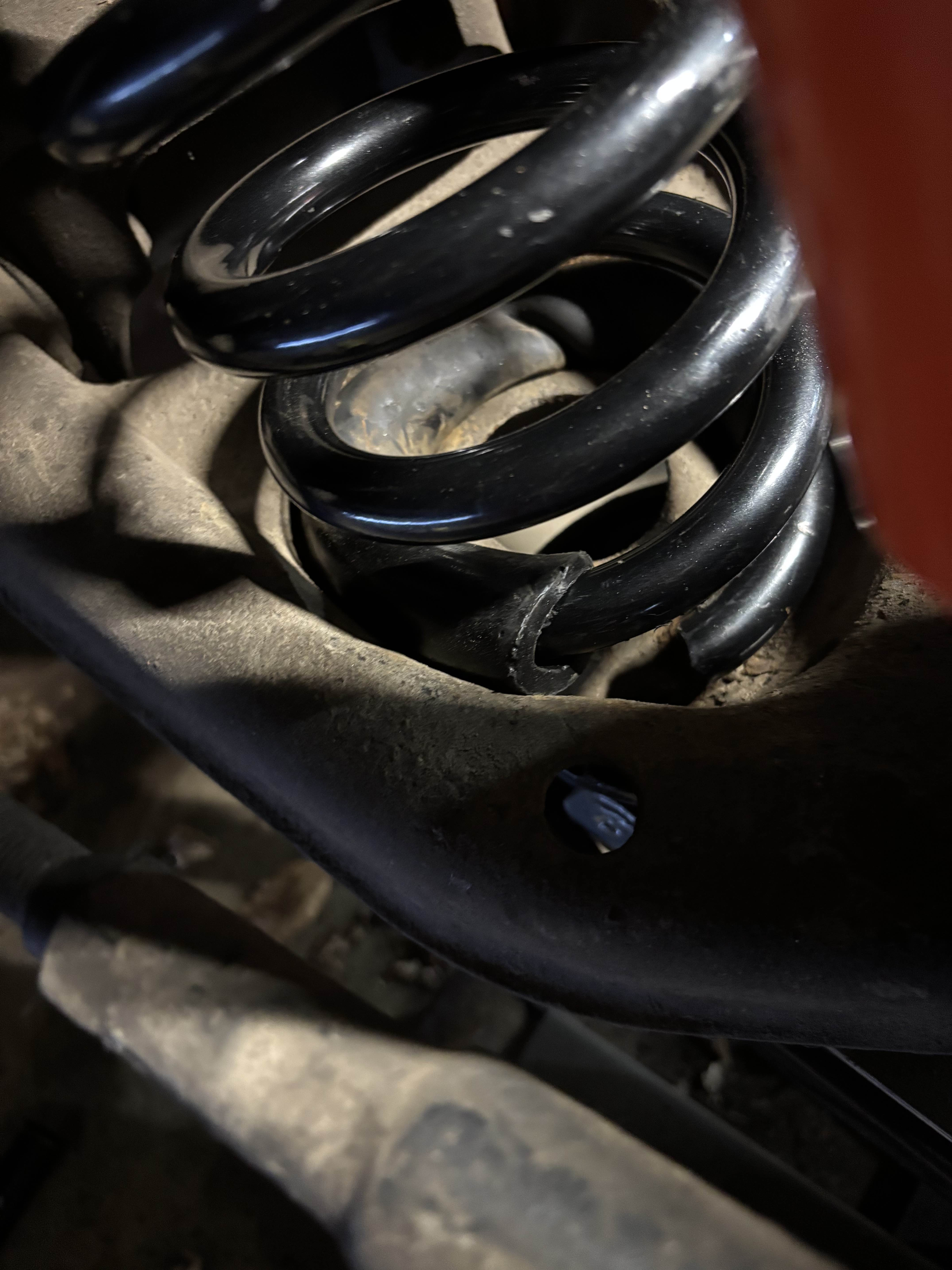

Doing the suspension on the 87' finally! I ordered eibach lowering springs and koni orange struts. I ordered new isolators from maximum motor sports and after I got the first spring in (front left side) I noticed a sizeable gap between the spring end and the purch it sits in. Is this normal or should I go without the lower isolators?

Yes it’s normal as they are lowering springs. Isolator should be all the way to the end of the pigtail on the spring. Also, make sure you put the end of the spring into the cup of the LCA.

I see, I’ll have to re adjust the spring in the perch. The new isolator is preventing the end of the pig tail from fully seating in the cup, if that’s normal then that’s that.
The isolators are supposed to prevent the metal of the spring from contacting the lower control arm which is supposed to stop noise and it also helps with them rusting.
Right on, I got the fronts in and everything aligned honestly wasn't too hard even without the spring compressor, a second set of hands really helps. I'll be doing the rear before too long here, I also need new front brake hoses as the rubber shielding is split in three places on the front left hose!
