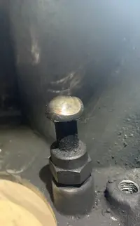

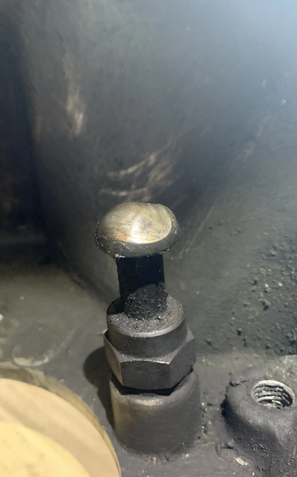

Alright got the trans out. Bearing retainer looks good (smooth, no cracks, no groves), throw out bearing looks good and feels good, clutch for looks good, and the pivot stud… well I think the picture explains for itself
You found a problem.....
