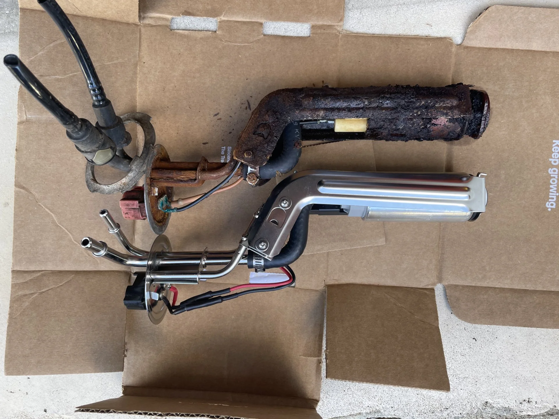

New LMR tank and hanger assembly with 255 lph pump. When I set the hangar assembly in the tank with the sock aligned in the sump, the bottom hits the tank bottom and it won’t sit fully inside without force. I got it in and the lock ring on, but will it cause issues with the bottom of the pump/sock sitting tight on the floor of the tank? Fuel starvation?

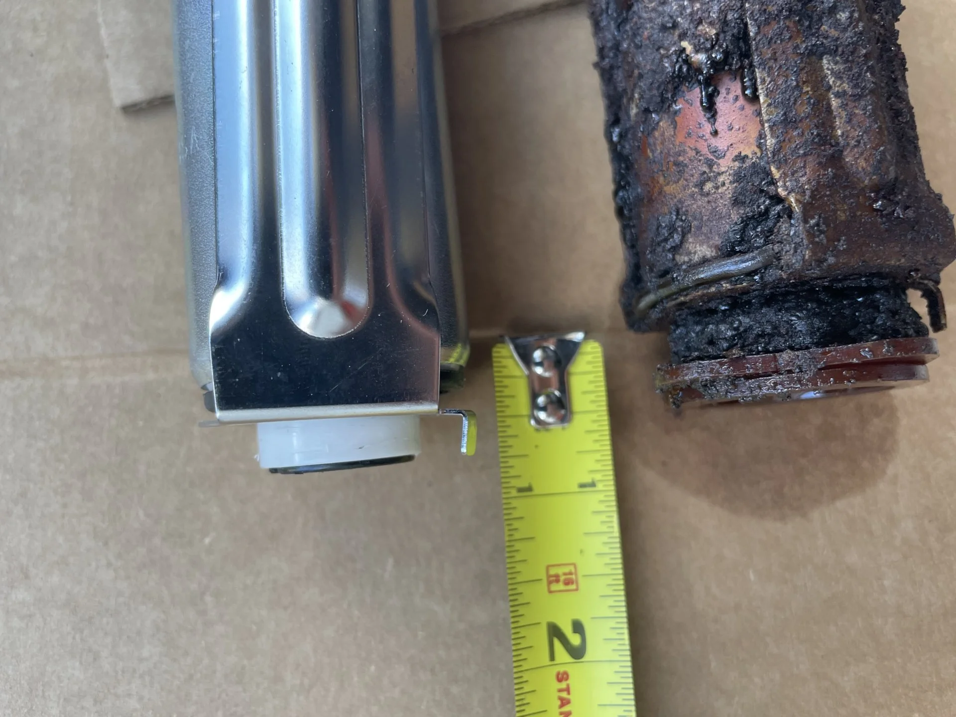

Thanks everyone. Looks like this is a different issue, though. LMR responded and said they have another customer with the same issue, and it is the pump bracket that is nearly half an inch longer. Guess I was lazy not to check this sooner, but measured old and new and confirmed it. They’re already working on a solution with the manufacturer, and luckily I’m in no hurry. The other guy was in a hurry and made it work. Dropped the filter sock in the tank getting the pump out for the second time, so I’ll be fishing for that. Any tips? Flipping the tank and shaking seems my best bet! Lol!

Is the old bracket rotted or just covered in crap? I've never had one rotted but I have soaked a few in metal prep or evaporate rust to clean them up when they came out of crusty tanks.

You would be surprised how well that cleans up once you take the pump and hose off.... If you have any white vinegar in the house, throw it in a 5 gallon bucket while you wait for one to show up lol nylon bush after soaking and I bet most of the plating is there under the rusty varnish build up.... You might be able to just swap the pump bracket to the new pick up if that's the part that's longer on the repo part
Even if just the lower pieces of the OEM hanger will clean up it looks like that is what is too long on the new one. You may be able to use the new upper and the OEM lower piece.
I’ll give it a shot today. LMR pulled all of their stock, and all are too long. Refunding and offering goodies for the trouble. I could also drill the new lower portion of the bracket to make it work. I’ll get it in there one way or another! Thanks again everyone.
