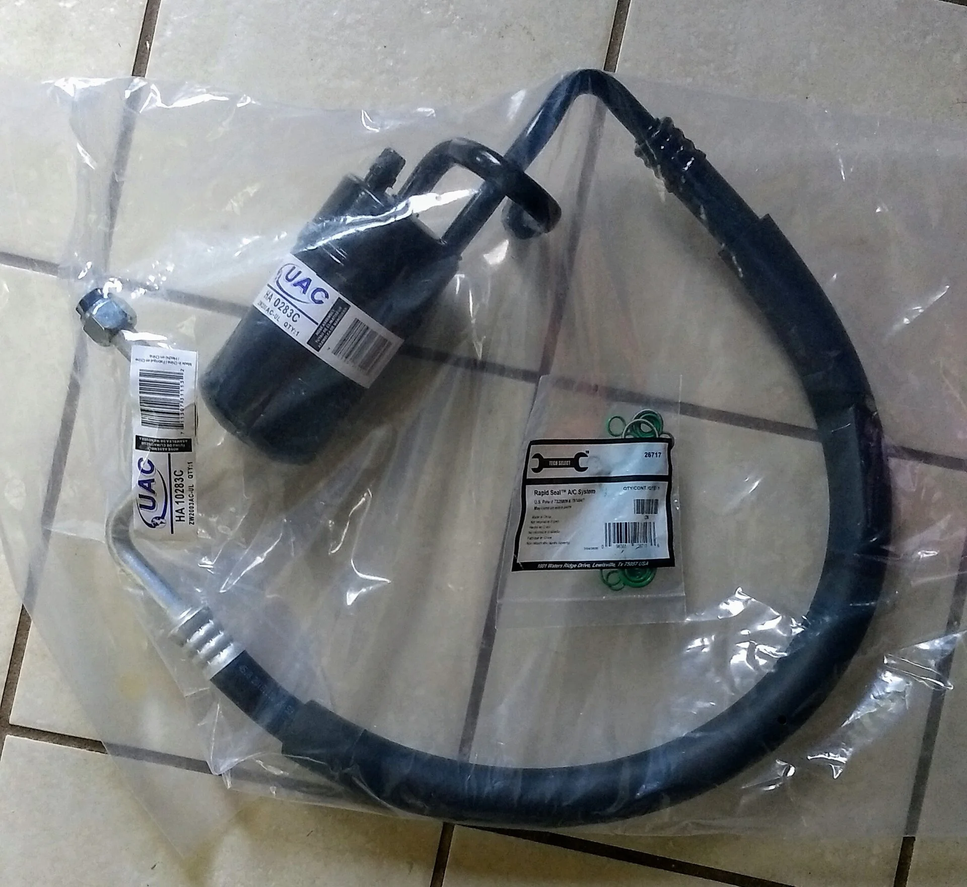

I went ahead and ordered a new dryer, o-ring, and r-12 to r134a port conversion kit for the car. I already have a new orifice hose, so will be replacing those two main parts and all the o-rings in the system. Then refill the system with fingers crossed it will work again.
Finally getting some time to work on the car this weekend, so the new A/C parts will be going in the car. Hopefully it decides to be a simple job of take out the old and put in the new.

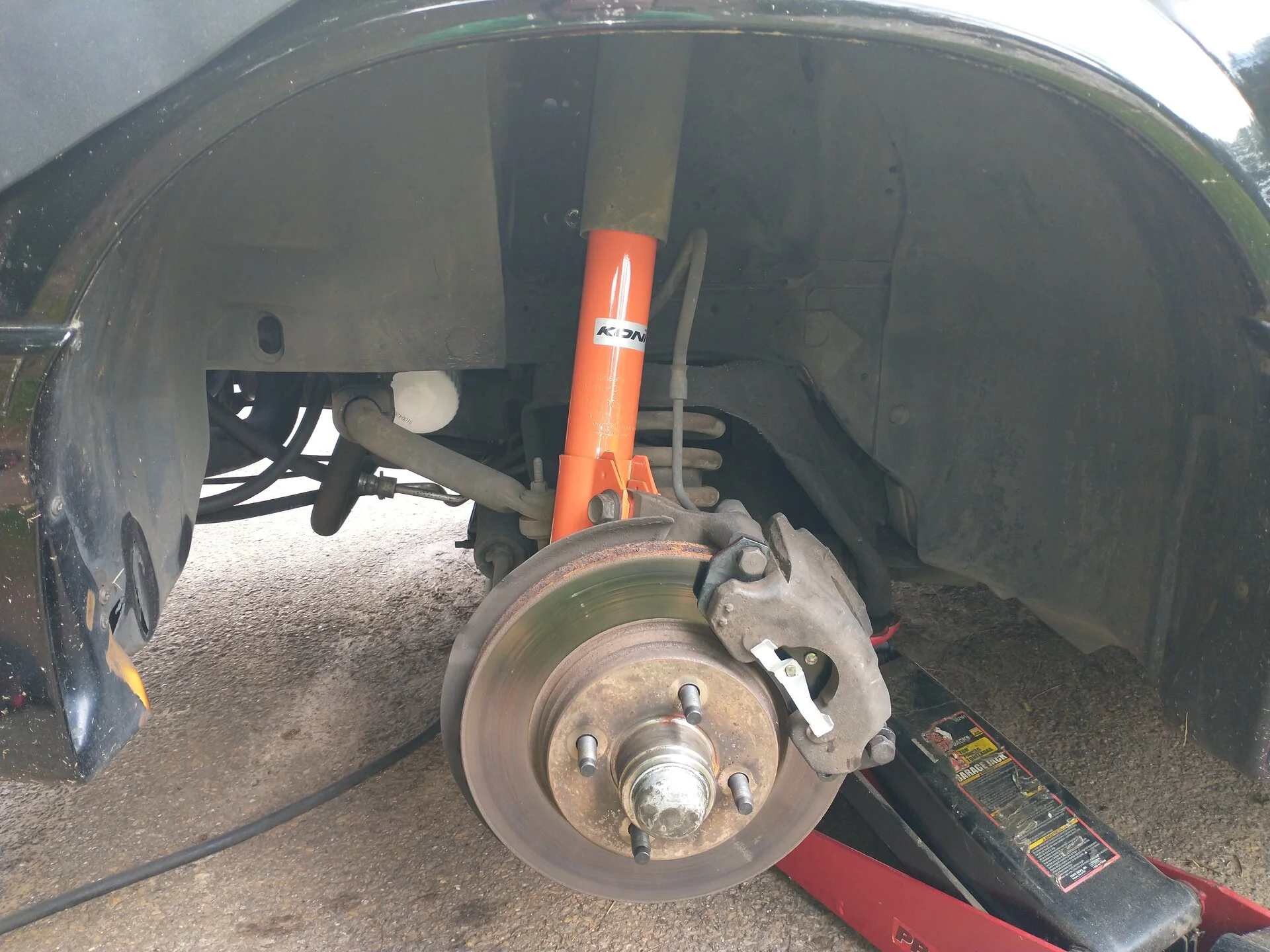

So I was able to get some work done but not as much as planned like most of us. I got the shocks and struts replaced along with replacing the front brake pads while I was in there. Since the rotor needed to come off to get to the strut bolts I went ahead and repacked the bearings too.
Not much to show for this other than my orange strut:

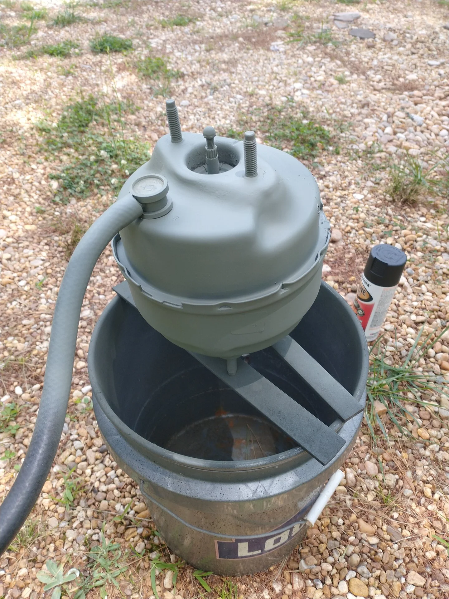

The next task was the biggest pain of getting the old brake booster out of my red mustang, cleaning and then painting it for install into this car. It is so much easier to replace in an automatic car then a manual due to the extra pedal making it almost impossible to get to the top left nut. Forgot to grab a finished picture of it painted back to black but we all know you like pictures.
