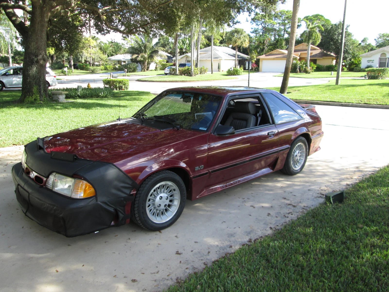

Here's what it looks like. Car is lowered an inch, too, for total drop of 2".
