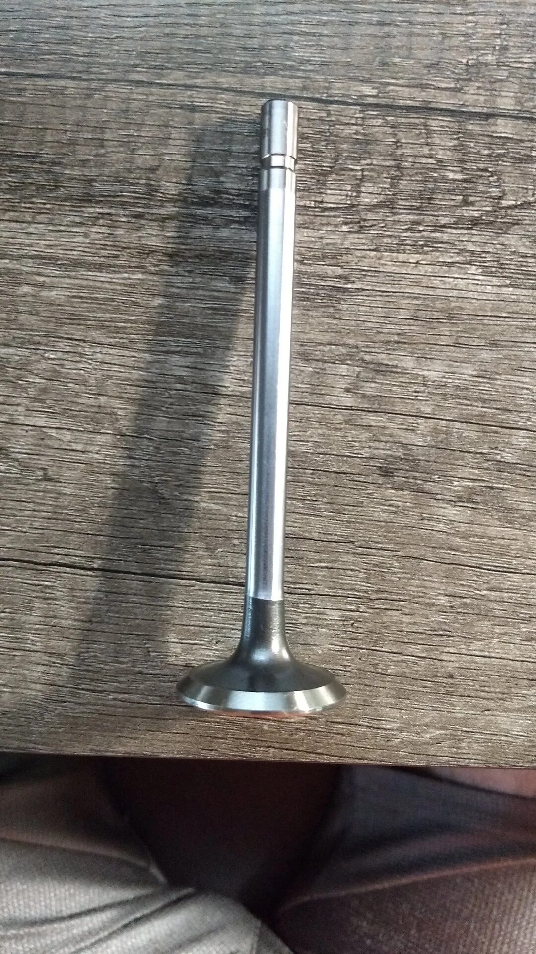

I have mainly been in the part collection mode right now. To start it off I was able to get a replacement exhaust valve from RockAuto, so that now I can give the machine shop a call to go through the heads. I plan to have the machine shop disassemble, hot tank, 3-angle valve job, install the new valve seals, and go over the spring pressures of the heads.

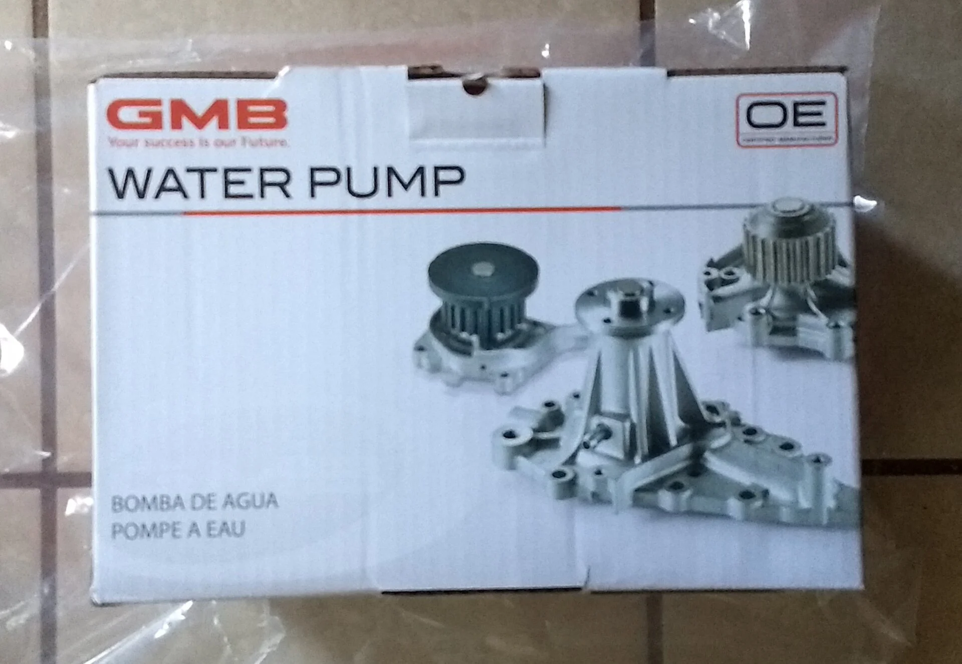

I also got in the last remaining piece I need which as a new heavy duty water pump. I will need to of course be painted to match the rest of the engine as well. Lastly, I can then cut a stencil of the cars logo I built a while back to put on the valve covers to be painted. So, I can then finish up putting together the long block of the engine.

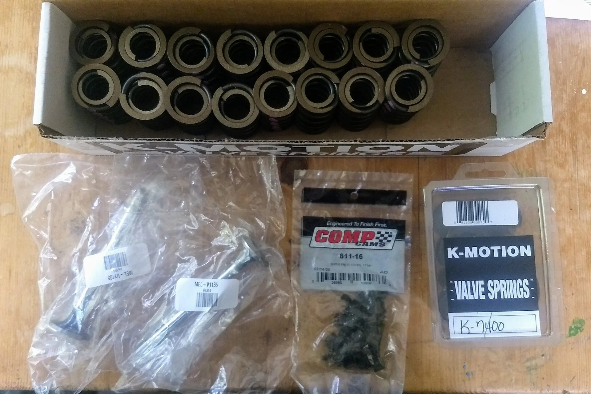

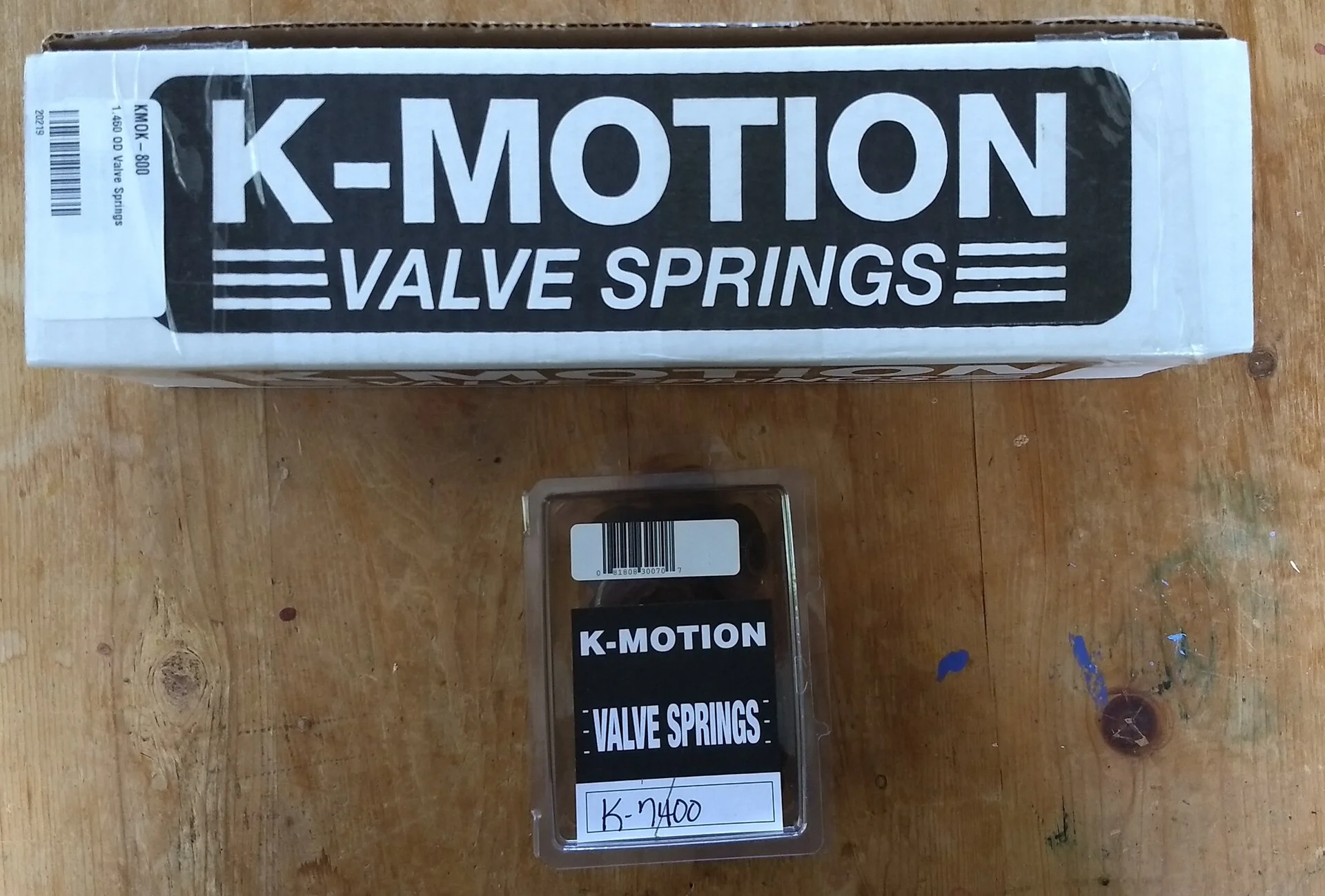

So all of my packages came in today for rebuilding my heads: K-Motion Springs and Retainer, Comp Cams Hardened Valve Locks, and (2) Exhaust Valves.
I also reached out to Comp Cams about the necessary spring seat pressure needed for the new cam, so that the Machine Shop can set the correct Spring Height. They came back with needing 120-140lbs, so looking at K-Motions website for my springs it looks like I will be needing a 1.925 to accomplish 130lbs.

I got that call again from the Machine Shop, and the springs wont work on these heads. The spring height needs to be set at 1.925" for the proper seat pressure for the cam. They are coming out at 1.8" which is WAY to short since it will push the pressure 50% above needed. So this took me down a rabbit hole that many of us have been down (please guys no finger pointing) of what do I do now.

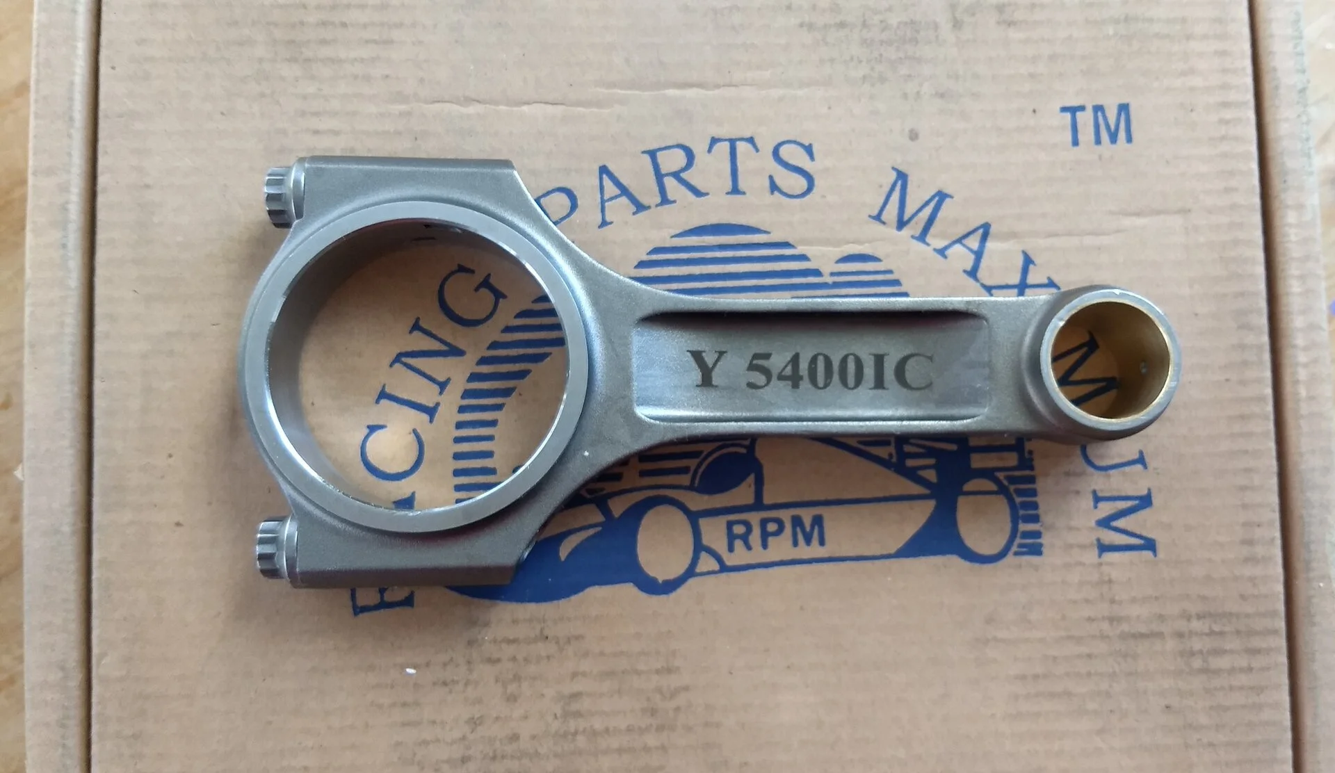

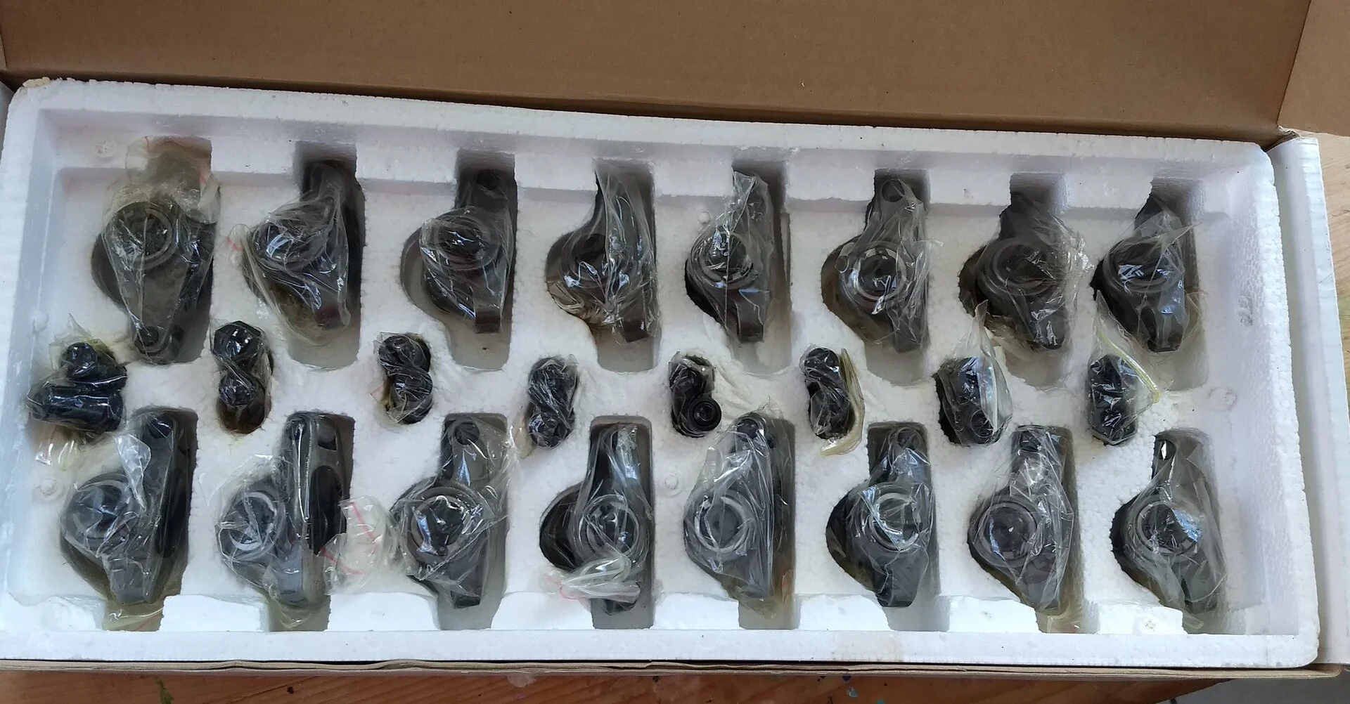

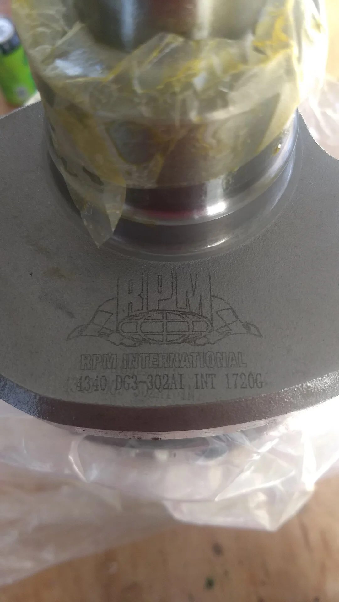

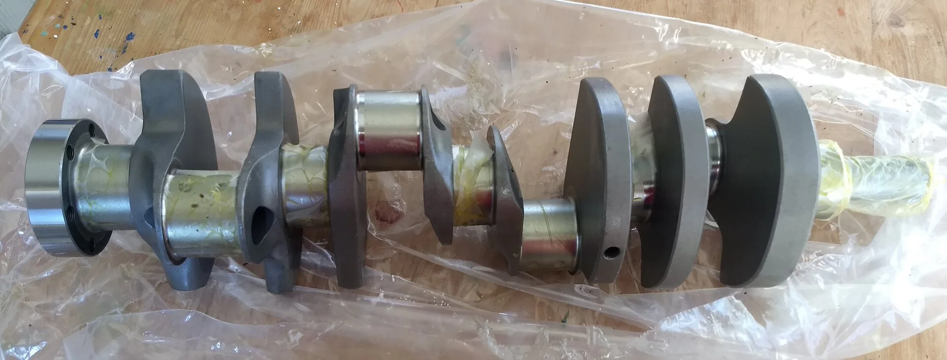

Well, I know updates have been quite sparse on this thread, but work and virtual school for the kids have really eaten up most of my time. I was able to make a little progress with more goodies now on the way to kick this project off. I traded the long block and a digital dash to my uncle to get a replacement hatch for my black mustang that's rusting out, a stock block, and a rolling 91 GT Hatch body for my daughter that wants to build her 1st car.
The new block just got goodies ordered for it yesterday:
- RPM Crankshaft - Internal Balance
- RPM 5.400" I-Beam Rods with ARP2000 Bolts
- +13.00cc DSS Racing Dish Piston
- 1.6 3/8 Stud Roller Rockers
So I will be able to get all these over to the Machine Shop to get balanced and the block ready to go for installing the new goodies.

The goodies are starting to show up. I'm still waiting on the pistons before I can take everything to the machine shop.
