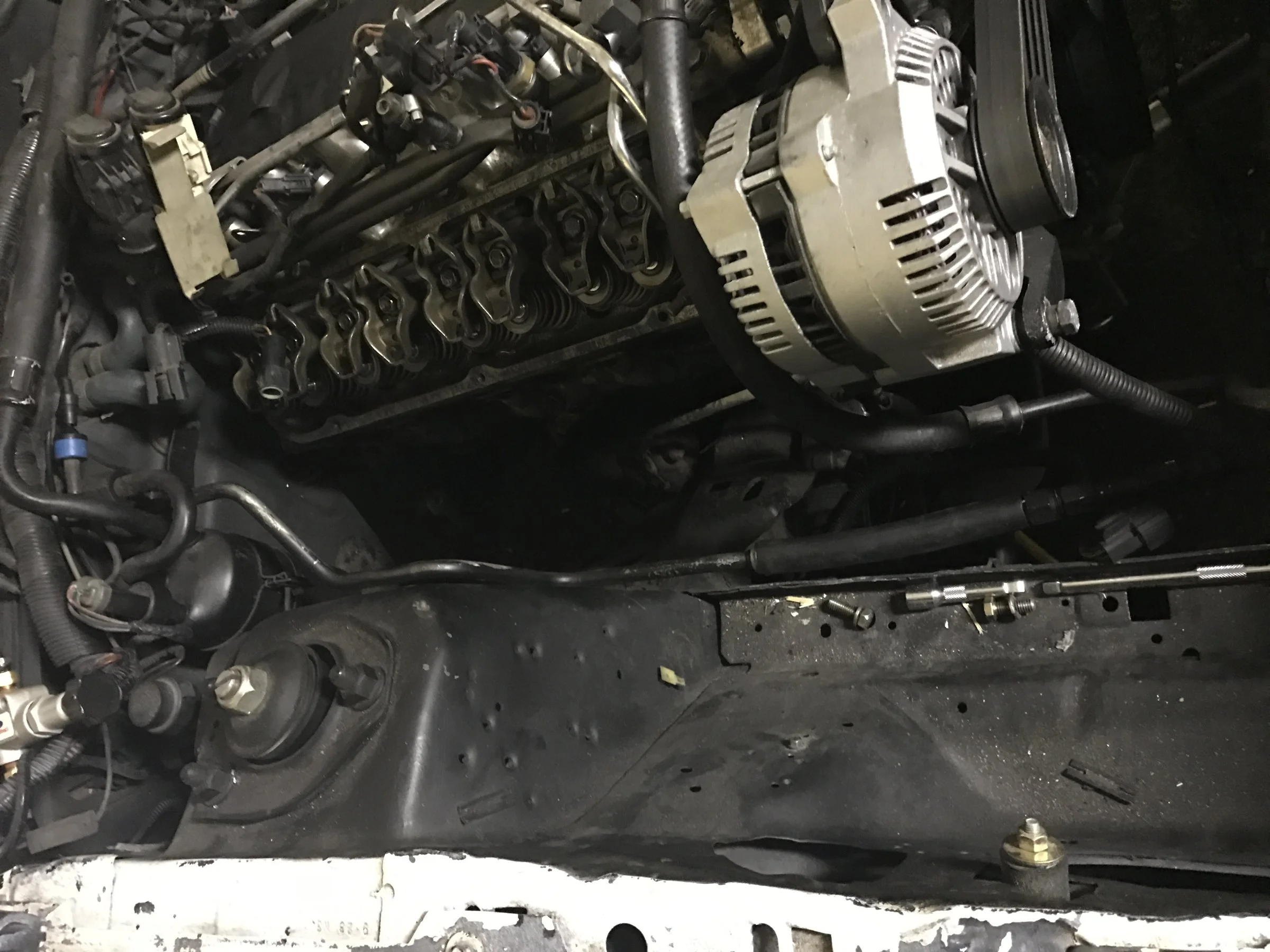

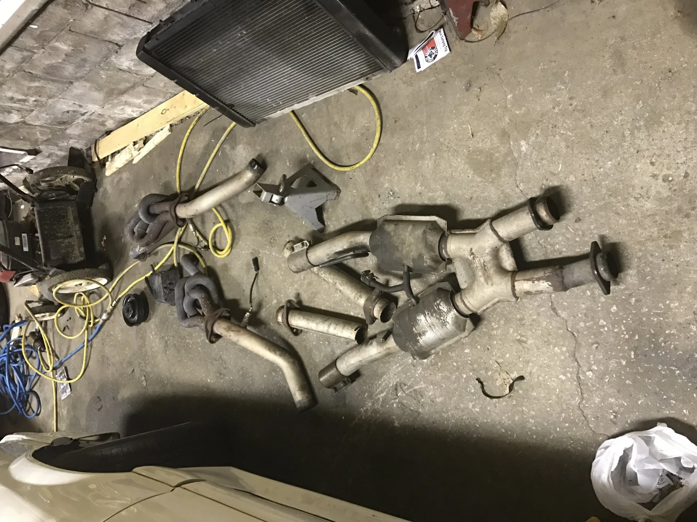

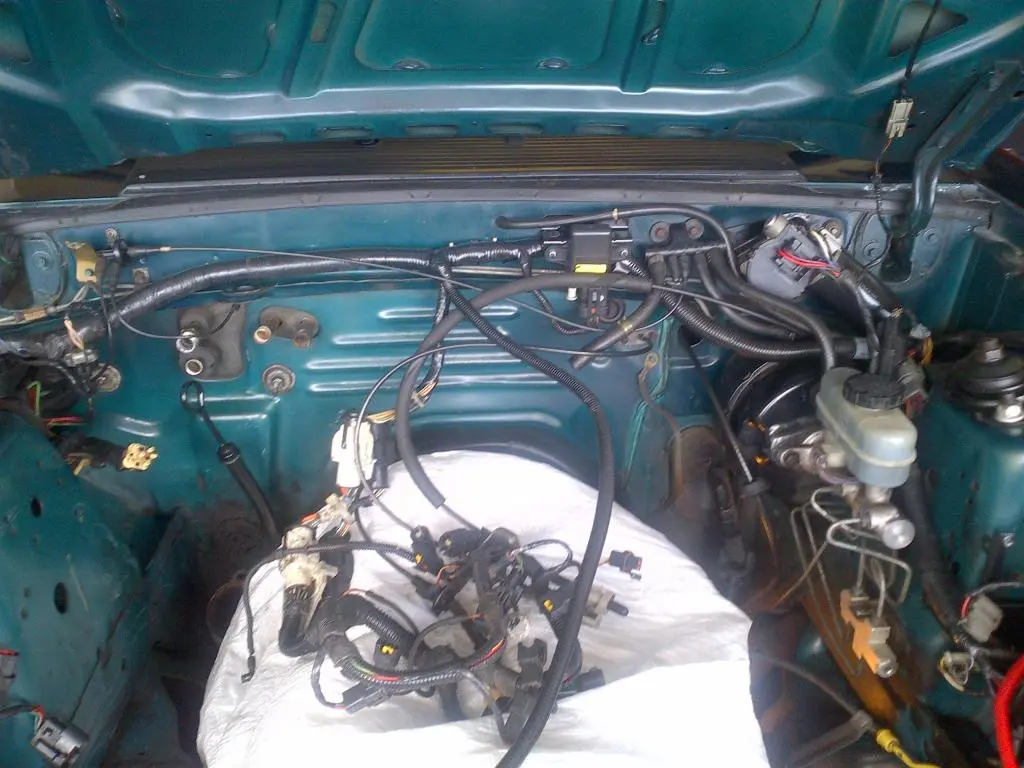

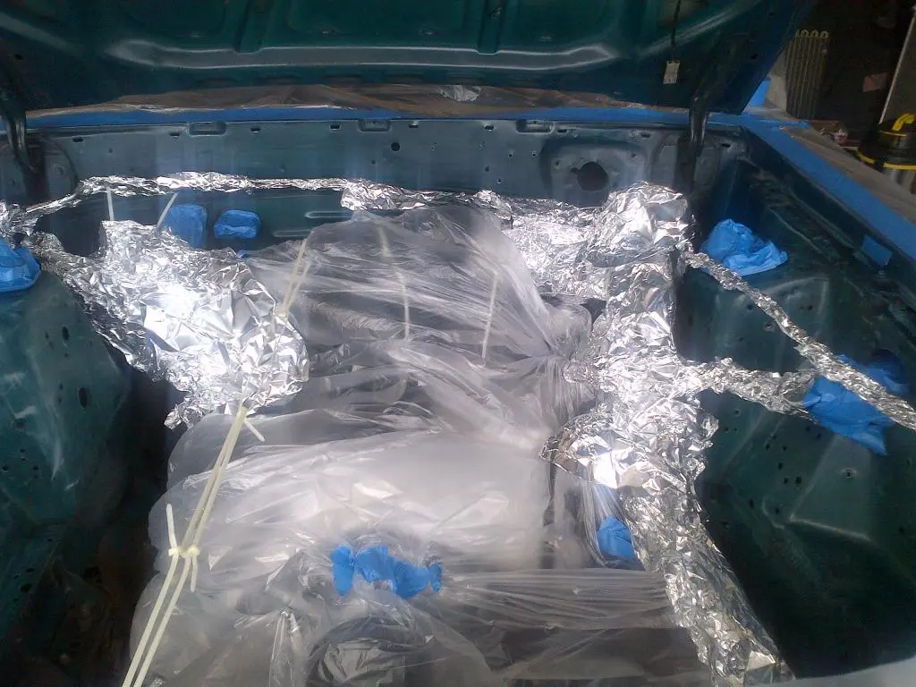

Got a little work done tonight. Nothing huge. Pulled the upper, started pulling the ac, and started pulling the long tubes. Hoping to have the exhaust pulled over the weekend. Swapping to shorties and cats. But one it's out it'll make it even easier to paint the bay. So it's officially started.
I'll be basically pulling everything but the motor and harness for paint, and once the fenders are off I can access the fender aprons and go from there.

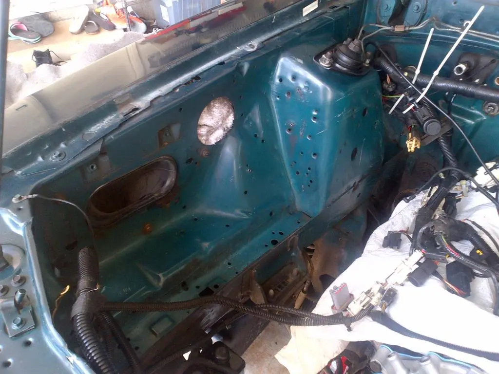

Stolen from another post. But this is about what I'm going for. Cleaned Up fenders, clean stock looking under hood components.

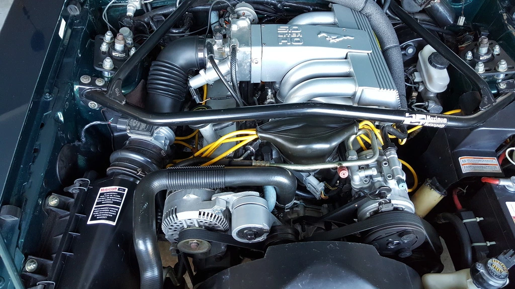

Anyone know what the factory 88 engine bay would have been pained? Body color or that gray color? I'll be going body color.
That's my engine bay. I actually painted that myself when I had nothing more than the shortblock in there. It was not bad to do. For my wire tuck I didn't really go nuts, just went for a cleaner look. My main harness in the back is like you mentioned doing, just tucked under the pinch weld. I like the stock-ish look personally with just some cleaning up of the wires. The engine bay is one of the things I am most pleased with on this car. It's fun when I go to shows and reverse in by some of the other cars, pop my hood and they slowly all start closing their hoods....:D

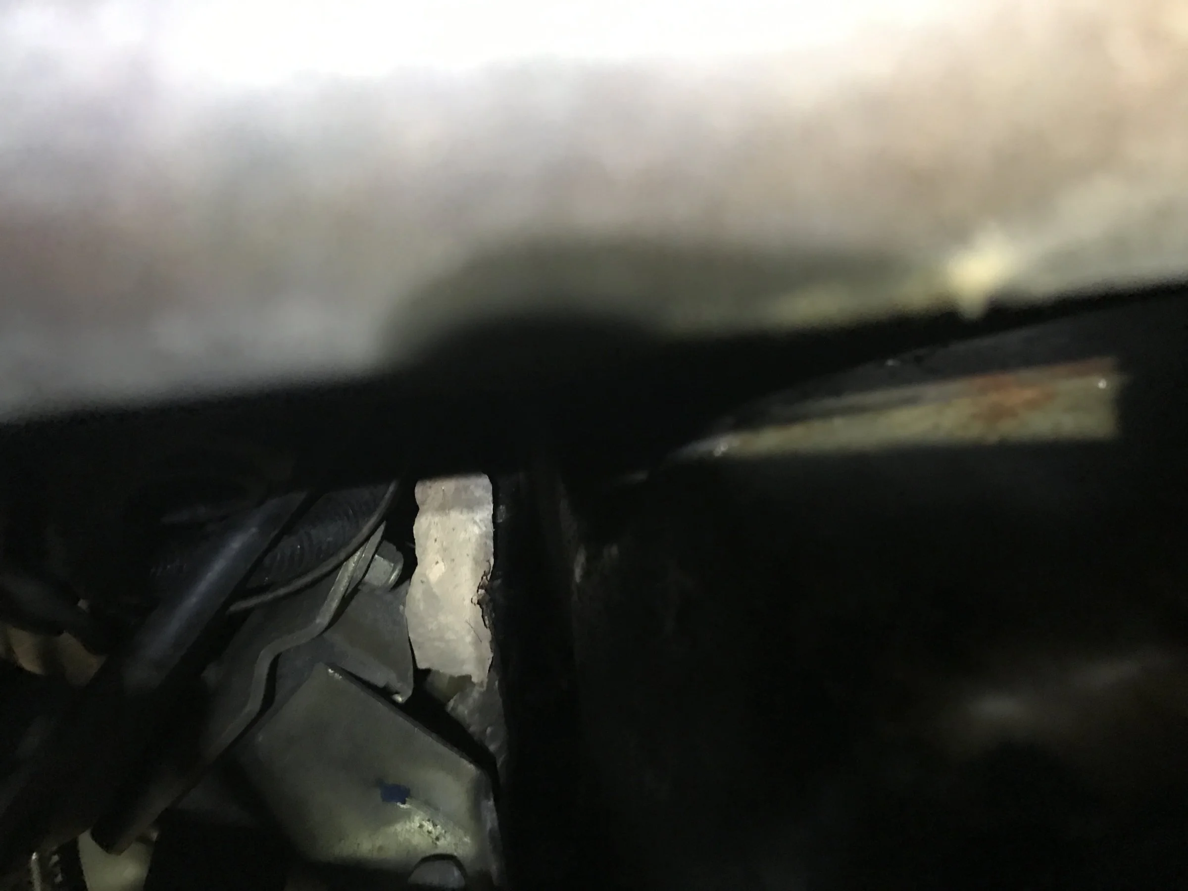

Also, I've suspected the last owner took the car out mudding before he sold it, the whole underside is caked in clay. Found this gem hiding away.
To get these out I had to completely remove the motor mount and starter. That along with a stripped oxygen sensor made for a fun time.
I'll grab another pic soon, but it's either a large rock or a large chunk of clay between the motor mount. The rear was the same, just a thin coat of clay on everything. Makes me think it spent some time in a field with the tires spinning.

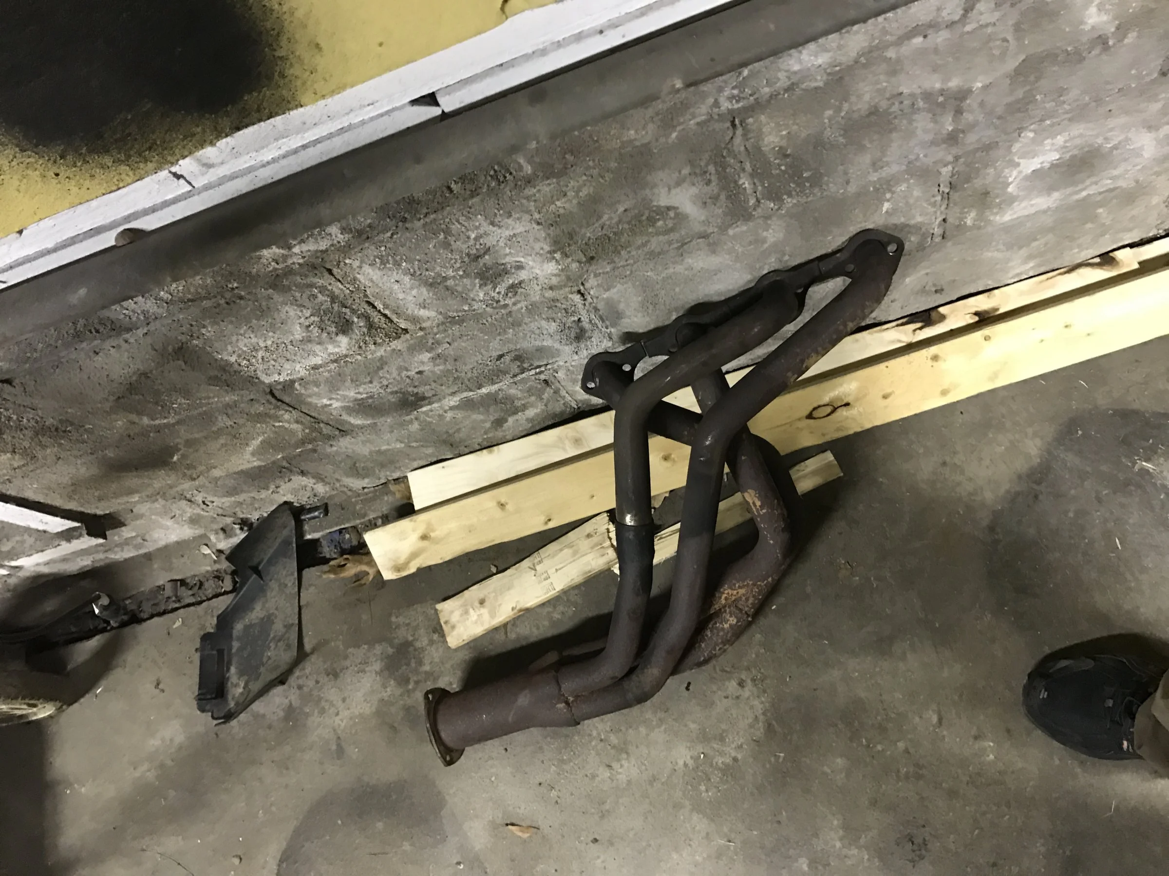

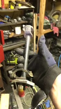

The best way to get the most clearance for long tubes:
Driver's side: unbolt the steering shaft from the rag join (if yours is still stock), collapse the shaft and stow it out of the way. This should give you plenty of room to install the driver's side from the bottom.
Passenger side: unbolt the passenger motor mount and jack that side of the engine up until you have enough clearance to drop the header in from the top. I used the smog pump bracket as a jack point for this.
Reactions: Davedacarpainter

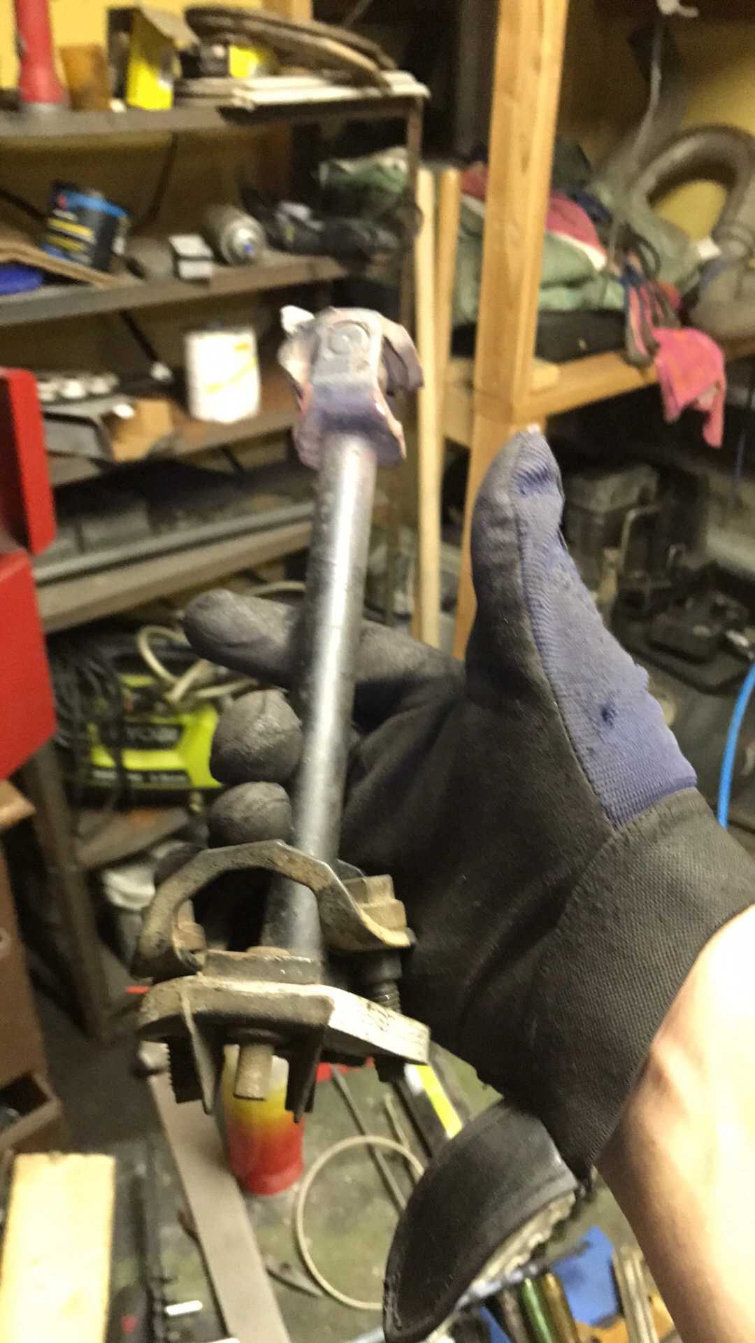

Yeah, I saw that. My shaft goes though the long tubes so it's coming out anyway. But the passenger side is out, gonna try for the drivers side tonight /tomorrow
I posted elsewhere, but I'll post here, too.
I'm at the point now where I gotta remove the shaft. I can seperate the rag joint and remove the shaft without loosening the rack?
