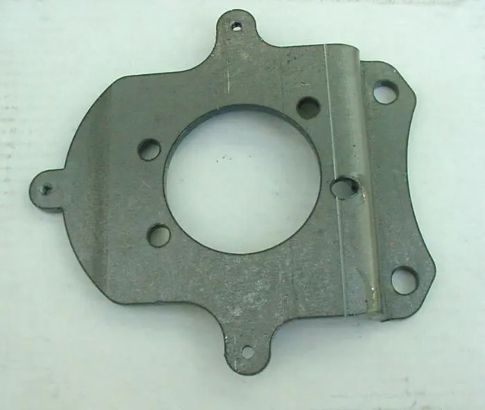

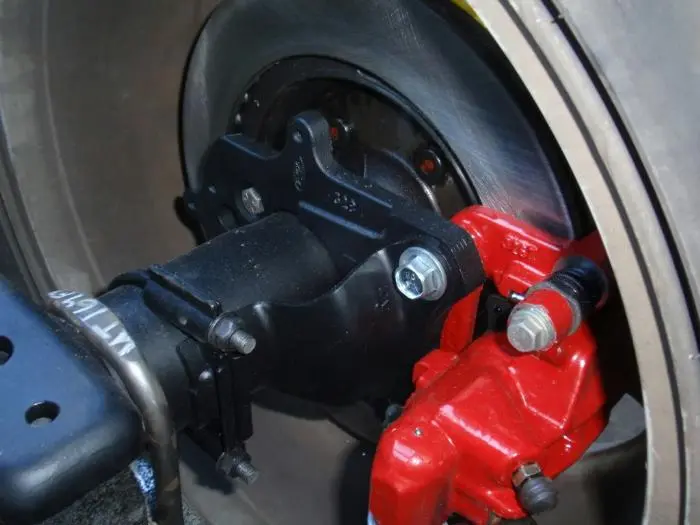

All depends on if they used fox lengthy axles with the 4 lug disks or used the 93 cobra lengyt axles which stick out 0.75" more
Sent from my big ass iPhone 6 using Tapatalk
Then sounds like it's fox length disk brakes. Easy way to confirm is to poke your head around the backside of the brake setup and look at the axle bracket. If it has an offset like this, it's probably a north race cars bracket.
Vs a factory bracket

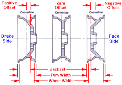

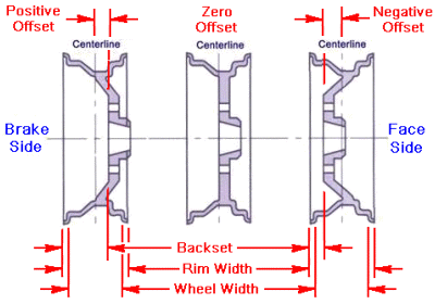

Thanks a lot for the info, but you hit on my question in your last comment about back spacing, is back spacing and offset the same thing? If the placement of offset or back spacing is changed I believe the tire will fit without any need for fender work or removal of quad shock. You guys have been working with these tires a whole lot longer than me. I just don't want to buy new tires for these 17's if I have to change sizes to get a wider tire rim combo.
here is a diagram and an article of what I am getting at.
As explained you can see that most wheel(including my 17") are positive offset but if you go to a zero offset you can see how it moves the tire out towards the wheel well opening.
well it looks like I answered my own question but I hope this info is helpful to all. now when I go rim shopping I'll know what to ask for.

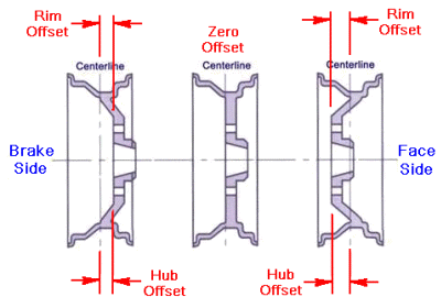

Let the automotive world evolve another 40 or 50 years and we have more front drive cars than rear drive cars. These days it is more common to see small cars and cars with front drive and independent rear suspension or all-wheel drive. Now it is less common to see zero offset, and generally uncommon to see wheels going the other direction. As such, people wishing to ignore the reference to positive or negative will usually be comparing offset of one dished wheel to another dished wheel, and going the other direction is rare and uncommon, so they would call that "negative". Now to justify the new view of which direction is positive or negative they switch to referring to the direction of hub offset rather than the rim. Positive offset is still outboard, but now they are referring to the hub offset rather than the rim offset (very convenient).
Not confused enough yet? Another way of measuring wheels is to refer to "backset". Backset is the distance from the inboard rim edge to the bolt-on mounting surface of the hub. Lay a straight edge across the inner rim and measure to the mounting surface, and you get backset as a direct measurement. Measuring across the full width of the rim gives you "rim width". Measuring in between the tire bead mount surfaces gives a consistent measurement of what is ALWAYS referred to as "wheel width". You can easily convert measured overall width and backset measurements to offset dimension by the formula B-(W/2). Rim edge design makes no difference, as W/2 is always the centerline of the rim regardless. The result may be positive or negative depending on wheel shape.
Once you understand how all this works there is no confusion at all about offset, only whether people refer to it as positive or negative. This is why anyone referring to these dimensions as positive or negative will always have to explain which direction they are calling positive. This is one issue that may never be consolidated to one standard in the "political" world. However, by now most wheel suppliers have settled fairly consistently on the newer point of view and refer to outset hubs and inset rims as "Positive Offset". So here is the new diagram with the modern terminology.
