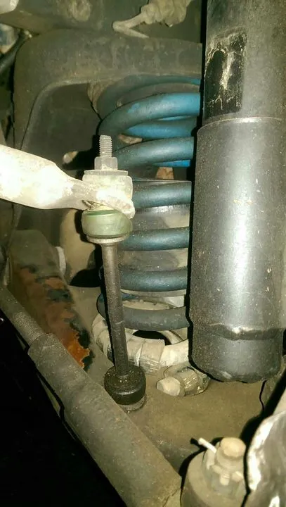

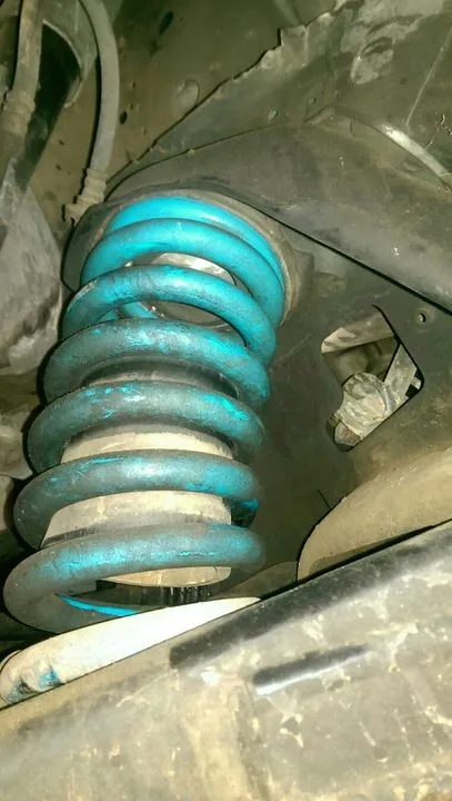

I cant tell from your pic but there are 2 small holes in the spring pocket in the lower control arms, the pigtail of the spring should cover the first hole but not the second hole, hope this helps you out.

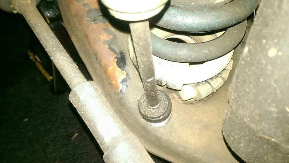

The springs look fine. I usually run the isolator down closer to the end of the spring, but that's not a problem. Swaybar end link looks a little loose up top. When the suspension is loaded, the bar might have some play between the bushings.

So I have taken the calpiper apart and inspected them all seems fine, I'm leaning towards that I need to replace the sway bar bushings, and shocks. The car currently has the stock bushings it looks like and crappy sense a Trac shocks.

The kyb replacement struts should work fine for you. As the others have said, the springs appear to be installed correctly. If you are going to replace your sway bar end links, I prefer the kit from energy suspension over the stock replacements at the parts house.
I'm referring to the pipe between the h pipe and muffler. My passenger side is stock and looks like it had buck shot go through it. I would liike a set that would clamp to the muffler (flowmasters). The end links on the sway bar look newer, but since it's apart and will be for a bit I might as well replace them.
