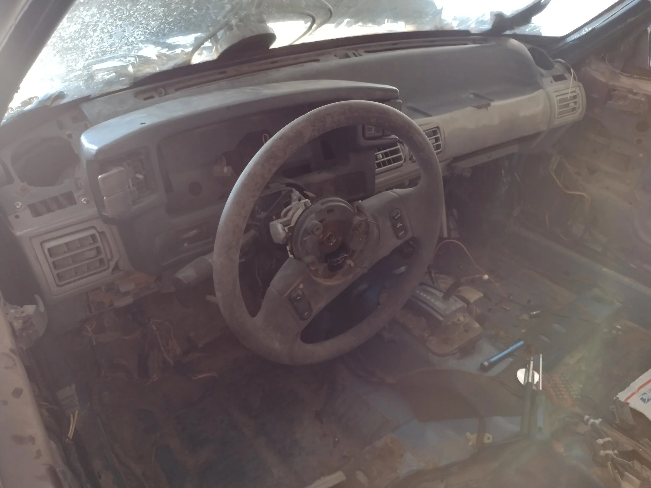

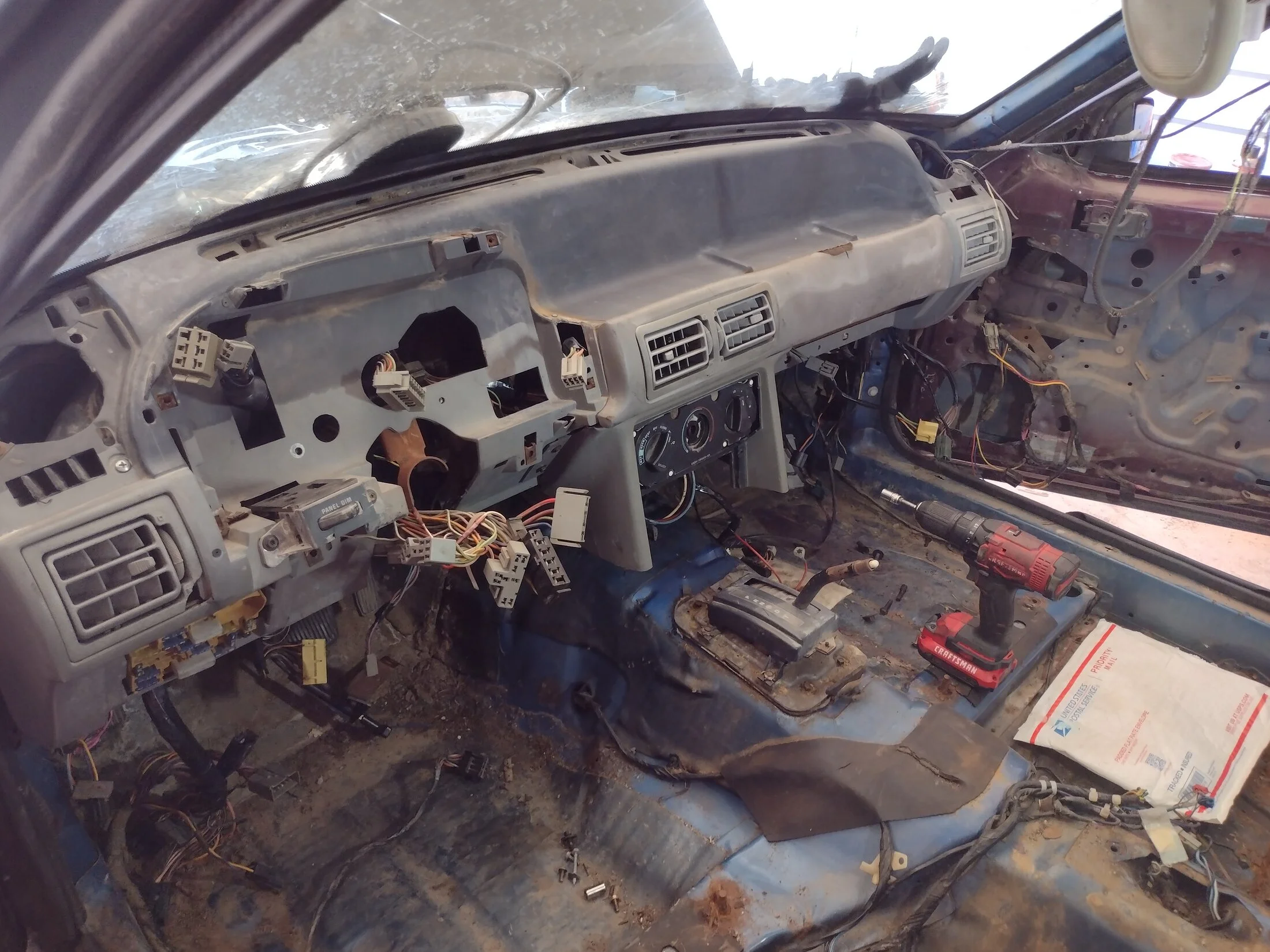

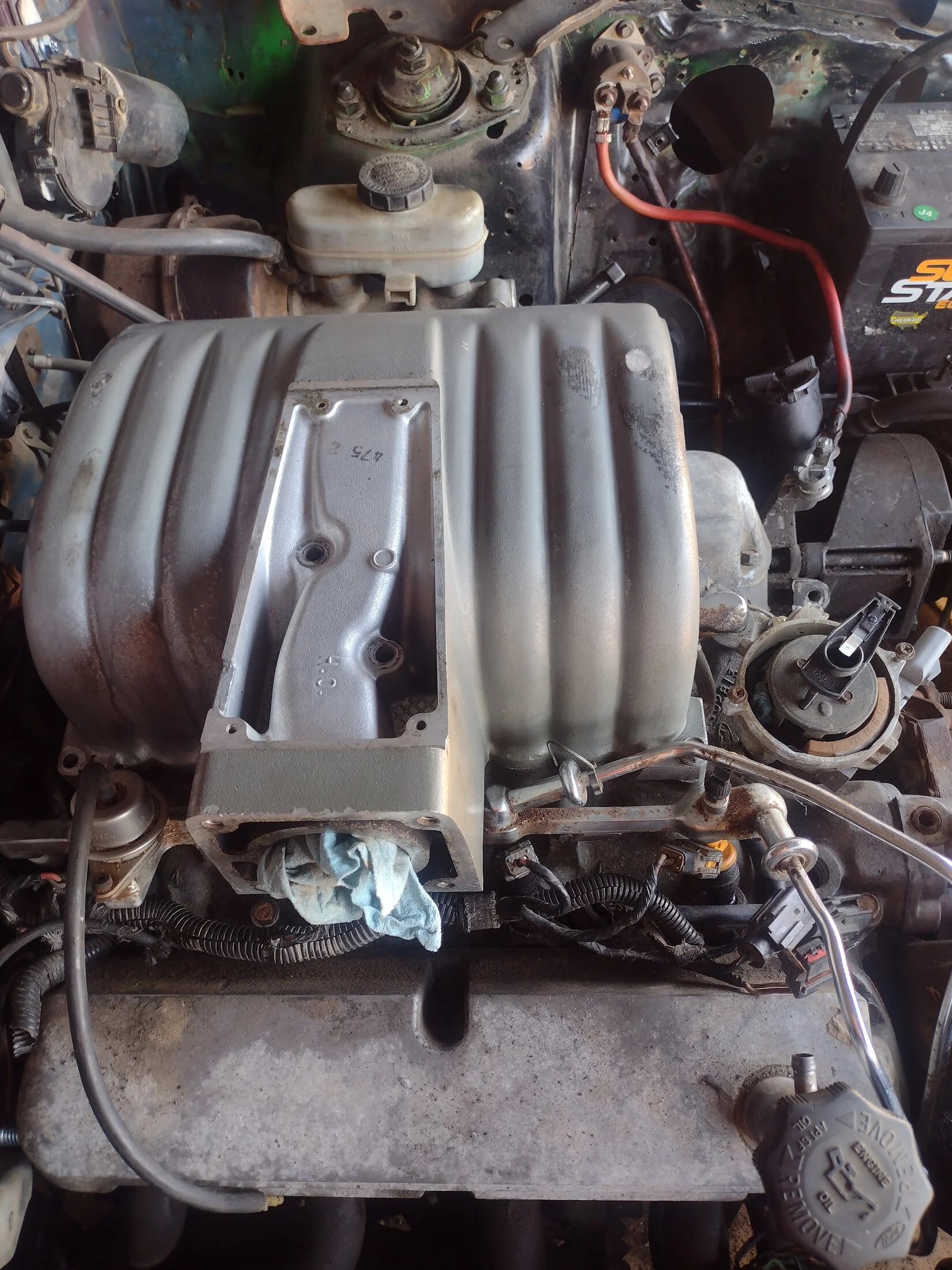

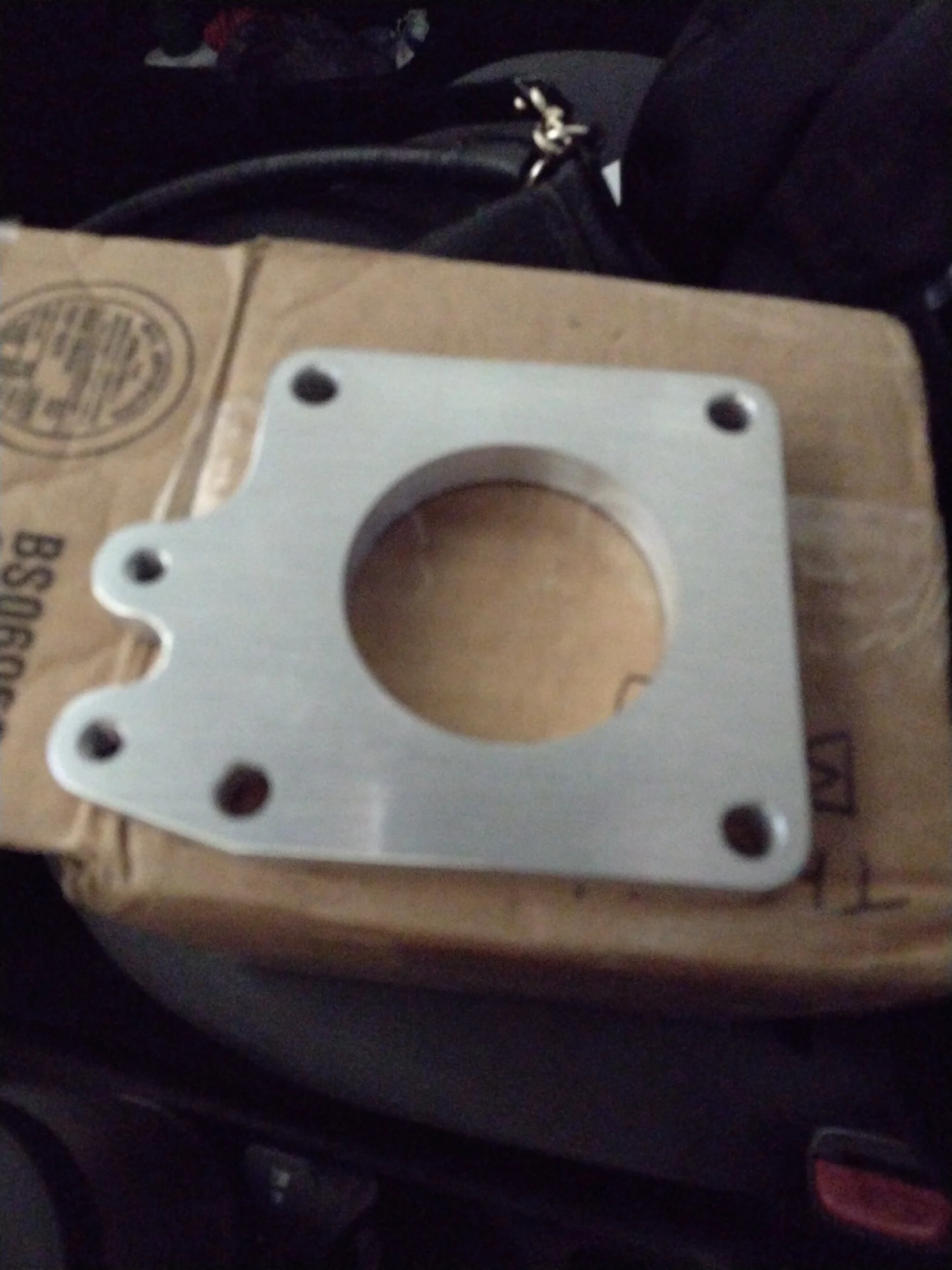

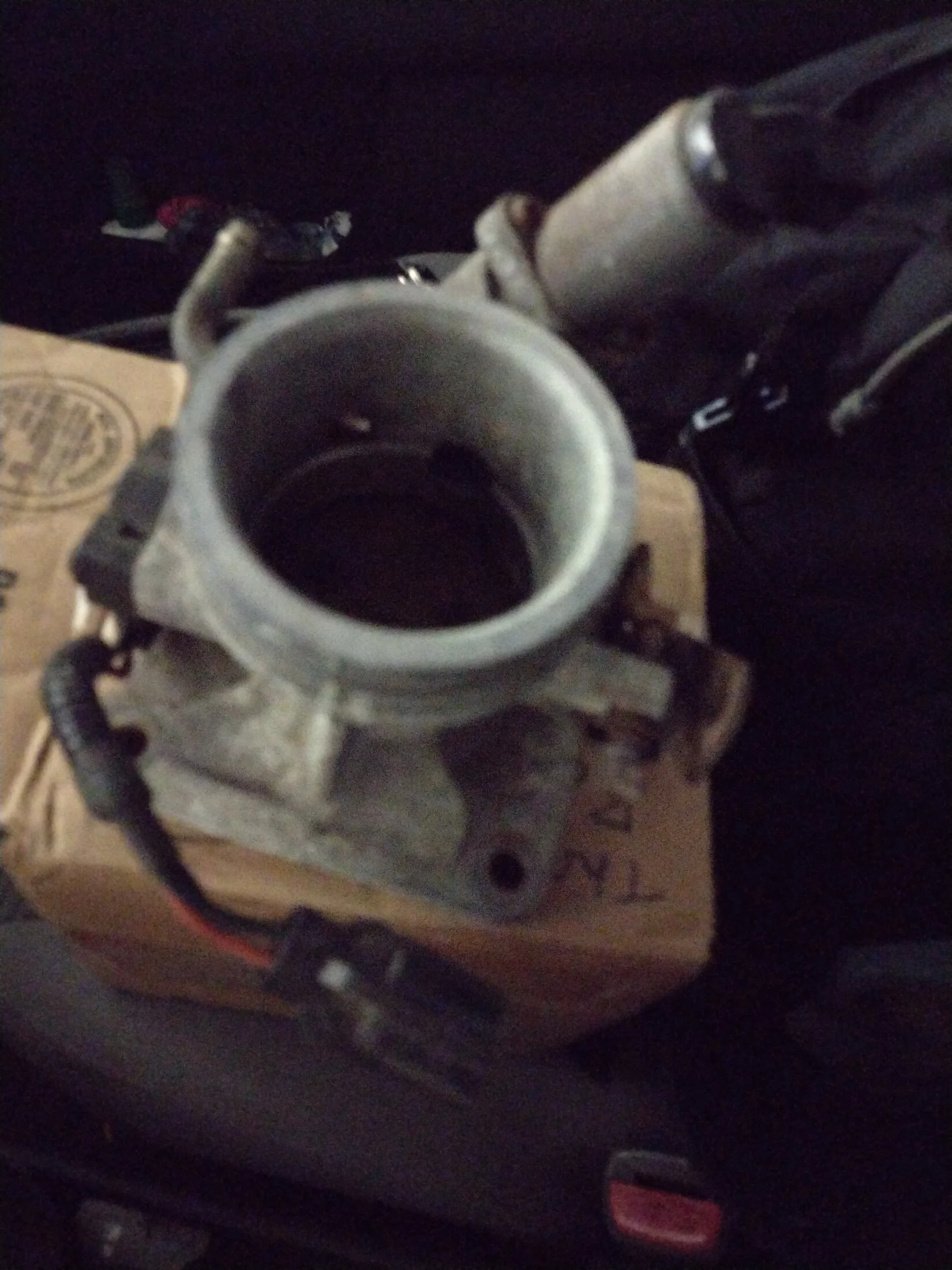

So i got the intake put on and got a factory throttle body and spacer. I finally got the dash and column back in. So far everything electrical works.
The wipers work if i jump the connector but no continuity through the switch.
I'll take that apart and see what's going on . Probably corrosion but the turn signals and dimmer works. I can usually get switches working by cleaning the contacts. I hate buying something i can fix.
Anyway the wiper motor sounds pretty sick so I'll try to refurbish that too.
The head light switch works but the top cover is broken off so it won't snap into the panel.

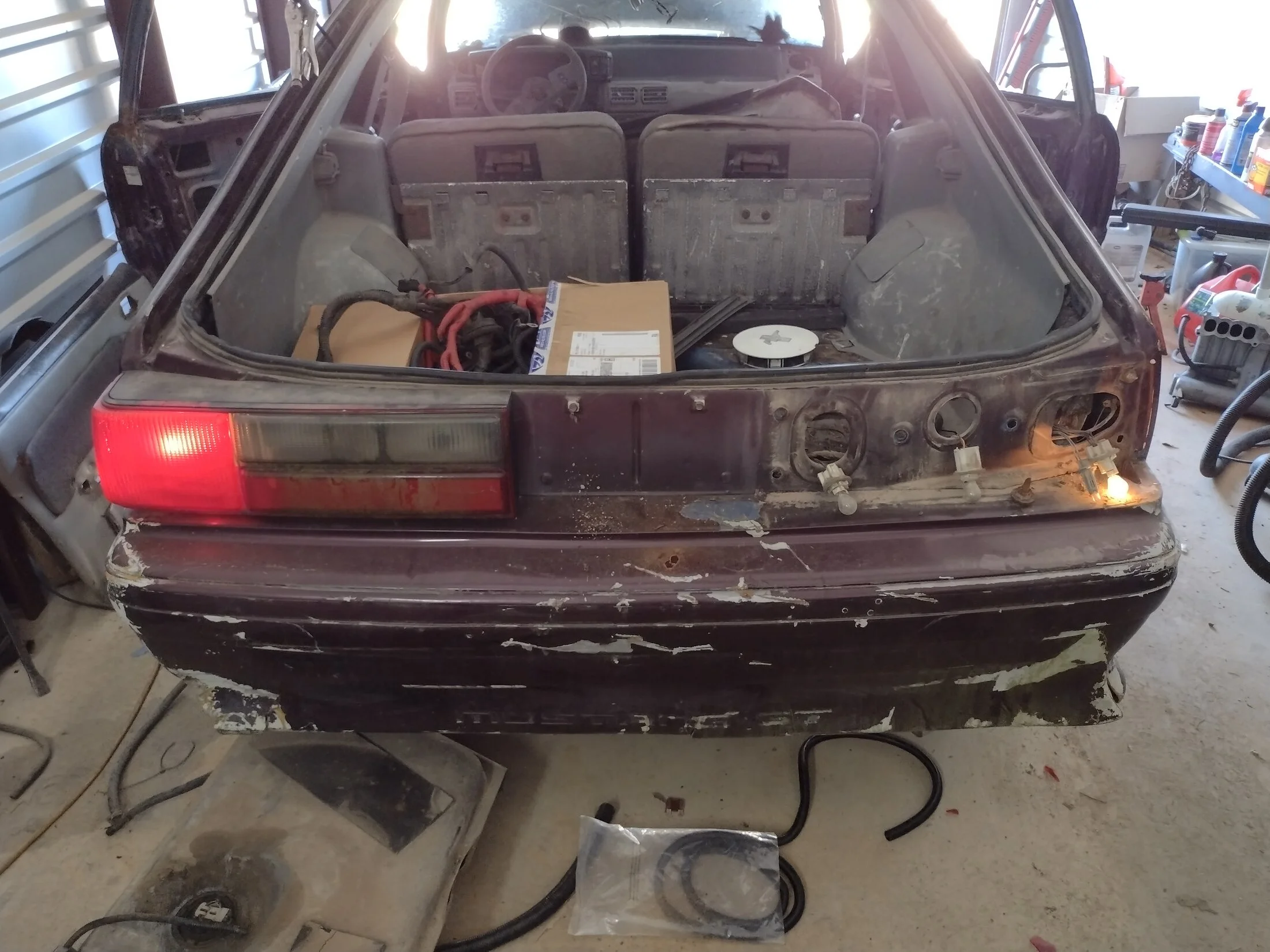

Surprisingly all exterior and interior lights worked with only a couple of bad bulbs.

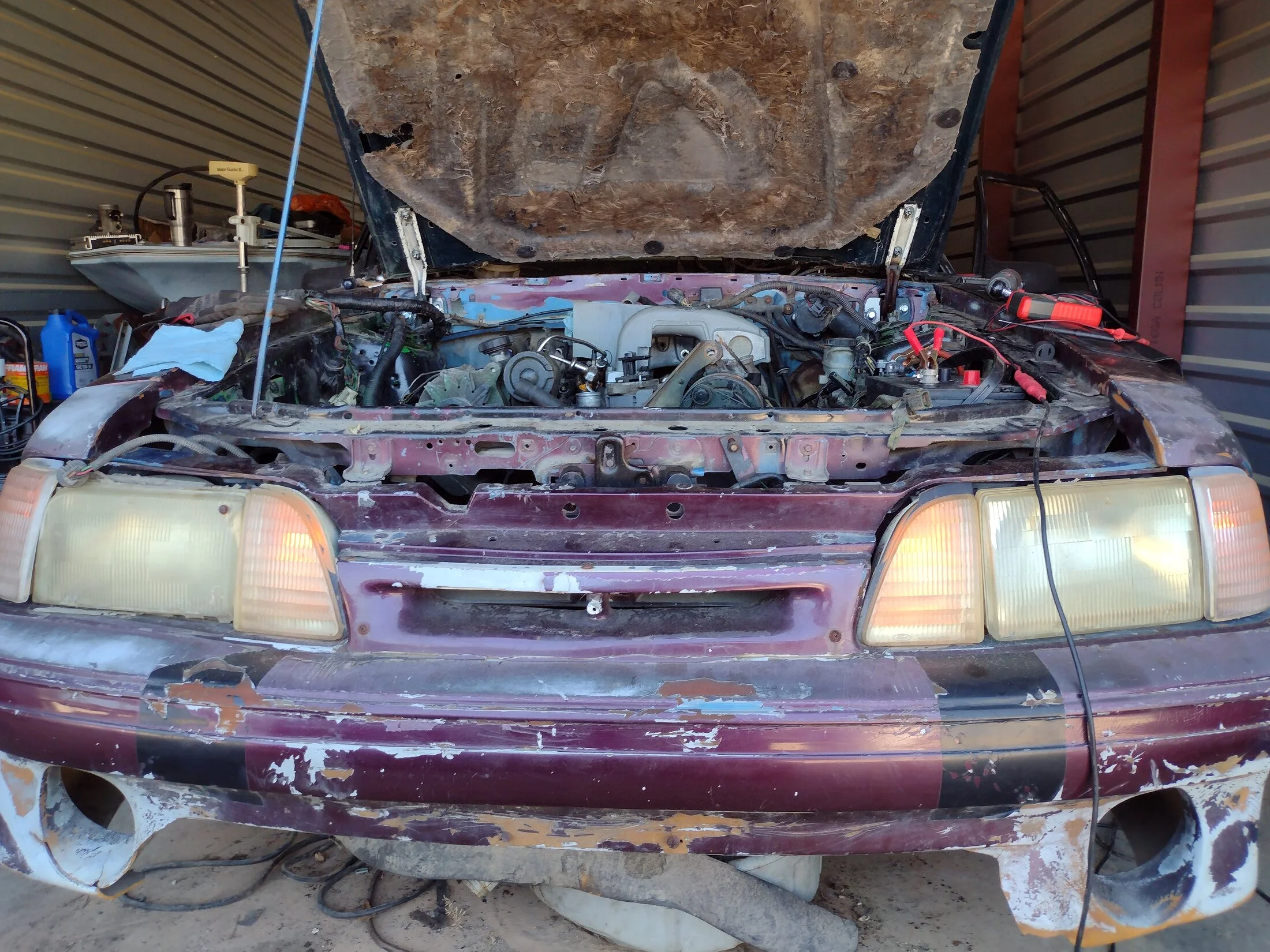

The headlight housings are pretty bad so they'll get replaced. I replaced the passenger taillight lens and will replace the drivers side next week.
When i first turned on the ignition switch i didn't realize the blower switch was on high so it squealed for a second and went full blast blowing lots of crap out of the vents.
Power mirrors even work. I have to replace some connectors on the engine harness but I should have it running next week.

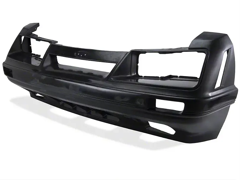

Yep. The center on the air dam is cut out I've seen that on other cars. It seems that drag racers do that to reduce drag. By the way that nose doesn't even belong there. It's the 93 style with the small grill opening. Mines a 89' I'm still waiting for a nose to be in stock at rock auto seems to be the best price on a new one but id consider a used one but none locally to me.

I need to replace the starter cable. It's getting pretty hot and the motor isn't turning as fast as it should but it's fast enough. Maf isn't connected, nor iat, o2 and all vacuum lines are plugged right now. No belt and no cooling system installed.
Well i couldn't wait. She turned over a couple seconds and then , Vrooooom She's alive ha ha haha
